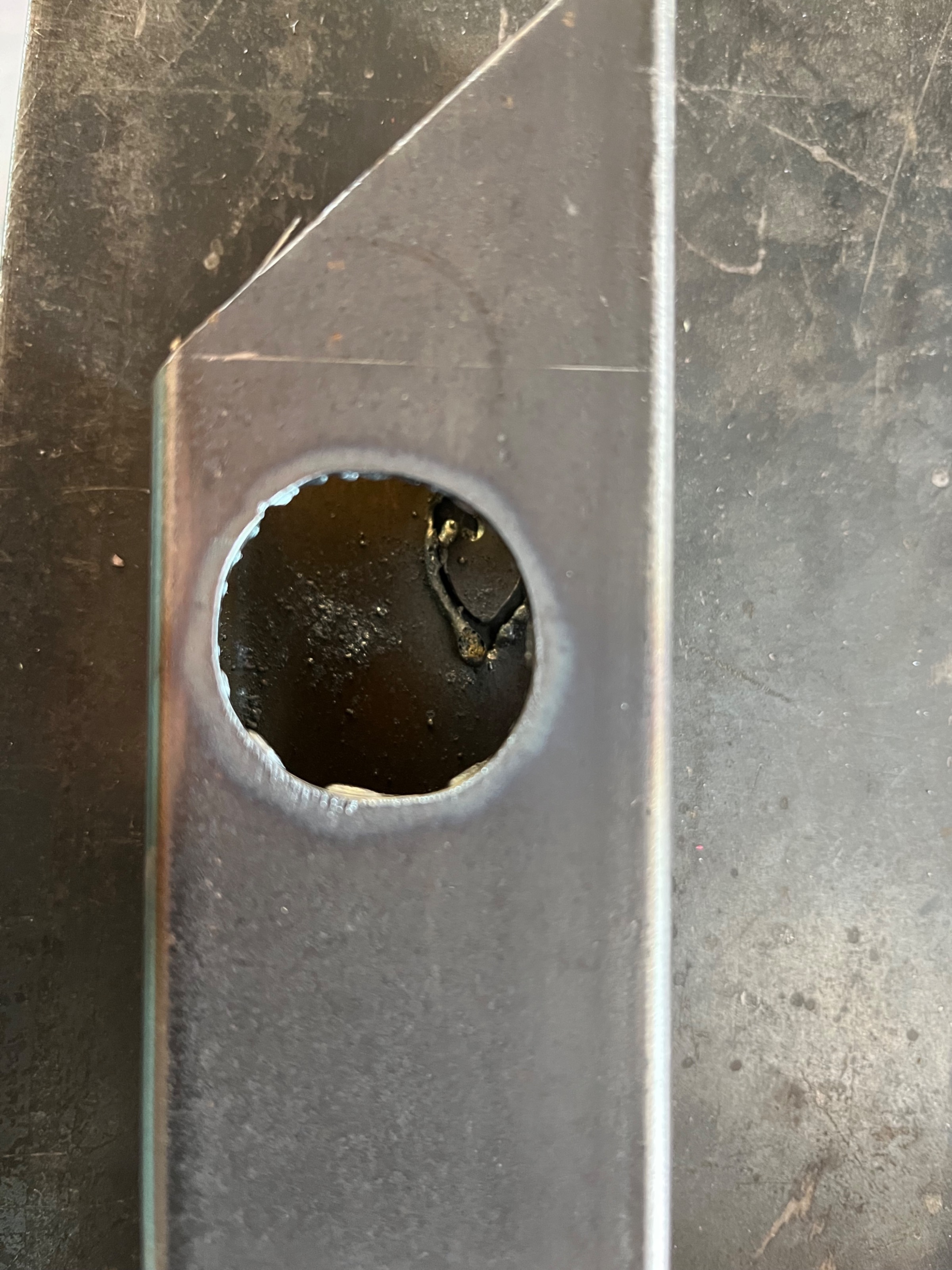

Replied by tommylight on topic Building a chain driven Plasma table.
No drag shield.
Looks like to slow and a bit to high.
You will have to do a lot of test cuts to find out what works for you, so do straight 100mm cuts first while changing cut voltage (that is torch height) and feed rate (can be adjusted on screen while cutting), but first and foremost, use new consumables and make sure the air pressure is as specified in the manual while the torch air is on.
After you get clean cuts with little dross on straight lines, do some small squares and some small rounds, about 50 of each. If that all works OK without issues, cut some bigger logo or whatever you like.
The following user(s) said Thank You: Creative25

07 Sep 2024 14:42 #309575
by Creative25
Replied by Creative25 on topic Building a chain driven Plasma table.
Thanks.
I just used conversational in qtplasmac.
I tried to increase cutting speed.
But it always cuts the same slow speed.
I downloaded sheetcam unfortunately it already asks for a
License key.
Is there any free software to generate G code for plasma?
License key.

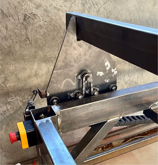

08 Sep 2024 05:27 #309630
by Creative25
Thanks for the info.
I already have Inkscape on my computer..
Did not know it works for generating code for plasma.
I have tried it without success .
After some searches on the internet I found some tutorials to create Gcode for routers.
Where can I find some tutorial for generating Gcode for plasma?
So now I have another question.
I still have to make a water table.
The machines Frame is 1.8 x is 3.3 meters.
I am planning to put a rotational axle for round pipes. Max diameter for pipes about 250mm
Maximum sheet size I am planning is 1250 mm x 2450 mm.
How big would you make the water table.
Is there a benifit of making it larger than the Methal you cut? I am thinking about splashing etc.
What material thickness do you guys use for the water tray? What thickness for the slats?
- Posts: 21995
- Thank you received: 7488
08 Sep 2024 11:36 #309648
I have a short video about Inkscape for plasma, bot sure if it is on toma.cnc1 or toma berisha channel, i have 4 channels on youtube.
Make the table at least 5-10cm bigger on all sides, less splash when cutting at the edges.
2mm is enough for table and slats, i used 3mm it proved to much and quite un-necessary.
