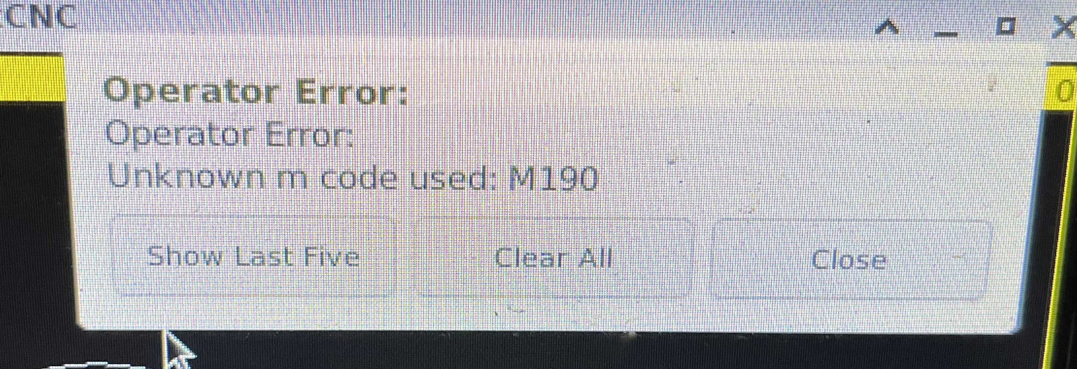

29 Jan 2025 11:28 #320073
by Creative25
Replied by Creative25 on topic Building a chain driven Plasma table.
So after reinstalling Linuxcnc and Upgrading to linuxcnc 2.9.4 I copied the linuxcnc folder from a backup. Then I configured the network manually and the machine is running.
However if I try to cut anything from conversational I get the following error.
If I delete the line containing the line with M190 I can cut without error.
Did I miss something during reinstalllation?

30 Jan 2025 19:59 #320174
by Creative25
I made a new configuration based on the current one and saved it under a different name. On the new one there was no error message.
So in the current configuration I replaced the file called M190 with the new one now everything works.

30 Jan 2025 20:07 #320175
by Creative25
I just wonder did the M190 file change between version 2.9.2 and 2.9.4 ?
