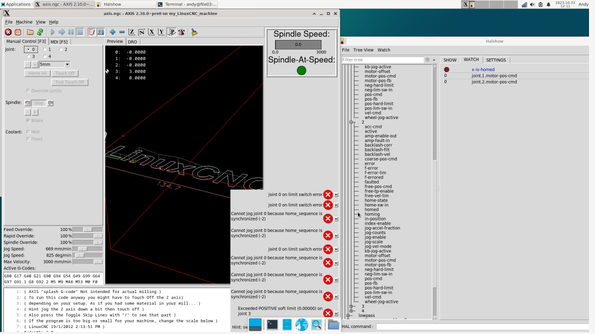

31 Oct 2023 17:26 #284201
by gardenweazel
Replied by gardenweazel on topic Tandem Y Axis not working on 7i76E
- Posts: 18111

31 Oct 2023 17:33 - 31 Oct 2023 21:07 #284202
Replied by PCW on topic Tandem Y Axis not working on 7i76E
For testing I think it would be better to eliminate the simultaneous homing of X and Y,Y2
say homing d sequence:
-1 for Y, Y2
2 for X
3 for Z
4 for A
And solve the X on home switch issue
-1 for Y, Y2
2 for X
3 for Z
4 for A

31 Oct 2023 20:19 - 31 Oct 2023 20:30 #284209
Replied by tommylight on topic Tandem Y Axis not working on 7i76E
You have X and Y axis set as 2 and -2, that is the same thing so it will try to home both at the same time, subsequently requires moving 3 joints. Probably this causes issues, but has to be confirmed.
In general, homing sequence is
0 for Z axis so it moves up as not to hit stuff when homing other axis
Other axis can be set at will, but when using tandem axis a - sign must be added, so
1 for X axis
-2 for tandem Y axis, both joints
3 for A axis
So just change X axis to 1 in home sequence and try again.
-Edit
you can have the same number for any and all axis in home sequence, so you can have all joints/axis set at 0, or 1, or 2, does not matter and LinuxCNC will happily home all at the same time, just the tandem axis/joint will probably not like that so homing only tandem joints should be used, or in your case, you can have all but Y axis set to 0 or 1 or 2 just not the same as tandem axis.
The numbering is very easy to follow, 0,1,2,3 etc, except tandem axis gets a - in front, so to have a standard XYYZA machine home, 1,-2,-2,0,3
standard XXYZ -1,-1,2,0 or -2,-2,1,0 will work.
1 for X axis
3 for A axis

31 Oct 2023 21:51 #284223
by gardenweazel
Okay doing much better now!
I changed my ini file as suggested by @PCW. Movement of "Y" and "Y2" worked with only one exception, "Y2" decided
to not stop at the sensor. Mashed the E-Stop button and all is well.
Next, I'll do a diff on the files that @djdelorie attached and see if I can correct.
Thanks again for the feedback!

31 Oct 2023 22:07 #284224
If one of the joints did not stop, change the direction of home_latch_velocity for that joint by adding or removing -
Might also need to do the same for home_final_velocity
