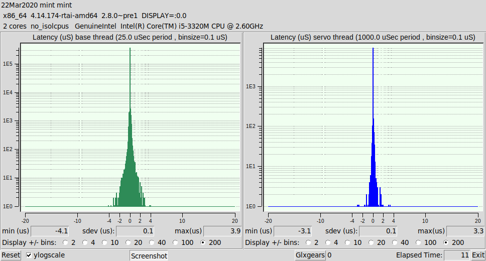

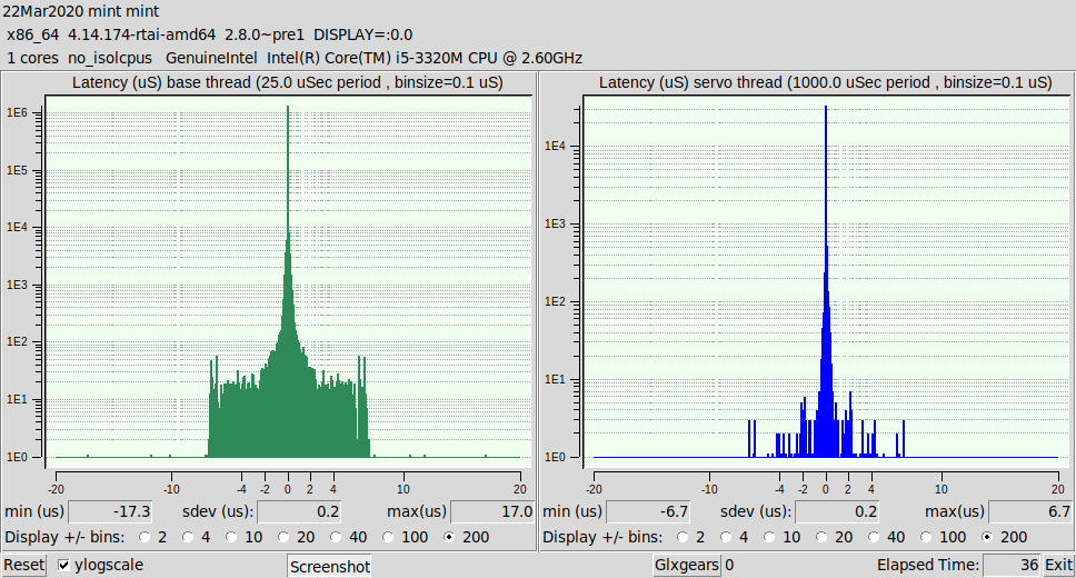

I think I may have a config problem, all my own fault, just need a little help, as I'm trying to help out another forum member when booting via UEFI as their board does not support legacy nor have a CSM option for booting.
OS: Linux Mint 19.2 XFCE .
Custom image created using my usual process.
Machine Lenovo T530 12GB RAM, Intel(R) Core(TM) i5-3320M CPU @ 2.60GHz
Graphics set to on board Intel only
Booted via USB.
Legacy Only boot both cores started
UEFI only boot only one core started.
Screenshot when booted via UEFI no CSM.
Screen when boot via legacy.
Booted via USB.
Last edit: 21 Mar 2020 21:01 by BeagleBrainz. Reason: Added legacy info

Why do you think that you have a config problem?
What do you mean by:
RTAI is not meant to run with EFI. You are going to have lower latency with legacy BIOS.
Last edit: 21 Mar 2020 21:04 by Bari. Reason: added EFI info

21 Mar 2020 21:58 #161057
by BeagleBrainz
I have no issues with the work & time & effort put in and very much appreciate this.
If you have a look at the 2 images shown one has 2 cores (legacy) and one only has 1 core (uefi).
Apart from only initialising one core I haven't seen any issues whilst running a desktop, apart from only working with a single core.
What is the mechanism the prevents the rtai kernel from initialising 2 cores or more when booting from UEFI ?
I've seen some notes floating around regarding the .efi files not being in the correct place, but checking the image that is on the USB stick everything appears to be in place.
Could this be an issue for users that have a modern MB, such as those with Gemini Lake or later, as Intel has decreed from on High that UEFI boot is the only option, as intel wants legacy boot a thing of the past by 2020 will this be something that will be discussed in these forums later during the year ? This is the situation facing fellow forum member cncbeagle. Or is it a case of tough luck you have to use RT_PREEMPT ?
That's why I was asking for a working config, even with the new git I still had to enable support for the Intel GPUs.
