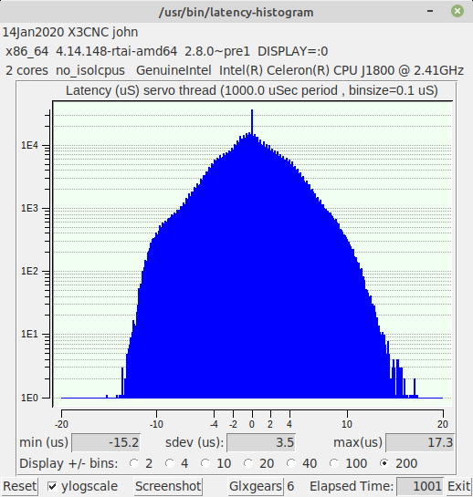

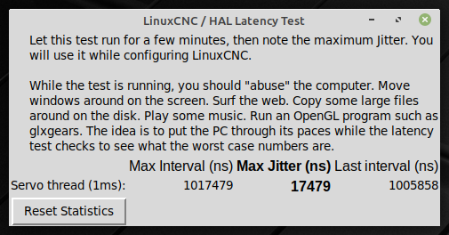

Success! I solved my .ICEAuthorty and slow boot issue. I now have Linux Mint 19.2. using the RTAI 4.14.148-rtai-amd64 kernel
For RTAI Kernel and LinuxCNC 2.8.0-Pre1 I used the .deb files from www.linuxcnc.org/temp
Linux X3CNC 4.14.148-rtai-amd64 #2 SMP PREEMPT Sat Nov 9 16:29:10 GMT 2019 x86_64 x86_64 x86_64 GNU/Linux
This is running on a ECS BAT-I(1.2)/J1800 Intel Celeron J1800 2.41 GHz Mini ITX Motherboard / CPU / VGA Combo w/ 4gb ram and a SanDisk 240gb SSD.
At this point I have the machine moving under 2.8.0~Pre1. When I get my pendant back from repair in 2 weeks I will be able do some full usage testing. While waiting for that I can get my secondary high-speed spindle setup under 2.8.
These are with 6 glxgears and 2 youtube videos running.
Is there anything in particular I should try when testing?
Thanks to all who helped me over the hurdles.

Just to see the difference: what were the values whn running RT_PREEMPT on the same board?

I would have to look for the exact numbers but I think it was more that 120,000. I using a Mesa 5i25+7i76.
