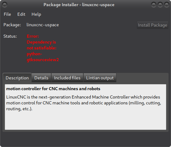

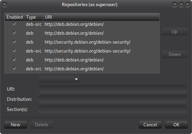

11 Jan 2020 15:59 #154624
by JohnnyCNC
I looked in Menu>Administration and I don't see that option. The closest thing I could find is this.
I am getting this error and I could find this/these in Synaptic.
I also saw this when debuild -uc -us finished running.
W: linuxcnc-uspace: executable-not-elf-or-script usr/share/linuxcnc/ncfiles/lathe/turning.ngc
W: linuxcnc-uspace: executable-not-elf-or-script usr/share/doc/linuxcnc/examples/sample-configs/sim/gmoccapy/lathe_configs/boring.ngc
W: linuxcnc-uspace: executable-not-elf-or-script usr/share/doc/linuxcnc/examples/sample-configs/nc_files/lathe/facing.ngc
W: linuxcnc-uspace: executable-not-elf-or-script usr/share/linuxcnc/ncfiles/lathe/chamfer.ngc
W: linuxcnc-uspace: executable-not-elf-or-script usr/share/doc/linuxcnc/examples/sample-configs/nc_files/lathe/radius.ngc
W: linuxcnc-uspace: dev-pkg-without-shlib-symlink usr/lib/libpyplugin.so.0 usr/lib/libpyplugin.so
W: linuxcnc-uspace: init.d-script-does-not-source-init-functions etc/init.d/realtime
W: linuxcnc-uspace: udev-rule-missing-subsystem lib/udev/rules.d/99-xhc.rules:2 vendor/product matching missing SUBSYSTEM specifier
W: linuxcnc-uspace-dev: syntax-error-in-debian-changelog line 8 "found start of entry where expected more change data or trailer"
W: linuxcnc-uspace-dev: priority-extra-is-replaced-by-priority-optional
W: linuxcnc-uspace-dev: manpage-has-errors-from-man usr/share/man/man3/hal_stream.3hal.gz 51: warning: macro 'They' not defined
Finished running lintian.
I was following the instructions for "Debian 10 LinuxCNC" at www.gnipsel.com/linuxcnc/uspace/debian10-emc.html
I may try Linux Mint 19.1 using a spare SSD I have and see how that goes.
Replied by JohnnyCNC on topic Testers Needed for New RTAI Packages
You have to enable "source code" repositories in the "software sources" from the main menu>administration.I did not successfully install 28. I got a bunch of dependency issues.
sudo dpkg --install linuxcnc_2.8.0.pre1.4891.gadf1eff73_amd64.deb
