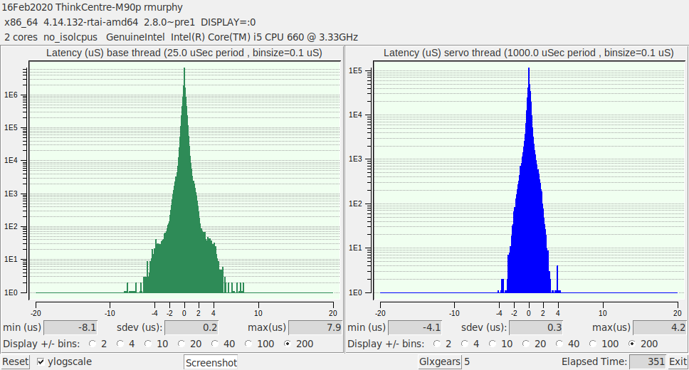

Update 16-02-2020 09:59
RTAI currently installed and running on the ThinkCentre M90P, apart from the display being at 1024x768 all seems ok, actually using this system to write this edit.
Last edit: 15 Feb 2020 23:02 by BeagleBrainz.
