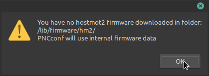

python-gtksourceview2_2.10.1-3_amd64.deb is no longer in sid
bugs.debian.org/cgi-bin/bugreport.cgi?bug=947854
Added :
deb ftp.us.debian.org/debian/ stretch main non-free contrib
to /etc/apt/sources.list and did:
$ apt-get install -t stretch python-gtksourceview2
Not finding where the hostmot2 debian package is? - appears to need a special source?
Best would be if someone can post the contents of sources.list of the ISO for me?
How different is 2.8 from 2.9? (for someone running mesa )

Replied by tommylight on topic LinuxCNC on Debian 10 Buster quick and easy install
It works
Hostmot2 firmware can be downloaded form the www.Mesanet.com website for their cards, but it is not needed for most of the cards as they have it in a flash memory, but they are needed if there is a need to change the existing internal configuration of those cards.
