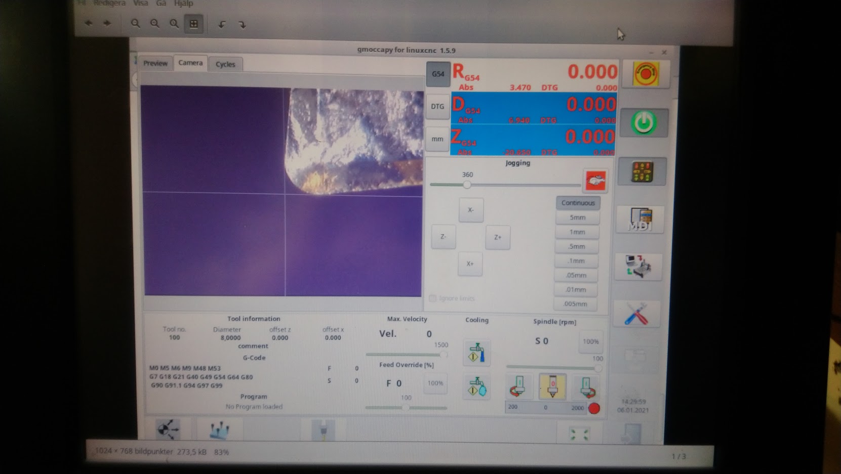

Hi Tecno,
You are not giving the proper camera name in the commands. The default names will work for your first camera:But I am wondering why you want to use mpv if mplayer works for you. Mpv is the recplacement for mplayer in the latest Debian release.
I am pretty sure if you change the mpv command to:it will work.
So it;s a case of using the proper camera name. You can get a list of all the video capable hardware if you do aYou can also find the proper name if you do awith unplugged camera and then plugin the camera and do another. Your camera will be the last hardware in the second list (or in the difference between the first and second dmesg).
For your information, these are pure cosmetic:adds a rectangle on the camera image in such a way that only the ' inner' lines show up.same
The purpose of the rectangles (that form a cross on the image) is to have some crosshairs to better positon the spindle. The location of the crosshairs can be manipulated with the parameters in case your camera has an offset to the spindle axis.makes the cameraview in the tab in gmoccapy display without an ugly border.
There are many more command line parameters you can pass to mpv,Hope this helps.
EMBED_TAB_NAME = Camera
#EMBED_TAB_COMMAND = mpv /dev/video0 --wid {XID} --vf-add=drawbox=-1:2:-1:240:t=1 --vf-add=drawbox=2:-1:320:-1:t=1 --no-border
EMBED_TAB_COMMAND = mplayer -wid {XID} tv:// -vf rectangle=-1:2:-1:240,rectangle=2:-1:320:-1
It works with MPLAYER. Have to do some tweaking as picture is way too dark.
/dev/video0I am pretty sure if you change the mpv command to:
mpv tv:// --wid {XID} --vf-add=drawbox=-1:2:-1:240:t=1 --vf-add=drawbox=2:-1:320:-1:t=1 --no-borderSo it;s a case of using the proper camera name. You can get a list of all the video capable hardware if you do a
sudo ls -la /dev/video*dmesgdmesgFor your information, these are pure cosmetic:
--vf-add=drawbox=-1:2:-1:240:t=1--vf-add=drawbox=2:-1:320:-1:t=1The purpose of the rectangles (that form a cross on the image) is to have some crosshairs to better positon the spindle. The location of the crosshairs can be manipulated with the parameters in case your camera has an offset to the spindle axis.
--no-borderThere are many more command line parameters you can pass to mpv,
https://mpv.io/manual/stable/
Last edit: 03 Jan 2021 06:07 by ikkuh.

Thanks for pointing me to a solution
EMBED_TAB_COMMAND = mpv av://v4l2:/dev/video0 --wid {XID} tv:// --vf-add=drawbox=-1:2:-1:240:t=1 --vf-add=drawbox=2:-1:320:-1:t=1 --no-border
Now that I have mpv working I still need to fix brightness.
Why mpv = it is the latest so why learn something tha will be gone after a while

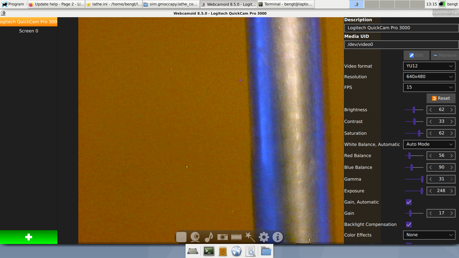

Found a working workaround !
Open webcamoid = set all wanted values and you are good to go.

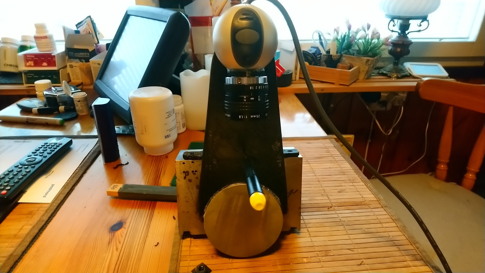

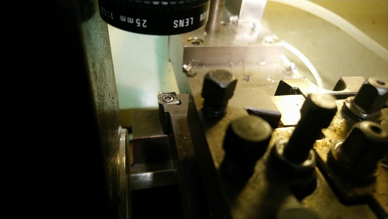

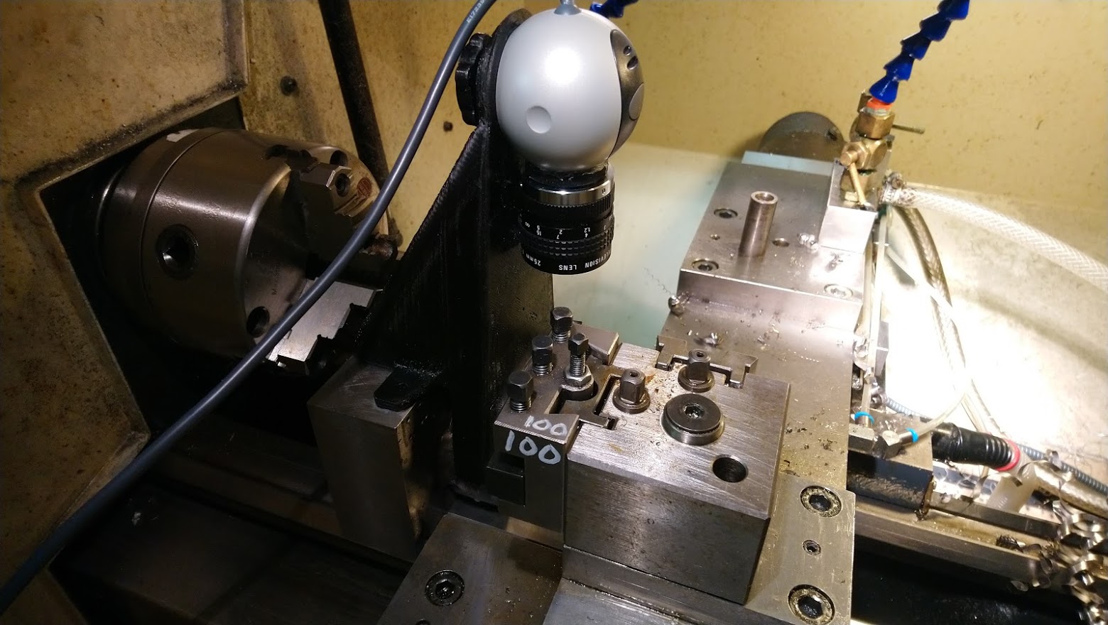

Here is a video of my setup, nas.cnckloon.nl/s/bey5zNL7nmmzJ4F
I use very cheap Chinese 'endoscopes'. I always have a few in stock and can change a broken one after a collesion for a new one.
www.aliexpress.com/item/4001271665816.ht...02_,searchweb201603_
Replied by ikkuh on topic Update help
This is my webcam setup for my lathe.

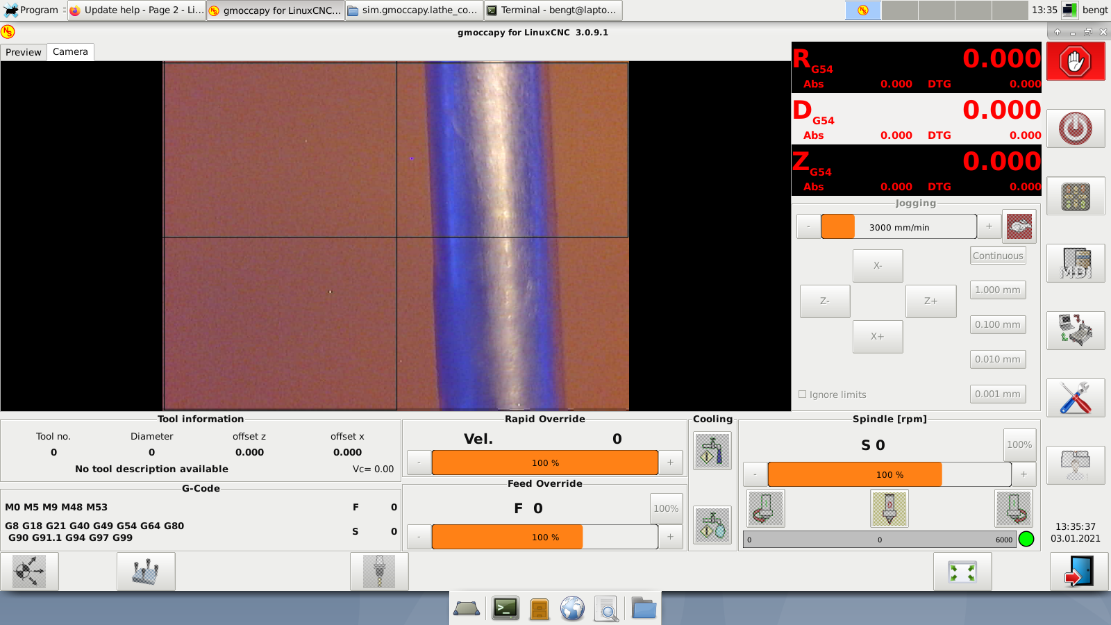

If you remove thestatments your picture will look nicer.
You can also modify the parameters for drawbox such that the line and cross will be useful.
You can test the cam standalone without LinuxCNC, saves you a lot of time (remove the --wid {XID} and adjust the parameters).
in gmoccapy
If you remove the
--vf-add=drawbox=-1:2:-1:240:t=1You can also modify the parameters for drawbox such that the line and cross will be useful.

I will have to play around but it looks quite OK with the crosshair as is.
Thank you ikkuh for helping an old fart like me.
