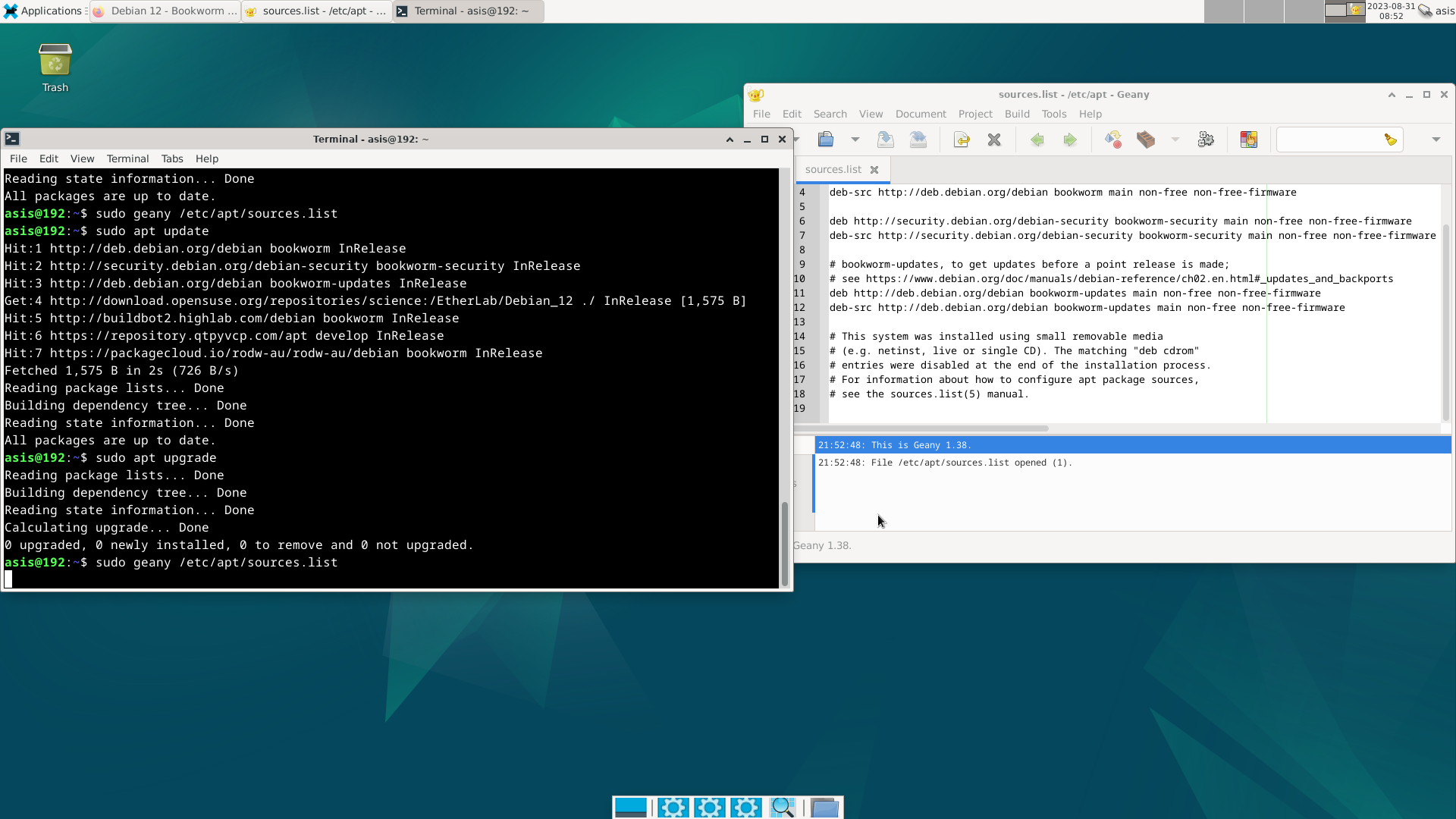

by abdulasis12
I add all done.
Now after sudo apt update show Hit...........Inrelease (total 6 hit)
show Get ....... InRelease (1)
I type
sudo apt upgrade show 0 upgradeed 0 install
any more for action ?
Replied by abdulasis12 on topic Debian 12 - Bookworm Live installer ISO for linuxcnc (x86_64)
Hi, MR.RodwYou do not have internet.
What PC and What network card in your PC.
There was a regression where non-free non-free-firmware
Was not added to /etc/apt/sources.list
Please: sudo geany /etc/apt/sources.list
and add those words in bold to every line that starts with deb, then updada and upgrade
Its possible that you do not have NIC support which is strange.
I add all done.
I type

Replied by rodw on topic Debian 12 - Bookworm Live installer ISO for linuxcnc (x86_64)
That is probably right. The install would have grabbed the lastest version of Debian 12.1. There has been some security updates by Debian but I think they were before I made the installer so there will be no new items from Debian. No errors for the Linuxcnc repo so maybe nothing has been built for a few days.
Debian is fixed for its life after a minor 12.1 bug upgrade. so only Linuxcnc will change with the exception of the occasional security update patching any vulnerabilities.

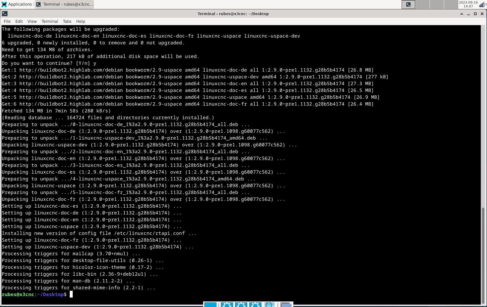

Replied by rubes on topic Debian 12 - Bookworm Live installer ISO for linuxcnc (x86_64)
I had downloaded the ISO file from the first post last week, and got to installing it today. couple minor issues;
when the installer get to the "configure APT" section, I get an error that it can not access a Mirror (I did a screenshot but cant open the file?)Retried several times with no luck. It gives an option to enter a new Mirror, but that is way out of my paygrade.
I ignore that error and it completes everything else.

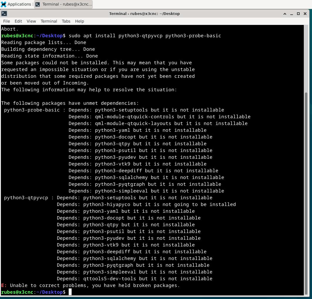

I then tried to install python and probe basic per the instructions in the first post, but get this;
I assume this would be the mirror issue from above?

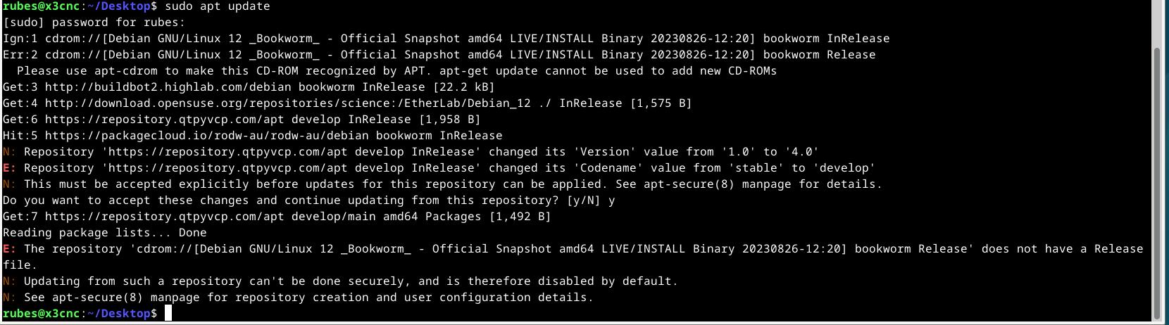

if i do sudo apt update i get another warning that some repositories changed. I can accept the changes and it does something, but again...way above my paygrade;
and finally sudo apt upgrade seems to upgrade to the latest linuxcnc?
I guess I can get python and probe basic by doing it manually, but dont know if there are any other broken packages.
It is entirely possible I screwed up something since I am more machinist than linux geek though.

16 Sep 2023 22:53 #280954
Thanks for the feedback.
It seems the lack of a mirror made the installer look on the USB for packages that were not included in the installer as they are not part of linuxcnc's core.
You should have been asked to pick a mirror from a list during the install
I think I should have told you to do
sudo apt updadte
sudo apt upgrade
As the very first step
Yes its expected that this upgrades linuxcnc to the latest build of linuxcnc by this buildbot buildbot2.highlab.com/
Could you edit sources.list
And comment out with a # any lines that includes dvd or cd and do the update/upgrade process
Also ensure each line starting with deb have non-free non-free-firmware on them as per the screen dump on the last post
then do the update/upgrade step and try again.

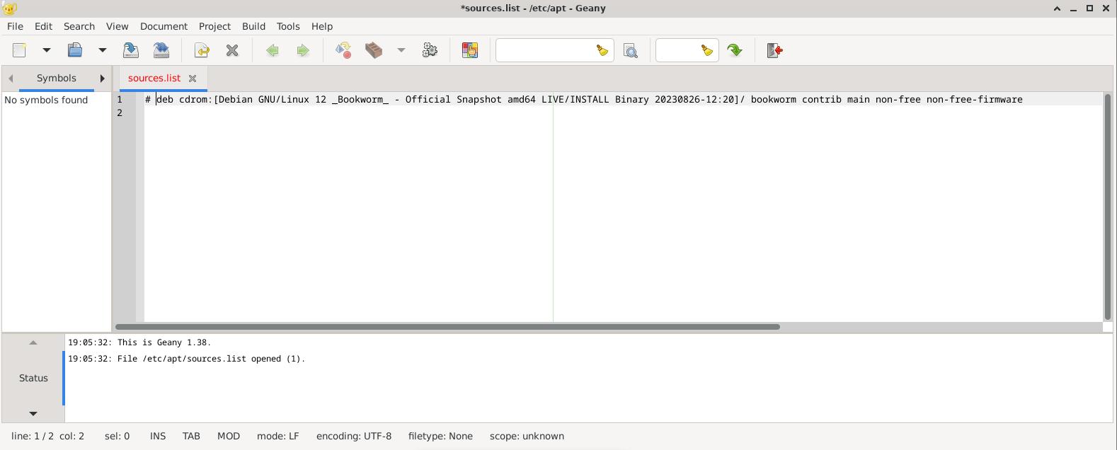

thanx for the reply.
the etc/apt/sources.list file has only one line in it;
I commented it out and reran update it tells me all packages are up to date
and then upgrade also shows 0 upgraded.
presumably because they upgraded during my previous session?
Also, I should have mentioned that I burned the ISO to a DVD rather than a USB since I didnt have a big enough USB handy.
I'll start over and try again tomorrow, but there was no option to select a mirror during the install. after it failed connecting initially, it had an option to select a different mirror, but it was just a blank field and I have no idea how to enter a mirror location.

Something went wrong inthe installer, possibly because you have burnt to a DVD please replace th econtents of sources.list with:
thenThis is the default as shown in the earlier screen dump
Do this and you should be good.
#deb cdrom:[Debian GNU/Linux 12.1.0 _Bookworm_ - Official amd64 NETINST with firmware 20230722-10:48]/ bookworm main non-free-firmware
deb http://deb.debian.org/debian/ bookworm main non-free-firmware non-free
deb-src http://deb.debian.org/debian/ bookworm main non-free-firmware non-free
deb http://security.debian.org/debian-security bookworm-security main non-free-firmware non-free
deb-src http://security.debian.org/debian-security bookworm-security main non-free-firmware non-free
