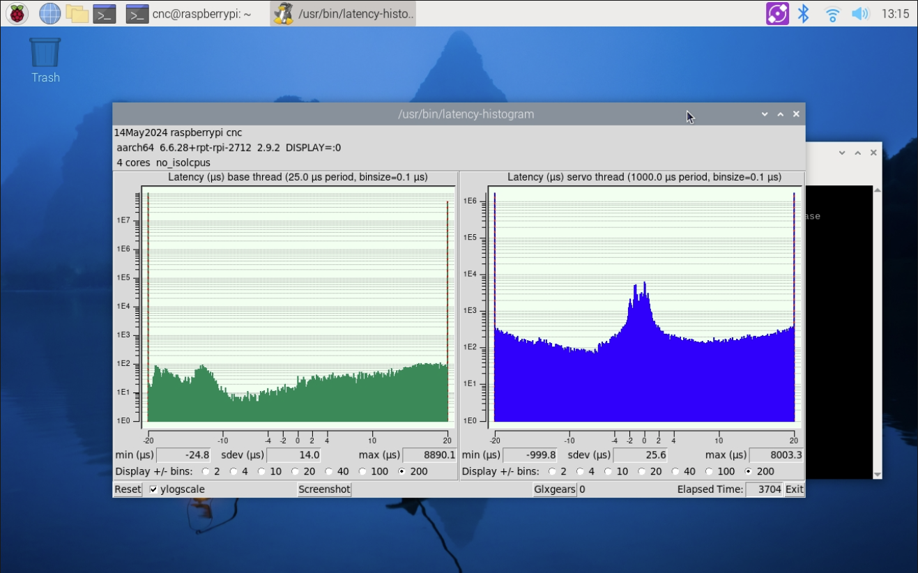

Hello all,
first thanks so much for building this image - it really works nicely (although I still need to get my touchscreen working but assuming this is just a driver issue).
The main question I have before connecintg and configuring a MESA card is that my latency looks decidedly wrong - I am wondering if I have the RT kernel enabled at all? When I make uname -r, I get this, which doesn't mention RT:
6.6.28+rpt-rpi-2712
All I did was load the GDrive image a few posts ago, and run a update && upgrade.
Is there any way to check and correct?

14 May 2024 13:31 #300576
Replied by PCW on topic LinuxCNC on Raspberry Pi 5
Yeah, that's a normal (non-RT) kernel

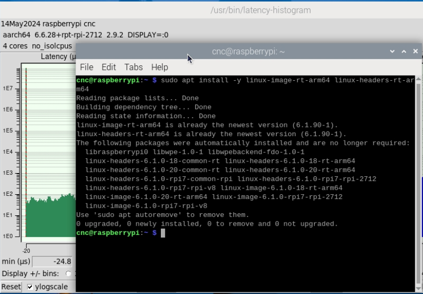

14 May 2024 20:25 #300603
by StoneB
Replied by StoneB on topic LinuxCNC on Raspberry Pi 5
well, that explains that. I found the in an earlier post the command to install the rt kerne (I think), but I do seem to have the RT kernel already installed because a command
sudo apt install -y linux-image-rt-arm64 linux-headers-rt-arm64
returns a "already at newest version".
But I can't seem to figure out from earlier posts what command instructs to use this kernel?
Thanks for your help!

- Posts: 1200
- Thank you received: 426
15 May 2024 04:13 #300640
Blindly running an update is not a good idea.
The easiest way is to reflash the image. The kernel really should have been "pinned" to prevent updates. The RT kernel is a "custom" one.
So you really shouldn't be updating, it's fine as is.

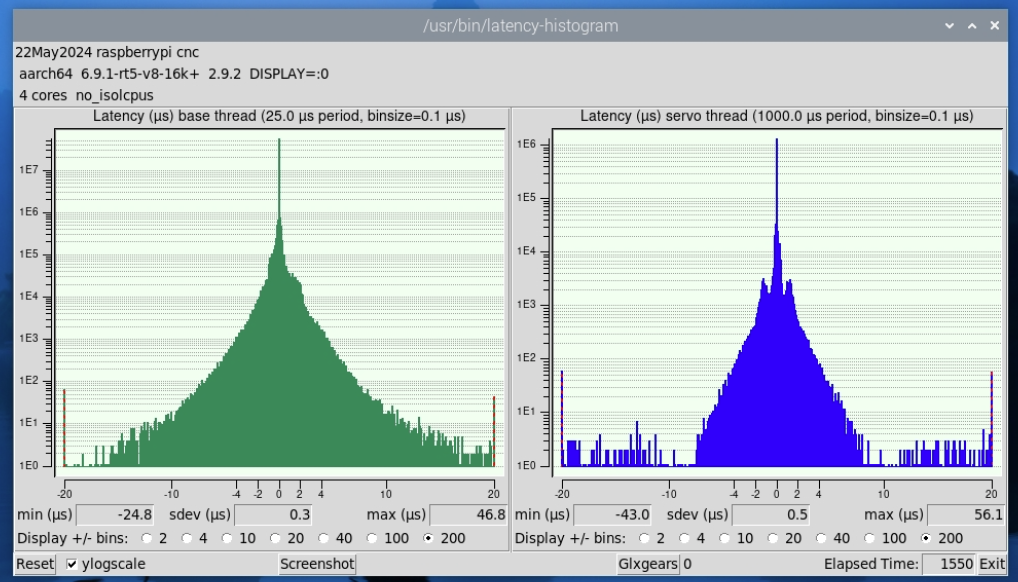

22 May 2024 07:51 - 22 May 2024 15:04 #301139
by StoneB
Thanks for the pointer - updates are disabled
In the meantime, I managed to put a new RT kernel on: looks much better, right?
I followed the github.com/by/RT-Kernel instructions - probably not ideal as you, but I avoided a reinstall (and it's kernel 6.9.1 :D)...

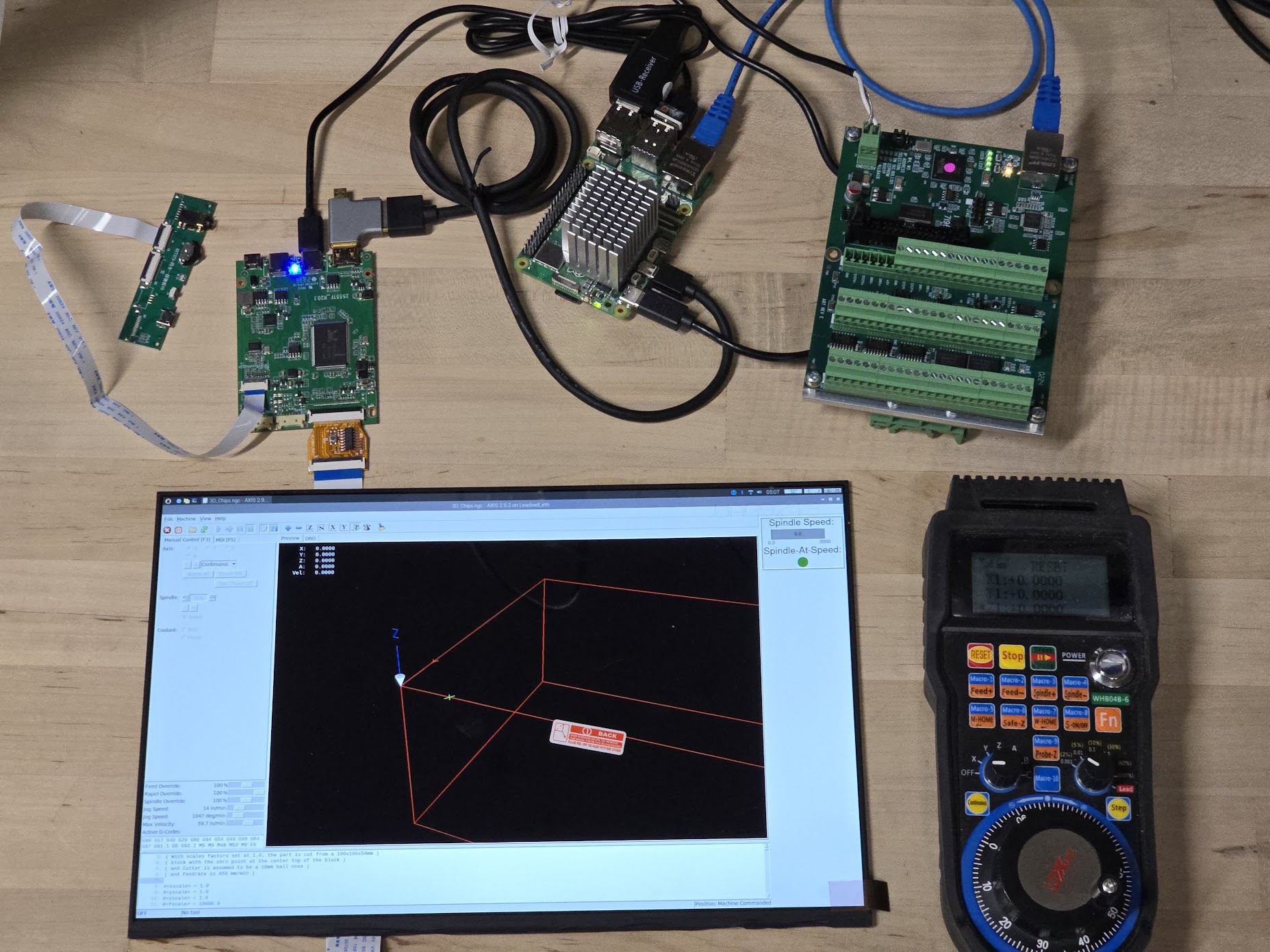

I have been using the latest image on a Raspberry Pi and it is working surprisingly well. I paired it with a Mesa 7i96S ethernet card and the results are amazing.
10 years ago I rebuilt my CNC with an Atom/PCIe setup, and I intend to upgrade again with the Pi.
The only hiccup left with the setup is the touch screen driver with Wayland.
It works very well for single touches, and can clearly detect all 10 fingers when I runbut Axis doesn't seem to understand anything but basic touches.
Chromium and other windows understand the scroll/zoom gestures correctly, so I believe it has to do with TK not being up to date with libinput.
I am currently exploring adding a python "shim" to Axis to allow it to use libinput directly. I will post more soon.
Hardware:
5 Axis CNC, Pi5, Mesa 7i96S, 1920x1200@60 HDMI display, (bare panel with driver board), WHB04B-6 pendant, custom built servo drivers, WJ200 spindle VFD, mist/flood/probe/etc.
libinput debug-guiChromium and other windows understand the scroll/zoom gestures correctly, so I believe it has to do with TK not being up to date with libinput.
Hardware:
