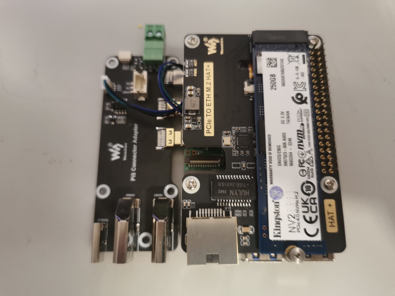

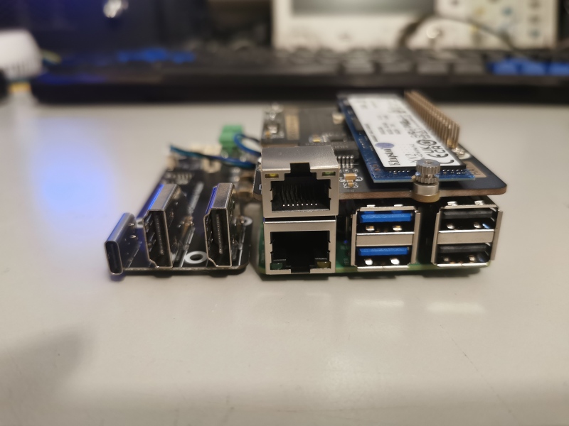

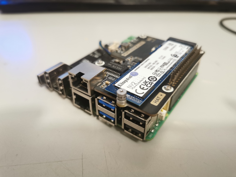

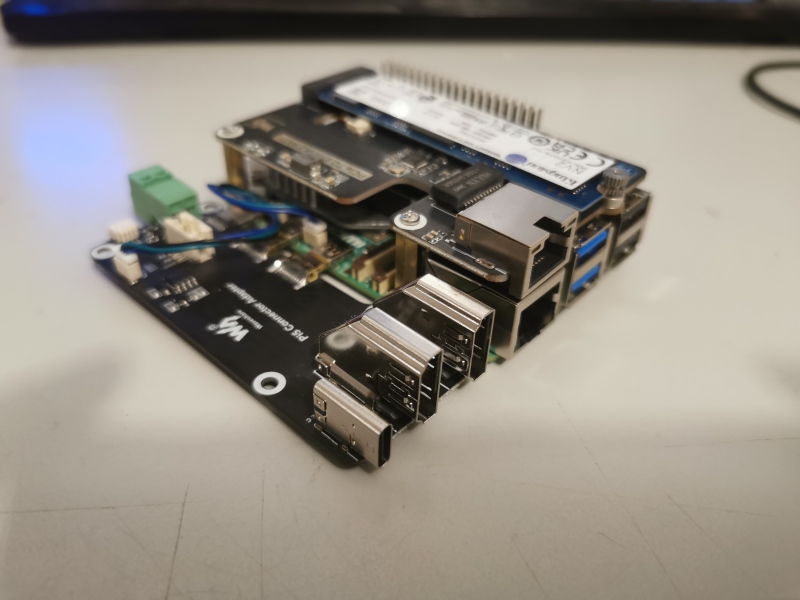

08 Oct 2025 18:49 - 08 Oct 2025 18:51 #336111
by meister
Replied by meister on topic LinuxCNC on Raspberry Pi 5
to make the NVME working on the original linuxcnc rpi image,
i need to add this options to /boot/broadcom/cmdline.txt:
the 2nd ethernet-port works out of the box (eth1)
i used this for the normal network and eth0 for the FPGA connection:
nvme_core.default_ps_max_latency_us=0 pcie_aspm=offcnc@raspberrypi:~$ cat /boot/broadcom/cmdline.txt
console=serial0,115200 console=tty1 root=PARTUUID=a27d77aa-02 rootfstype=ext4 fsck.repair=yes loglevel=5 nvme_core.default_ps_max_latency_us=0 pcie_aspm=off pcie_port_pm=off net.ifnames=0 processor.max_cstate=1 isolcpus=2,3 firmware_class.path=/lib/firmware/updates/brcm rootwaitthe 2nd ethernet-port works out of the box (eth1)
cnc@raspberrypi:~$ cat /etc/network/interfaces
# Interfaces
source /etc/network/interfaces.d/*
# Loopback network interface
auto lo
iface lo inet loopback
auto eth0
iface eth0 inet static
address 192.168.11.11
netmask 255.255.255.0
hardware-irq-coalesce-rx-usecs 0
auto eth1
iface eth1 inet dhcp
Last edit: 08 Oct 2025 18:51 by meister.
