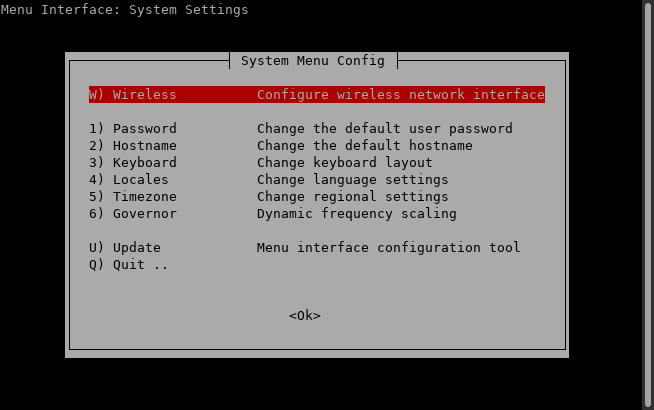

14 Dec 2024 04:56 #316624
Replied by Cant do this anymore bye all on topic LinuxCNC on Raspberry Pi 5
Just checked out your new image that you linked a couple of posts ago. Video works ok when using min hdmi to DVI adapter.
Just for those of us that are a bit silly what is the correct procedure & values to setup
1: LANGAUGE (currently unset)
2: LC_ALL (currently unset)
LANG = "en_AU.UTF-8" is fine.
Currently starting to test the new hm2_spix driver

14 Dec 2024 06:10 #316626
Doesn't have an option for setting LANGUAGE.
Had to use
Then log out and login for it to take effect.
Had to use
sudo update-locale LANGUAGE="en_AU:en"Then log out and login for it to take effect.
- Posts: 12156
- Thank you received: 4149
14 Dec 2024 06:35 #316628
Replied by rodw on topic LinuxCNC on Raspberry Pi 5
The default settings come from userdata.txt github.com/rodw-au/rpi-img-builder-lcnc/...9.3/userdata.txt#L40
I.m not sure LANGUAGE needs to be set for the locale if its en_US.UTF-8 as we use for the default config
On my chrome book, locale reports
rod@penguin:~$ locale
LANG=en_US.UTF-8
LANGUAGE=
LC_CTYPE="en_US.UTF-8"
LC_NUMERIC="en_US.UTF-8"
LC_TIME="en_US.UTF-8"
LC_COLLATE="en_US.UTF-8"
LC_MONETARY="en_US.UTF-8"
LC_MESSAGES="en_US.UTF-8"
LC_PAPER="en_US.UTF-8"
LC_NAME="en_US.UTF-8"
LC_ADDRESS="en_US.UTF-8"
LC_TELEPHONE="en_US.UTF-8"
LC_MEASUREMENT="en_US.UTF-8"
LC_IDENTIFICATION="en_US.UTF-8"
LC_ALL=
On my Debian PC in my office, I get

- Posts: 1200
- Thank you received: 426
14 Dec 2024 08:55 #316632
Perl complains if LC_ALL or LANGUAGE isn't set.

- Posts: 1200
14 Dec 2024 11:08 #316638
Debian dpkg-buildpackage uses perl, perl complains when running menu-config without LANGUAGE set.
So perl hasn't anything to do with Linuxcnc but when building packages, I had to build linuxcnc to have the hm2_spix driver for the Rpi5.
