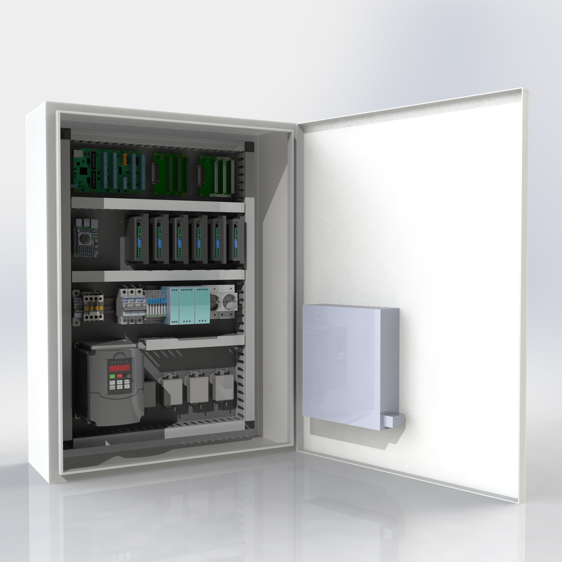

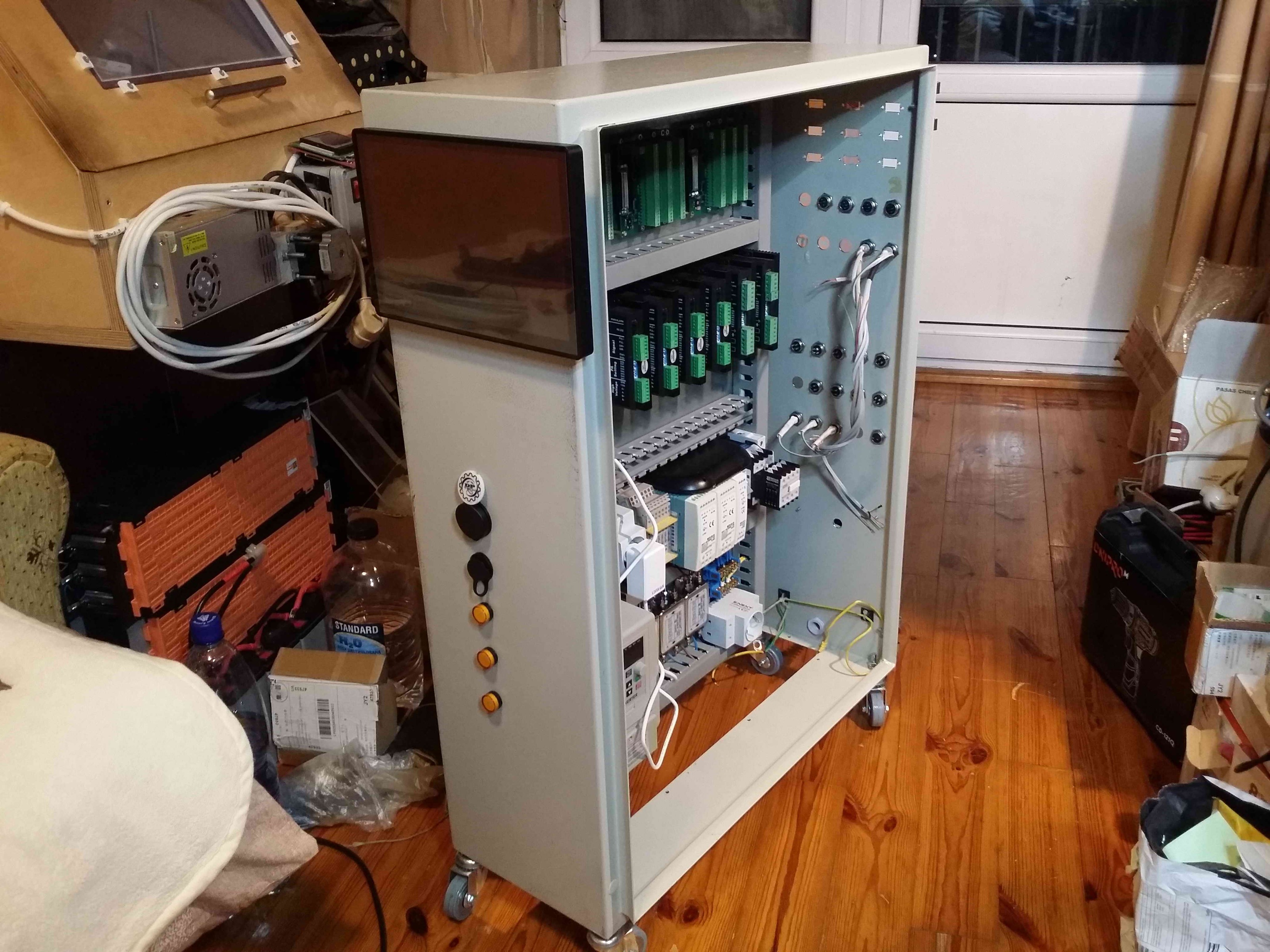

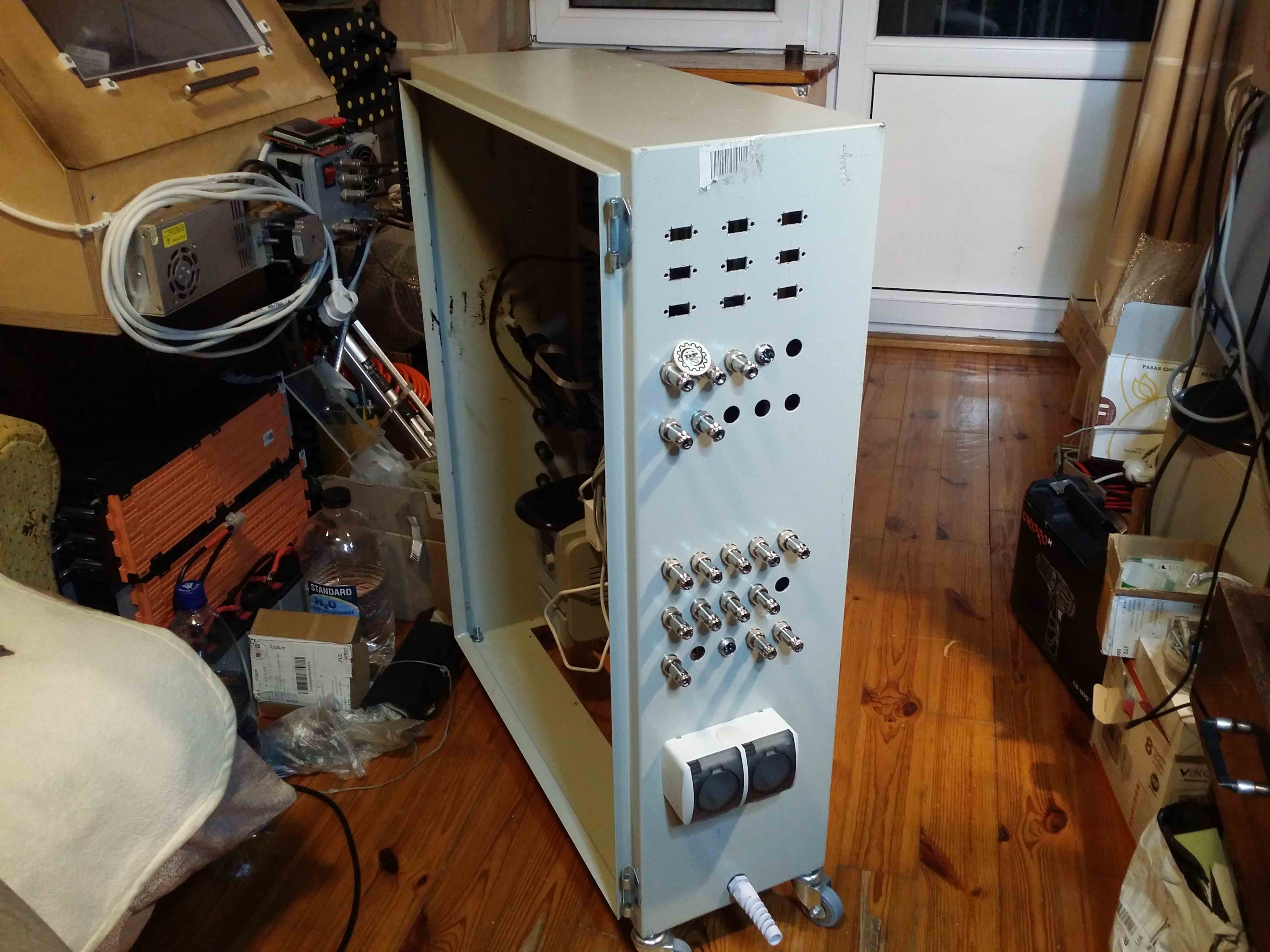

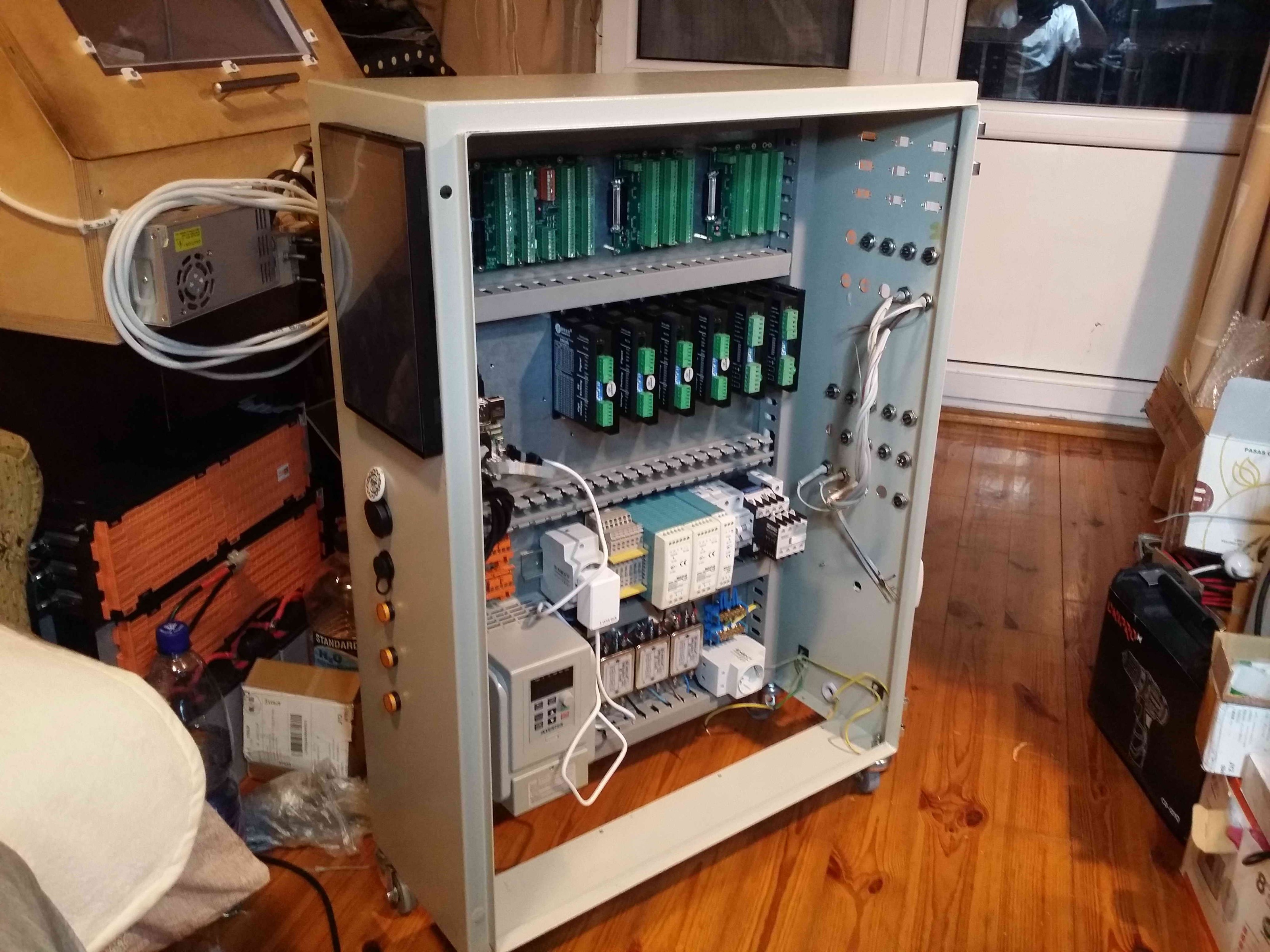

My setup will be a little more difficult, then usual.
13 stepgens 9 encoder (7i76e + 2x7i85s + 7i73)
But I'm still trying to figure out thigs about OS...
