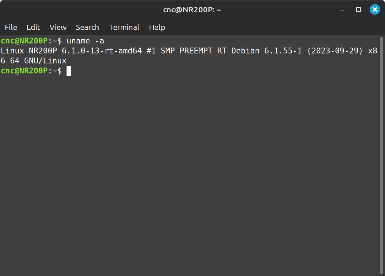

Linux Mint Debian Edition was always much slower than the normal Mint, this time it is a bit faster! :)
That is a nice surprise, took 9 seconds to boot from Grub Menu to full Desktop on an old Lenovo 93 something, with RT kernel, no less! Me happy! :)
[/code][/code]
sorry I got really backwards....but by doing this did I install an rt, preempt or normal kernel?regards

01 Nov 2023 08:54 #284242 by tommylight
Replied by tommylight on topic LinuxCNC on Linux Mint Debian Edition 6
The following user(s) said Thank You: bkt
