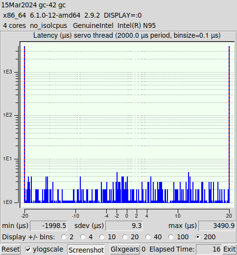

15 Mar 2024 12:44 #295956
by bkt
Replied by bkt on topic LinuxCNC on Linux Mint Debian Edition 6
- bkt
- Posts: 1111
- Thank you received: 114
15 Mar 2024 12:45 #295957
by bkt
need to try with other rt-preempt kernel ...

15 Mar 2024 14:00 #295961
Replied by tommylight on topic LinuxCNC on Linux Mint Debian Edition 6
When you install LinuxCNC it will also install the correct kernel.
And that is not a real time kernel.

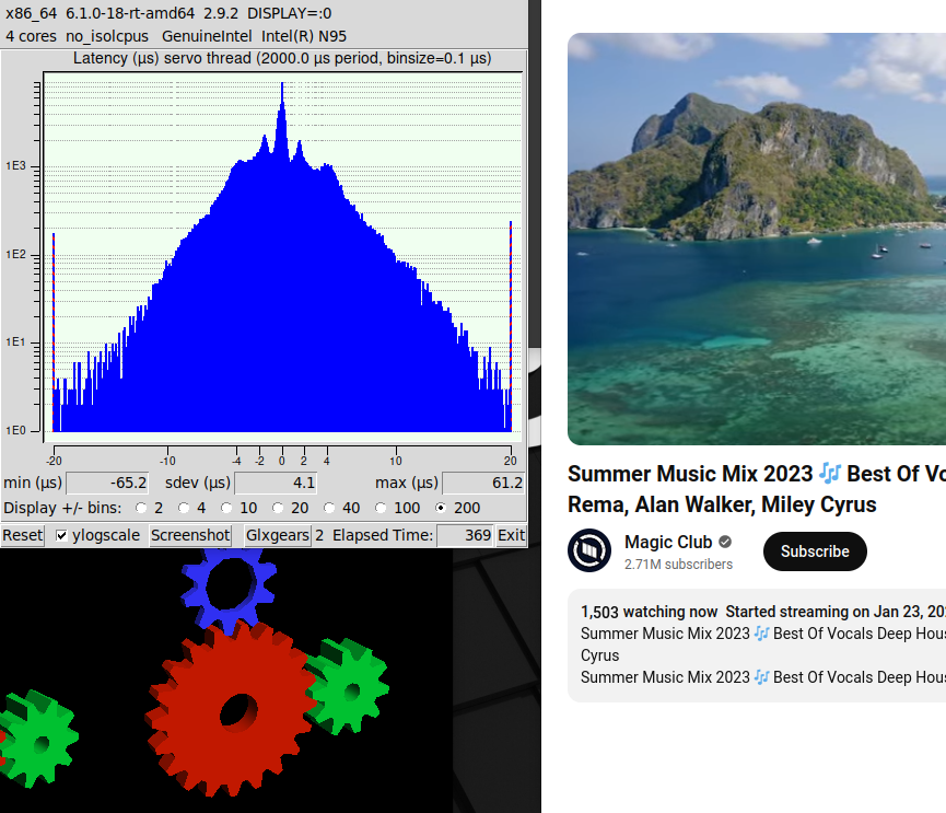

16 Mar 2024 10:11 - 16 Mar 2024 10:15 #296040
by bkt
so .... sorry a misunderstanding of mine.
I went from memory and remembered some time ago you said that LMDE6 was already rt_preempt.... so all I had to do was download and install it..... the kernel I now have says preemt_dinamic.... similar to rt_ of ubuntu.. .. so I understood that I needed to download and install LMDE6 to have rt_preempt .... too easy, right?
Well clarified the fact you are saying that I have to install a patch right?
What do you recommend as a patch for a poor mini PC with N95 processor? I don't have big needs, 2ms of realtime would already be ok.
what sugget on thesse link can be ok? forums.linuxmint.com/viewtopic.php?t=407613
regards

16 Mar 2024 11:14 #296048
Replied by Cant do this anymore bye all on topic LinuxCNC on Linux Mint Debian Edition 6
That's fine for mesa hardware, but why the 2ms servo thread ?
It's not a pi**ing contest to get the lowest latency (sorry I'm from Australia and can sound a bit rude at times, but no harm meant). Don't get caught up trying the get lower & lowers latency if you are using an external hardware step generator. I think Pete for from Mesa said that trying to get latency under a certain figure does nothing to improve the system.

16 Mar 2024 12:56 #296058
No patches, no install, nothing, just install LMDE6, reboot, then
sudo apt update
sudo apt upgrade
sudo apt install linuxcnc-uspace
Nothing else.
sudo apt update
sudo apt upgrade
Nothing else.

16 Mar 2024 19:30 - 16 Mar 2024 19:36 #296091
by bkt
@ tommylight .... precisely:
after install LMDE6 from linux mint sites need to do almost one of these two steps and you'll get the default real-time 6.1 kernel and you'll get the latest available from backports.
After you can use apt for install linuxcnc 2.9.0 or other packages using gedbi install only .... not test on 2.10 version ... but in 2.9.0, 2.9.1 and 2.9.2 only.
in my case isol cpu get bad result .... but set grub in these way:
GRUB_CMDLINE_LINUX_DEFAULT="-original paramters- intel_idle.max_cstate=0 processor.max_cstate=0 idle=poll"
I improve to 40% more or less the latency performances with sdev to 2,3 istead of 4,1 ...
And I'm not disable audio and vt-x from bios .....
