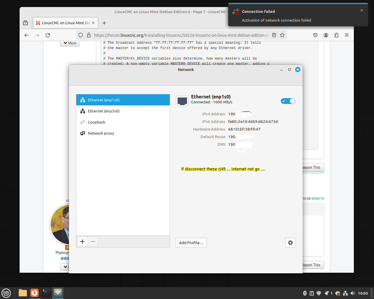

Done .... so now I have no ethernet connection at all ..... really interesting after:sudo apt-get install r8168-dkms
ethtool show me have no device running ....

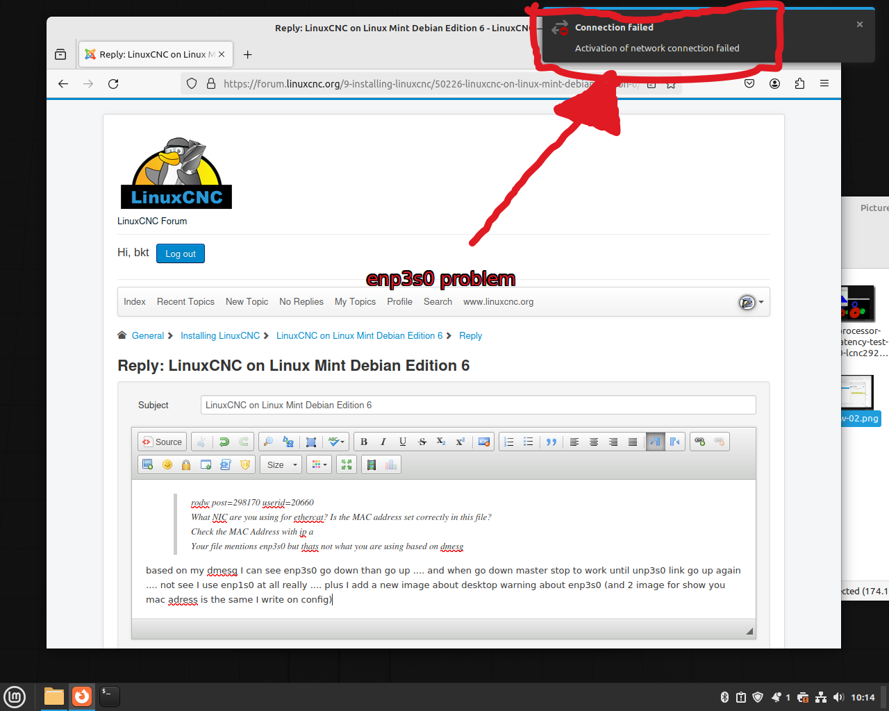

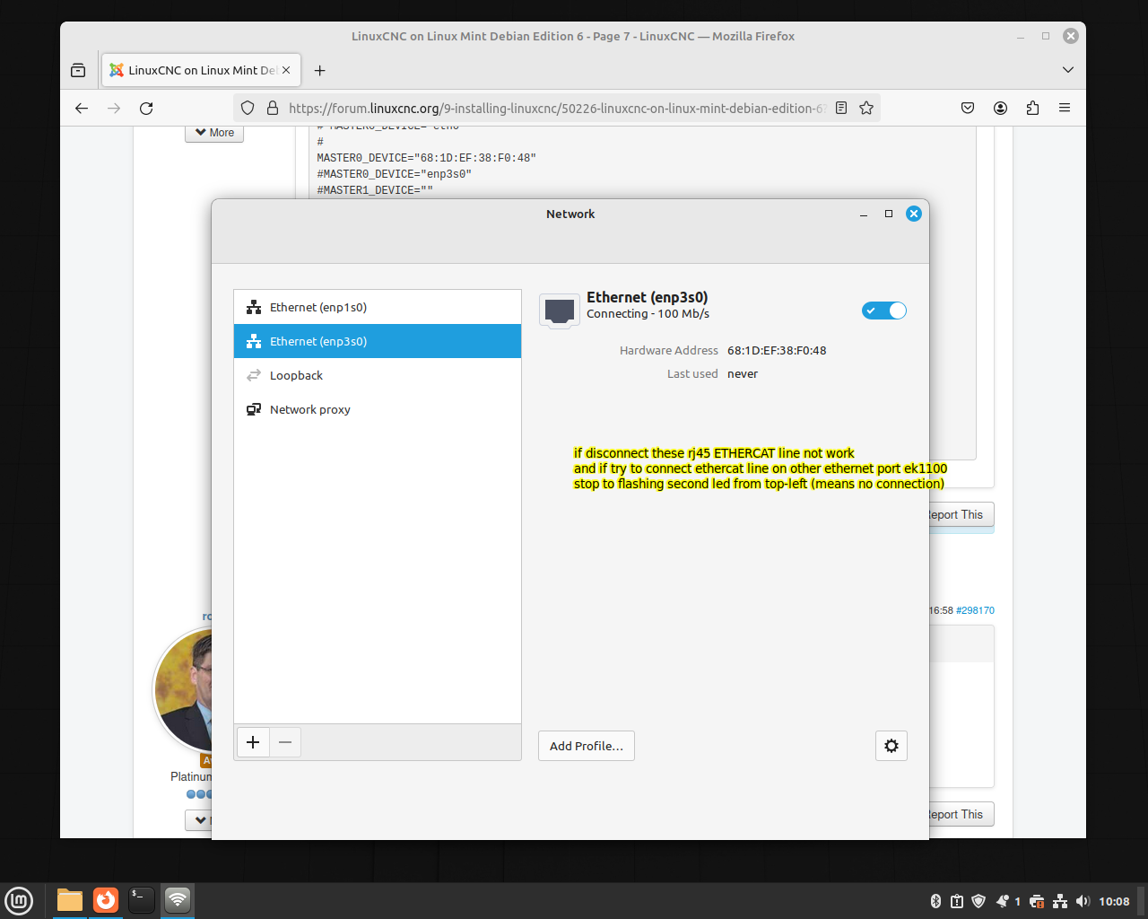

really .... whitout nothing doing after second reboot I have my ethercat running .... actually i have not an xml config running only an ek1100 + some el1008 and el2008 connecting to the system for latency test pourpuse ....
- after dmsk driver install latency test give me better result with min/max more or less 27usec ans svdev of 3.2usec .... previously with same q.ty of glxgear running I have min/max around 80usec .....
- as image attach show i have continuosly an snp3s0 connection activaction failed (that is ethercat line) with a lot of error on dmesg list ..... on dmesg as you can see I have unlink enp3s0 than link again .... why these? someone have some ideas why these? ... first time for me.
Warning: Spoiler!

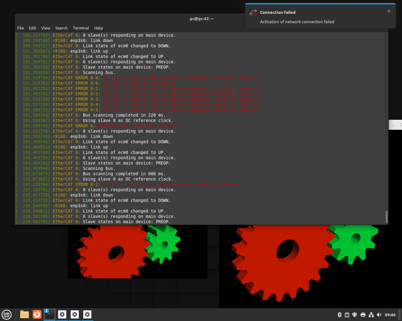

[ 189.113807] EtherCAT ERROR 0-4: Failed to receive AL state datagram: Datagram timed out.
[ 189.153763] EtherCAT 0: 0 slave(s) responding on main device.
[ 189.269749] r8168: enp3s0: link down
[ 189.269757] EtherCAT 0: Link state of ecm0 changed to DOWN.
[ 191.356567] r8168: enp3s0: link up
[ 191.361766] EtherCAT 0: Link state of ecm0 changed to UP.
[ 191.369752] EtherCAT 0: 6 slave(s) responding on main device.
[ 191.369756] EtherCAT 0: Slave states on main device: PREOP.

[ 237.133764] EtherCAT ERROR 0-1: Failed to receive AL state datagram: Datagram timed out.
[ 237.165741] EtherCAT 0: 0 slave(s) responding on main device.
[ 237.457725] r8168: enp3s0: link down
[ 237.457735] EtherCAT 0: Link state of ecm0 changed to DOWN.

[ 558.258424] EtherCAT 0: Link state of ecm0 changed to DOWN.
[ 560.349268] r8168: enp3s0: link up
[ 560.350468] EtherCAT 0: Link state of ecm0 changed to UP.
[ 560.358457] EtherCAT 0: 6 slave(s) responding on main device.
[ 560.358462] EtherCAT 0: Slave states on main device: PREOP.
[ 560.358635] EtherCAT 0: Scanning bus.
[ 560.961721] EtherCAT 0: Bus scanning completed in 600 ms.
[ 560.961727] EtherCAT 0: Using slave 0 as DC reference clock.
[ 603.119061] EtherCAT ERROR 0-4: Failed to receive AL state datagram: Datagram timed out.
[ 603.151047] EtherCAT 0: 0 slave(s) responding on main device.
[ 603.347040] r8168: enp3s0: link down
[ 603.347071] EtherCAT 0: Link state of ecm0 changed to DOWN.
[ 605.437890] r8168: enp3s0: link up
[ 605.439079] EtherCAT 0: Link state of ecm0 changed to UP.
[ 605.447080] EtherCAT 0: 6 slave(s) responding on main device.
[ 605.447085] EtherCAT 0: Slave states on main device: PREOP.
[ 605.447247] EtherCAT 0: Scanning bus.
[ 606.050157] EtherCAT 0: Bus scanning completed in 600 ms.
[ 606.050164] EtherCAT 0: Using slave 0 as DC reference clock.
[ 648.131532] EtherCAT ERROR 0-0: Failed to receive AL state datagram: Datagram timed out.
[ 648.163528] EtherCAT 0: 0 slave(s) responding on main device.
[ 648.439510] r8168: enp3s0: link down
[ 648.443515] EtherCAT 0: Link state of ecm0 changed to DOWN.
[ 650.526367] r8168: enp3s0: link up
[ 650.527542] EtherCAT 0: Link state of ecm0 changed to UP.
[ 650.535550] EtherCAT 0: 6 slave(s) responding on main device.
[ 650.535557] EtherCAT 0: Slave states on main device: PREOP.
[ 650.535730] EtherCAT 0: Scanning bus.
[ 651.146208] EtherCAT 0: Bus scanning completed in 608 ms.
[ 651.146214] EtherCAT 0: Using slave 0 as DC reference clock.
[ 652.013948] show_signal: 14 callbacks suppressed
[ 652.013954] traps: checkAPT.py[3518] general protection fault ip:55b786 sp:7ffc443265f0 error:0 in python3.11[41f000+2b3000]
[ 693.127879] EtherCAT ERROR 0-0: Failed to receive AL state datagram: Datagram timed out.
[ 693.159865] EtherCAT 0: 0 slave(s) responding on main device.
[ 693.523863] r8168: enp3s0: link down
[ 693.527864] EtherCAT 0: Link state of ecm0 changed to DOWN.
[ 695.614694] r8168: enp3s0: link up
[ 695.619895] EtherCAT 0: Link state of ecm0 changed to UP.
[ 695.627898] EtherCAT 0: 6 slave(s) responding on main device.
[ 695.627902] EtherCAT 0: Slave states on main device: PREOP.
[ 695.628062] EtherCAT 0: Scanning bus.
[ 696.230511] EtherCAT 0: Bus scanning completed in 600 ms.
[ 696.230517] EtherCAT 0: Using slave 0 as DC reference clock.
[ 726.122814] perf: interrupt took too long (2512 > 2500), lowering kernel.perf_event_max_sample_rate to 79500
[ 738.100156] EtherCAT 0: 0 slave(s) responding on main device.
[ 738.612143] r8168: enp3s0: link down
[ 738.616159] EtherCAT 0: Link state of ecm0 changed to DOWN.
[ 740.702964] r8168: enp3s0: link up
[ 740.704168] EtherCAT 0: Link state of ecm0 changed to UP.
[ 740.712168] EtherCAT 0: 6 slave(s) responding on main device.
[ 740.712173] EtherCAT 0: Slave states on main device: PREOP.
[ 740.712341] EtherCAT 0: Scanning bus.
[ 740.780155] EtherCAT ERROR 0-0: Failed to receive SII check/fetch datagram: Datagram timed out.
[ 740.780169] EtherCAT ERROR 0-0: Failed to fetch SII contents.
[ 740.812148] EtherCAT ERROR 0-1: Failed to receive station address datagram: Datagram timed out.
[ 740.844151] EtherCAT ERROR 0-2: Failed to receive station address datagram: Datagram timed out.
[ 740.876154] EtherCAT ERROR 0-3: Failed to receive station address datagram: Datagram timed out.
[ 740.908149] EtherCAT ERROR 0-4: Failed to receive station address datagram: Datagram timed out.
[ 740.940160] EtherCAT ERROR 0-5: Failed to receive station address datagram: Datagram timed out.
[ 740.940166] EtherCAT 0: Bus scanning completed in 228 ms.
[ 740.940168] EtherCAT 0: Using slave 0 as DC reference clock.
[ 740.940170] EtherCAT ERROR 0: Failed to calculate bus topology.
[ 740.980174] EtherCAT 0: 0 slave(s) responding on main device.
[ 741.716162] r8168: enp3s0: link down
[ 741.720163] EtherCAT 0: Link state of ecm0 changed to DOWN.
[ 743.806977] r8168: enp3s0: link up
[ 743.812192] EtherCAT 0: Link state of ecm0 changed to UP.
[ 743.820192] EtherCAT 0: 6 slave(s) responding on main device.
[ 743.820199] EtherCAT 0: Slave states on main device: PREOP.
[ 743.820366] EtherCAT 0: Scanning bus.
[ 744.427135] EtherCAT 0: Bus scanning completed in 604 ms.
[ 744.427141] EtherCAT 0: Using slave 0 as DC reference clock.

mac of internet port:
ethercat mac
problem with enp3s0 continuos disconnection:
Not find solution for now ....
Replied by bkt on topic LinuxCNC on Linux Mint Debian Edition 6
based on my dmesg I can see enp3s0 go down than go up .... and when go down master stop to work until unp3s0 link go up again .... not see I use enp1s0 at all really .... plus I add a new image about desktop warning about enp3s0 (and 2 image for show you mac adress is the same I write on config)What NIC are you using for ethercat? Is the MAC address set correctly in this file?
Check the MAC Address with ip a
Your file mentions enp3s0 but thats not what you are using based on dmesg
ethercat mac

Replied by tommylight on topic LinuxCNC on Linux Mint Debian Edition 6
Why is your address starting with 190???
The only local address ranges are 192.168.n.n and 10.n.n.n (there are two more that i do not recal as i rarely used them), these are non routable address ranges for use in local networks as they do not get routed to the internet, others can not be used unless you own a registered public IP address. And even then only the actual router can and should have that public address, not the local PC's.

you caught me, I'm doing other experiment other these where try to use these little pc with realtek port, so i need it .... having said this, it has nothing to do with the fact that enp3s0 is not working properly.... in fact that is enp1s0.you own a registered public IP address.
