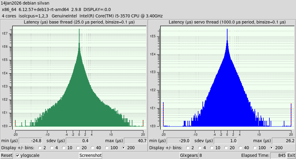

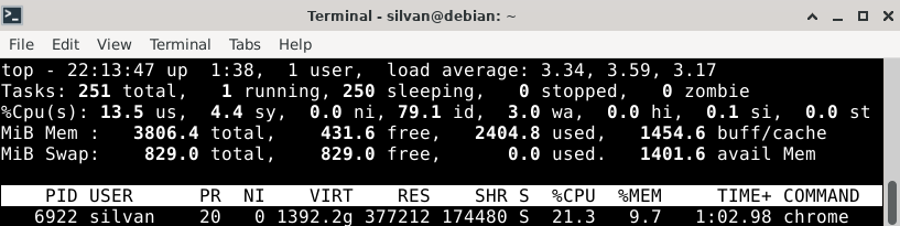

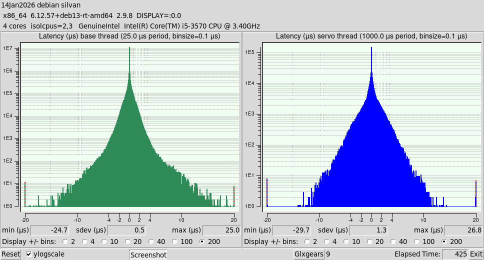

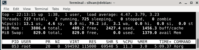

Yes, disabling that line makes everything work except for the PWM spindle.So, are you saying that
"addf pwmgen.make-pulses base-thread"
Causes the PC to shut down and need a reset?
Is it possible that your base-thread period is shorter than the base-thread latency?
- cnbbom
- Posts: 47
- Thank you received: 5
14 Jan 2026 16:44 #341380
by cnbbom
Replied by cnbbom on topic New and Working RTAI debs for 2.9
My apologies and thanks. A beginner in these things missed something; I thought it was just copy and paste, but it's all different. My processor only has 4 cores, how could a number 7 be working? But now I think I understand, and I did some tests changing the isolcpus values. I stress-tested two YouTube videos and one video on the PC plus 8 glxgears and got this result.Life has got more complicated. With proper kernel tuning, latency can be better with Debian 13. I am in the process of publishing a second video about this on YouTube. Please refer to my channel. www.youtube.com/@MrRodW

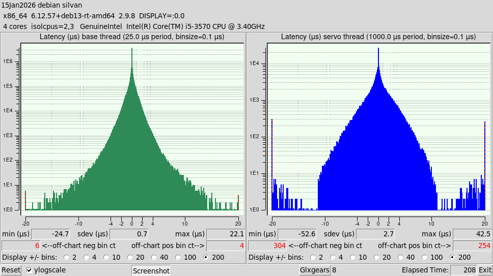

15 Jan 2026 01:24 #341399
by cnbbom
andypugh
Is this the correct information?
- Posts: 22009
- Thank you received: 7491
15 Jan 2026 03:28 #341408
Replied by tommylight on topic New and Working RTAI debs for 2.9
Base period is in the .ini file inside your configuration folder, usually
/home/cnc/linuxcnc/configs/sim.axis
instead of cnc you will have your user name
As for latency screenshots, see those colorful vertical lines on both sides of the graph? Those mean there are latency excursions outside the visible area, so add --show at the end of latency-histogram line and test again.
