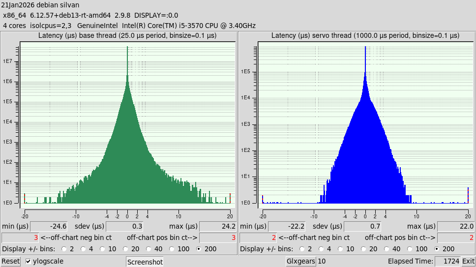

[EMCMOT]
EMCMOT = motmod
COMM_TIMEOUT = 1.0
BASE_PERIOD = 46872
SERVO_PERIOD = 1000000
Your base period is set at 46872, strange for sure, but i am pretty sure LinuxCNC will round it to something divisible from 1000000. Set it to 50000.
Still i do not think that is the main issue, it seems your PC has some strange and huge excursions in latency, so, did you disable in BIOS:
turbo
speed step
power saving options
TPM if any
PCI-E aggressive power saving (no idea what name is used in some boards)
C states
etc.
Be as it may, for that PC and since you need RTAI, use the Wheezy ISO as is, granted you do not need any missing features from it.

17 Jan 2026 04:45 - 17 Jan 2026 04:47 #341465 by NWE
Replied by NWE on topic New and Working RTAI debs for 2.9
Latency test is only used for testing the pc, don't use the jitter value for BASE_PERIOD, try 50000.

21 Jan 2026 15:32 #341648 by cnbbom
Replied by cnbbom on topic New and Working RTAI debs for 2.9
I took some time to modify some BIOS settings, performed several restarts, and ran tests. This is the result I was able to achieve.
22 Jan 2026 13:00 #341698 by andypugh
Replied by andypugh on topic New and Working RTAI debs for 2.9
20k latency seems fairly decent. With a base period of 50,000 that should never over-run.
