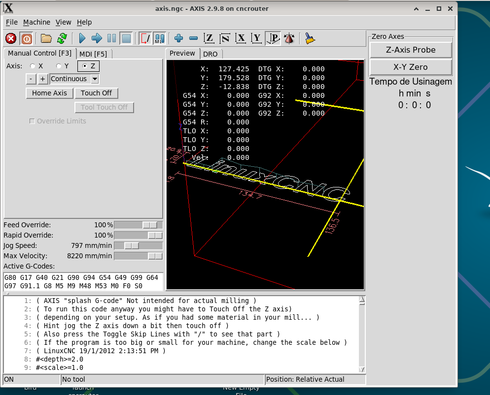

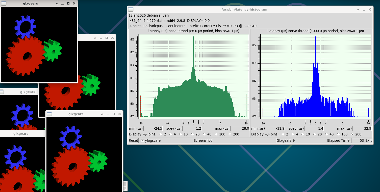

Replied by cnbbom on topic New and Working RTAI debs for 2.9
Finally, I managed to get these results working as shown in the photos, however there is a problem: if I enable spindle pwm, spindle cw, and amplify enable vm, an error screen appears.

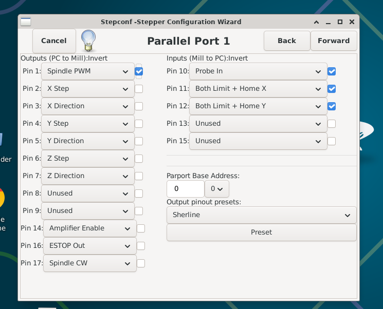

12 Jan 2026 19:46 #341321 by cnbbom
andypugh post=341318 userid=723Qual é o erro? Os eixos são frequentemente uma fonte de ruído elétrico. O erro persiste mesmo com o hardware do eixo desconectado?
The error consists of: creating a machine in linuxcnc, I follow these options that allow me to use automatic spindle control. But after completing the configuration and opening linuxcnc, the PC shuts down, and I need to reset the PC.
This is my configuration in the photo, but if I disable:
spindle pwm,
spindle cw
amplify enable      I can operate the machine.

12 Jan 2026 20:40 #341329 by andypugh
Replied by andypugh on topic New and Working RTAI debs for 2.9
Is this also the case with the 5.4.279 kernel?
Can you try commenting out the "addf pwmgen...." in the HAL file?
(this will prevent the spindle PWM working, but will give some indication where the problem might be)
12 Jan 2026 21:35 #341332 by cnbbom
Yes, it happens with kernel 5.4.279.
And perhaps it's a detail that some have overlooked with this "return to login screen and black screen" freezing factor. But without a doubt, on this same PC that I tried several times with Debian 12 RTAI without success, it finally ran the Linux RTAI that you modified. The PWM and spindle issue is another task that will eventually lead to a solution. In the meantime, I'll keep testing and posting the results if you discover any clues.
12 Jan 2026 23:31 #341333 by cnbbom
I commented out a # in this line:
#addf pwm gen.make-pulsos base-thread
The spindle doesn't spin, but at least the inverter turns on now.
