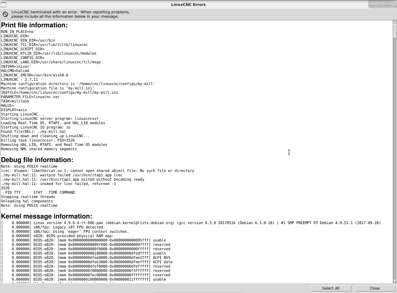

Hello everyone, if you can help me, I just installed linuxcnc -stretch-uspace-i386-r9, install igh-ethercat with generic driver, install linuxcnc-ethercat, add to the file realtime.mk, line 27 "-L / opt / etherlab / bin / "make..ok. start linuxcnc and give me error "lcec: dlopen: libeethercat.so.1: can not open shared object file: no such file or directory ...
any ideas?
Thank you
any ideas?
Thank you

Sure that -lethercat is in /opt/etherlab/bin/ ?

Hello Sirop, thanks for answering,
-lethercat is not here,
-libethercat is in / opt / etherlab / lib /
I have installed the system linuxcnc -stretch-uspace-i386-r9 core PR-PREEMPT
I install igh ethercat-hg
I edit the file / script / sysconfig / ethercat I add MAC and GENERIC
./bootstrap
./configure --disable-8139too --enable-generic --enable-sii-assign
make
make modules
make install
make modules_install
depmod
mkdir / etc / sysconfig
cp / opt / etherlab / etc / sysconfig / ethercat / etc / sysconfig / ethercat
ln -s /opt/etherlab/etc/init.d/ethercat /etc/init.d/ethercat
ln -s / opt / etherlab / bin / ethercat / usr / bin / etherc
./ethercat start
Done .... ok
ethercat master
Okay
ethercat Slave
Okay
Is there something wrong?

I referred to forum.linuxcnc.org/24-hal-components/223...ver?start=500#101305 .

Hello
in the directory / opt / etherlab / bin .. only one file called "ethercat"
Thank you

hi Sirop,
Sorry I misunderstood, added "-L / opt / etherlab / lib /, what library is?" -lethercat "? The same thing happens to me
Thank you

So do you still have any problems when building linuxcnc-ethercat?

hi Sirop,
if i have a problem running linuxcnc 2.7 when it starts erro "dlopen: libeethercat.so.1: can not open shared object file: no such file or directory ..."
I attach the modified file realtime.mk, it compiles well with make, without errors.
