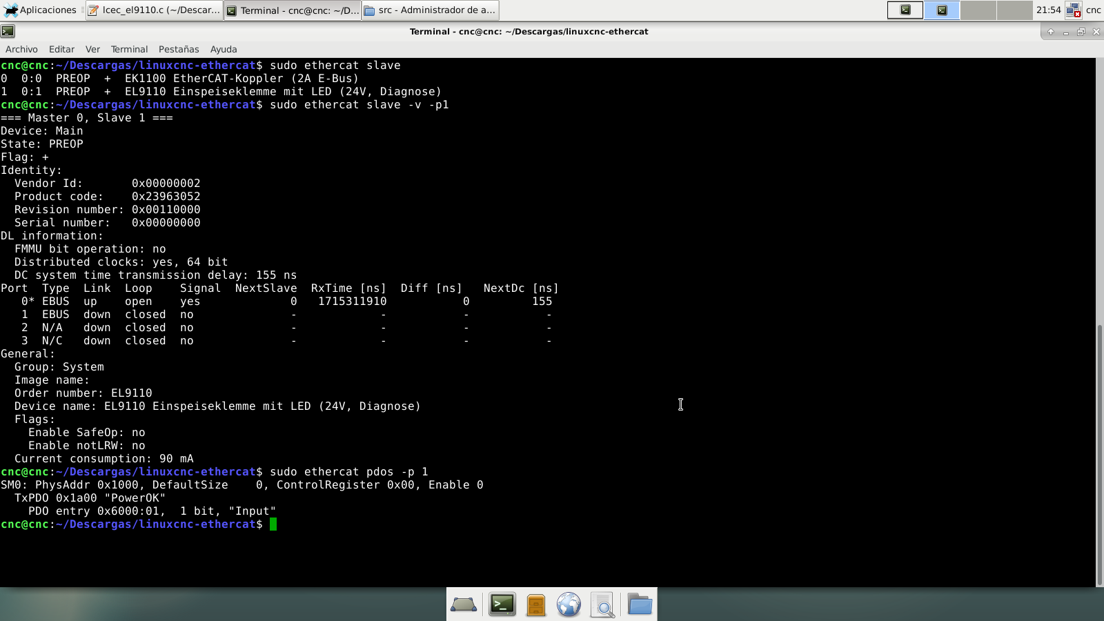

1) Would it be possible for you to describe a bit more in detail how to use TwinCat3 to export the information required to use terminals not originally supported/listed at wiki.linuxcnc.org/cgi-bin/wiki.pl?EtherCatDriver? and how to make the modules? Please be explicit as I too fall into the low programming skill category. Also can 12 bit terminals be used e.g. EL4004 12 bit Analog Out?
2) I have a couple of EL9110 terminals that I was thinking about using, can you post the file?

15 Feb 2018 15:58 #105995 by chimeno
Replied by chimeno on topic Ethercat HAL driver
hi Siggi and Dan
Most modules are simple and the configuration that comes with "default" can be read through ethercat, terminal attachment with ethercat commands.
Dan you attached the example of EL9110 you can compare since it is a very easy module, the EL4004 module can be used without problems, any that works with protocol ethercat per operate!
Siggi the module EL5032 is a bit more complicated, I can help you, if you have it execute these commands and teach me and I'll give you a simple example.
I can not explain the whole process as it is complicated, I took a long time, but practice and with many hours you can get it !!
The TWINCAT3 application is the last one to perform configuration tests in more complicated modules that you have to configure using SOE or IDN also for the different PDO configurations, I also use TWINCAT3 with WIRESHARK to analyze the transmission of in the network, in the manuals of " Beckhoff's ELxxxx "is the procedure of how to insert and work with TWINCAT3.
regards
Albert
The following user(s) said Thank You: sqmathlete, Weiler810T, Nico2017
