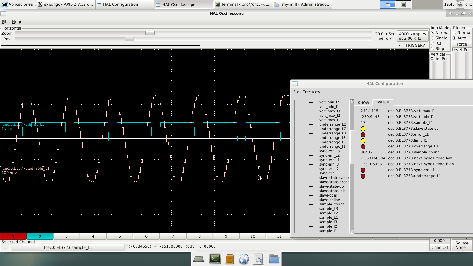

Hello Sirop,
Can you help me with the code ??, I have a problem when starting "rtai_app: caught signal 11 - dumping core"
The problem comes when I try to save code lines by using the for loop (i = 0, i <LCEC_EL3773_CHANS; i ++).
been doing latency tests
I do not have much difference between "generic driver" and "e1000e" I have a solution that seems to work, even in the testing phase.
configure EL3773
cycle 1000 us
.ini file
servo_period = 500000
.xml file
appTimePeriod = "500000" refclocksyncCycles = "1000000"
DcConf assignActivate = "730" sync0cycle = "250000" sync0shift = "50000" sync1cycle = "750000" sync1shift = "500000"
my system
linux cnc 4.9.0-5-rt-686-pae # 1 SMP PREEMPT RT Debian 4.9.65-3-deb9u2 (2018-01-04) i686 GNU / Linux
Version IgH EtherCAT 1.5.2 1a7b3f94bdef +
Thank you
Chimeno
configure EL3773
cycle 1000 us
.ini file
.xml file
my system
Thank you
Chimeno

I never worked with this slave model so it is hard to say for me what goes wrong.
I wonder however if you could apply machinekit's debugging instructions github.com/mhaberler/asciidoc-sandbox/wi...ugging-RT-components in case of preeempt rt linuxcnc.
If so, you could see what causes "rtai_app: caught signal 11 - dumping core" .
