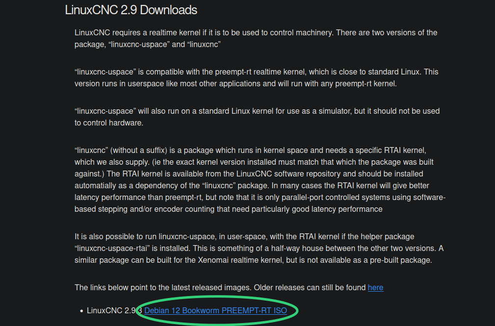

I am a little bit confused about what to download, the one Rodw put on google drive or the one that was posted on 03/08
The ISO on the downloads page has been updated with my image..
Get it from here becasue its now official
linuxcnc.org/downloads/

07 Aug 2024 06:58 #307149 by Aciera
I used the latest I could find
Just to be on the same page
Did you use this one:
from here:

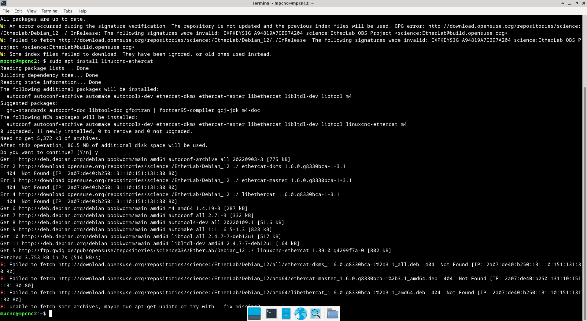

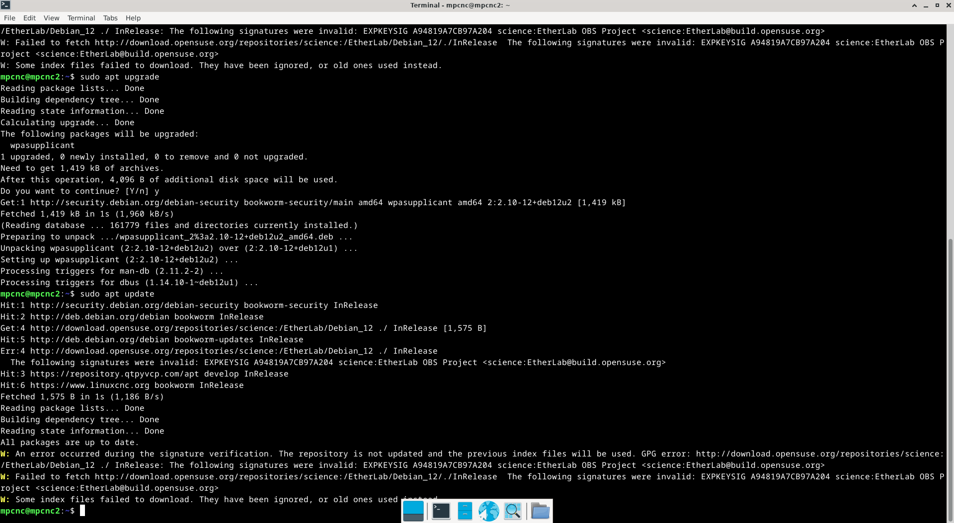

07 Aug 2024 07:39 #307153 by jjdege
Last night I had the same problem on Raspy 5,
I must have solved it with --fix-missing
as it tells you at the bottom in the terminal

07 Aug 2024 17:23 #307192 by AndyDM01
I used the one rodw put on google drive
I had the same issues with the one on the linuxcnc download page
MANY THX TO RODW !!!
07 Aug 2024 17:27 #307193 by AndyDM01
from here:
yes and it just gave me the same problems, after this i tried the one Rodw put on google drive and it did everything it was supposed to do
