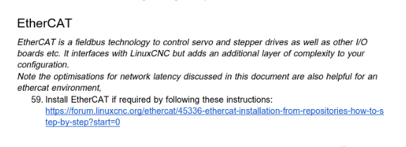

11 Aug 2024 17:03 #307482
by abdulasis12
No. 59 right ?
link sent back your first post
Replied by abdulasis12 on topic Ethercat installation from repositories - how to step by step
Refer here. Please restrict this thread to Ethercat installation only
docs.google.com/document/d/1jeV_4VKzVmOI...diY/edit?usp=sharing
No. 59 right ?

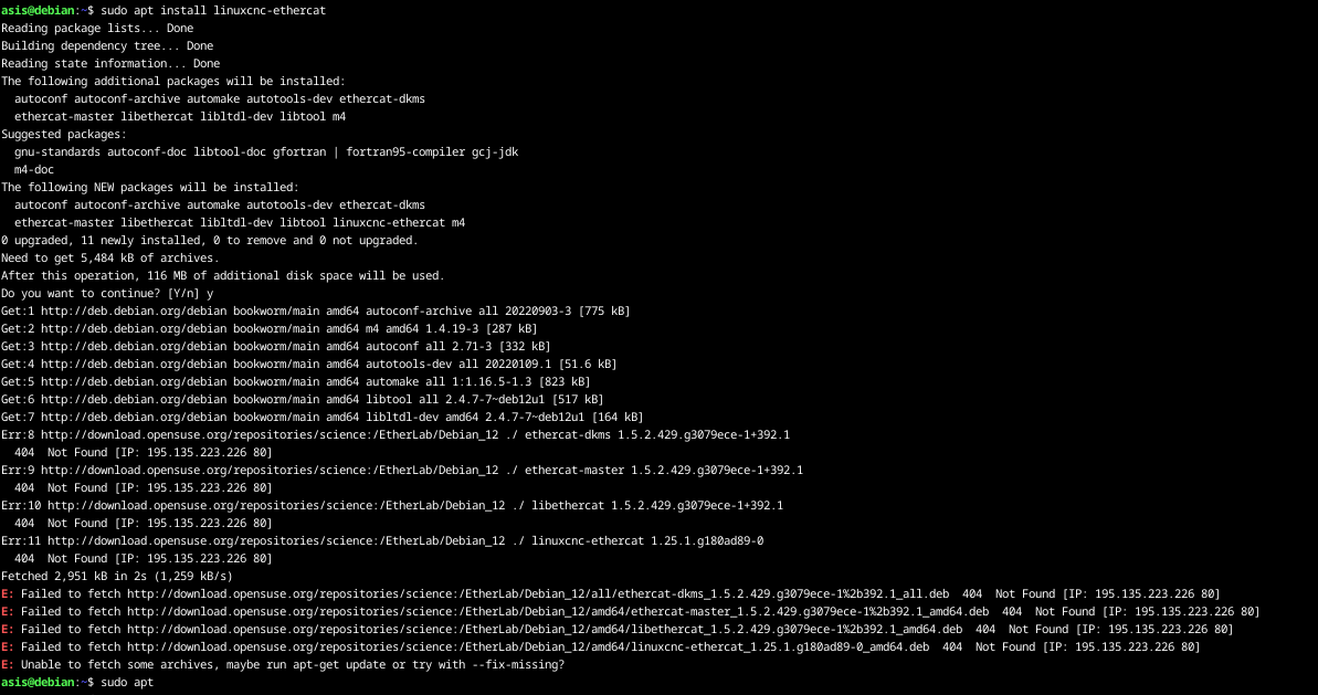

- Ahmo
- Posts: 1
15 Aug 2024 10:28 #307790
by Ahmo
Replied by Ahmo on topic Ethercat installation from repositories - how to step by step
Are they making some updates on ethercat right now? Because when I try to install it it says that it cant fetch some files, I checked and the files that he is searching are version 1.5.2. but the files on repository are version 1.6.1. these files are changed 15 days ago so I was wondering do you now how long will it take for them to fix that?
- Posts: 12159
- Thank you received: 4151
15 Aug 2024 11:13 #307794
Replied by rodw on topic Ethercat installation from repositories - how to step by step
1.6 is the current ethercat version.
