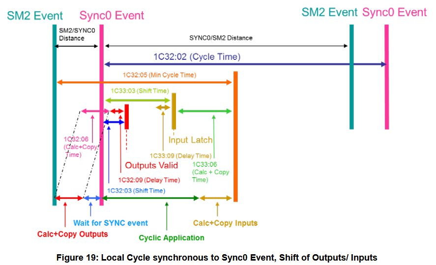

13 Apr 2026 00:39 - 13 Apr 2026 02:13 #345470
by grandixximo
Replied by grandixximo on topic Ethercat random jitter fix
Demystifying syncToRefClock and refClockSyncCycles
syncToRefClock="true" means the master syncs to the slaves, adjusting its period every cycle to track the DC reference clock (PLL/bang-bang mode).
syncToRefClock="false" means the slaves sync to the master. refClockSyncCycles then controls how often (every N cycles) the slaves perform a sync adjustment.
refClockSyncCycles="-1" (any negative number) means master syncs to slaves, identical to syncToRefClock="true". The magnitude does not matter.
So all four combinations you tested:
refClockSyncCycles="1" syncToRefClock="true"
refClockSyncCycles="5" syncToRefClock="true"
refClockSyncCycles="1000" syncToRefClock="true"
refClockSyncCycles="-1" syncToRefClock="true"
are completely identical. When syncToRefClock="true", the slaves are not in a mode where they sync to the master, so refClockSyncCycles is simply ignored.
The combination refClockSyncCycles="-1" with syncToRefClock="false" is a contradiction and will be treated as invalid in a future version.
Why you heard noise with syncToRefClock="true" and sync0Shift="0"
This is expected and correct behaviour. With sync0Shift="0", SYNC0 fires exactly at t=0, right as the cyclic frame is arriving. The slave latches output data at the same instant it is being written, creating a race condition every cycle. The grinding noise is the mechanical result.
The fix is not to disable syncToRefClock. Set a proper shift:
<dcConf assignActivate="300" sync0Cycle="*1" sync0Shift="300000"/>
300000 to 500000 ns on a 1ms cycle is a reasonable starting point. Try that with syncToRefClock="true" and the noise should go away.
If you think sync0Shift="0" always worked for you
It did not work correctly, it appeared to work. The race condition was present but your hardware was consistently winning it by luck. The code now behaves strictly per ETG.1020. If it seemed to work before, it was not according to the standard. Update your configuration.

13 Apr 2026 07:57 - 13 Apr 2026 08:27 #345478
by grandixximo
Hakan is correct, but depends on device, we should check what they report.
could you run these?
ethercat upload -p 0 -t uint32 0x1C32 0x06
ethercat upload -p 0 -t uint32 0x1C33 0x06
ethercat upload -p 1 -t uint32 0x1C32 0x06
ethercat upload -p 1 -t uint32 0x1C33 0x06
ethercat upload -p 0 -t uint32 0x1C33 0x03
ethercat upload -p 1 -t uint32 0x1C33 0x03
Edit: also these please
ethercat upload -p 0 -t uint32 0x1C32 0x09
ethercat upload -p 1 -t uint32 0x1C32 0x09
Run these and write here the output, to confirm if sync0shift 0 is supported
Also
refClockSyncCycles="-1" syncToRefClock="false"
is self contradictory
use only
or only
to enable PLL

Replied by papagno-source on topic Ethercat random jitter fix
the result is :
ethercat upload -p 0 -t uint32 0x1C32 0x06 return 0x00000000 0
ethercat upload -p 0 -t uint32 0x1C33 0x06 return Failed to upload SDO: Input/output error
ethercat upload -p 1 -t uint32 0x1C32 0x06 return 0x00000000 0
ethercat upload -p 1 -t uint32 0x1C33 0x06 return 0x00000000 0
ethercat upload -p 0 -t uint32 0x1C33 0x03 return Failed to upload SDO: Input/output error
ethercat upload -p 1 -t uint32 0x1C33 0x03 return SDO transfer aborted with code 0x06010001: Attempt to read a write-only object
ethercat upload -p 0 -t uint32 0x1C32 0x09 return 0x00030d40 200000
ethercat upload -p 1 -t uint32 0x1C32 0x09 return 0x00000000 0
I've already tested only refClockSyncCycles="-1" without syncToRefClock="true" and the problem persists.
I've also tested refClockSyncCycles="1" and syncToRefClock="true"
Do you want me to try deleting refClockSyncCycles="1" and leaving only syncToRefClock="true"?
