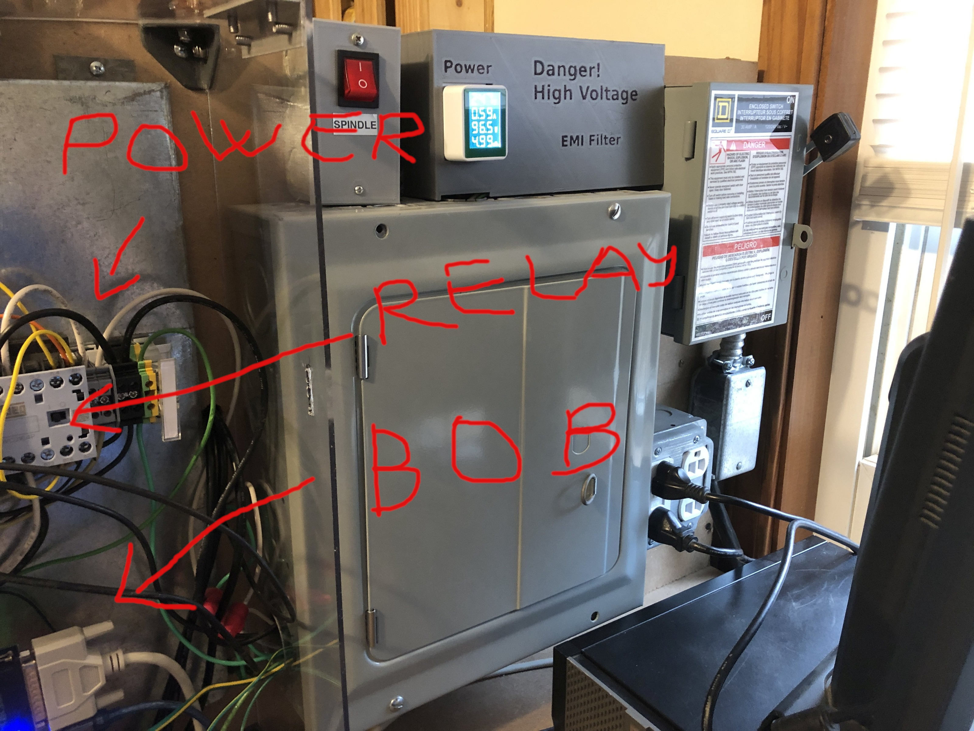

Replied by Logthor on topic Breakout Board Speed Control
Category: Basic Configuration

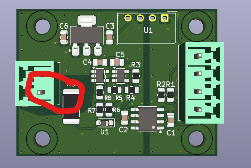

I would think something like this would work, right? It has a PC817C, so I figure it is used to optically isolate the two circuits. What has me slightly concerned is that the listing (and many others) don't mention the fact that they are optically isolated (does this mean that it isn't?).
  • Logthor
  • Logthor
Today 23:56
I see what you mean now about it not being properly isolated. I'll buy a cheap board off of amazon. In the mean time though, I just want to make sure I know how to set it up in general. I just want to know why I'm not getting anything out of it when I issue a s command.
  • tommylight
  • tommylight's Avatar
Today 23:33
Replied by tommylight on topic Breakout Board Speed Control
... but 12-24V is also used to power the home, estop and probe inputs on the opposite side of the board.
So no, BOB is not properly isolated for this case.
it is safer to use a separate cheap Chinese PWM->0-10V board and a separate small power supply.
You should really, really take his advice, and be very careful with wiring.
  • Logthor
  • Logthor
Today 23:14 - Today 23:15
I don't have my KBIC attached. I just wanted to see if I could read a voltage of 7 at 1400rpm from the terminals of the bob before I even attach it to the KBIC. The KBIC is not isolated, but the BoB is supposedly.
  • tommylight
Today 22:53
You are looking at the wrong side of the problem, BOB is not the part with issues, KBIC is, so you must check and be sure the inputs on the KBIC are galvanically isolated from the rest of the board.
If they are not isolated, ... well i would throw it in the bin, but you can get some kind of isolation probably, or just use a relay to run it at full speed using the relay on the BOB should do, most probably.
This is something you do not play with.

  • Logthor
  • Logthor
Today 21:59 - Today 22:02
I tend to think it'll be fine as all I'm using the 24V is for my homing switches and powering the board to let me control the spindle.
Regarding how I go about controlling the spindle, I'm not sure about how to do it. I have attached my hal file below. When I measure the voltage between the pins circled in red I get 0.01 Volts (even after I've homed my axes and and sent it an m3 s500).
  • tuxcnc
  • tuxcnc
Today 21:34
Replied by tuxcnc on topic Breakout Board Speed Control
I believe my BoB is optically isolated ( this is the link to it).
I just measured it. The 5V and 12-24V voltages are isolated from each other, but 12-24V is also used to power the home, estop and probe inputs on the opposite side of the board. If there is a risk of applying high potential to the 12-24V power supply, it is safer to use a separate cheap Chinese PWM->0-10V board and a separate small power supply. As for the 0-7V range, it is probably enough to scale the spindle speed appropriately (for example, setp pwmgen.0.scale 2000 instead of 1400, i.e. 1400 rpm will be 70% of 10V)

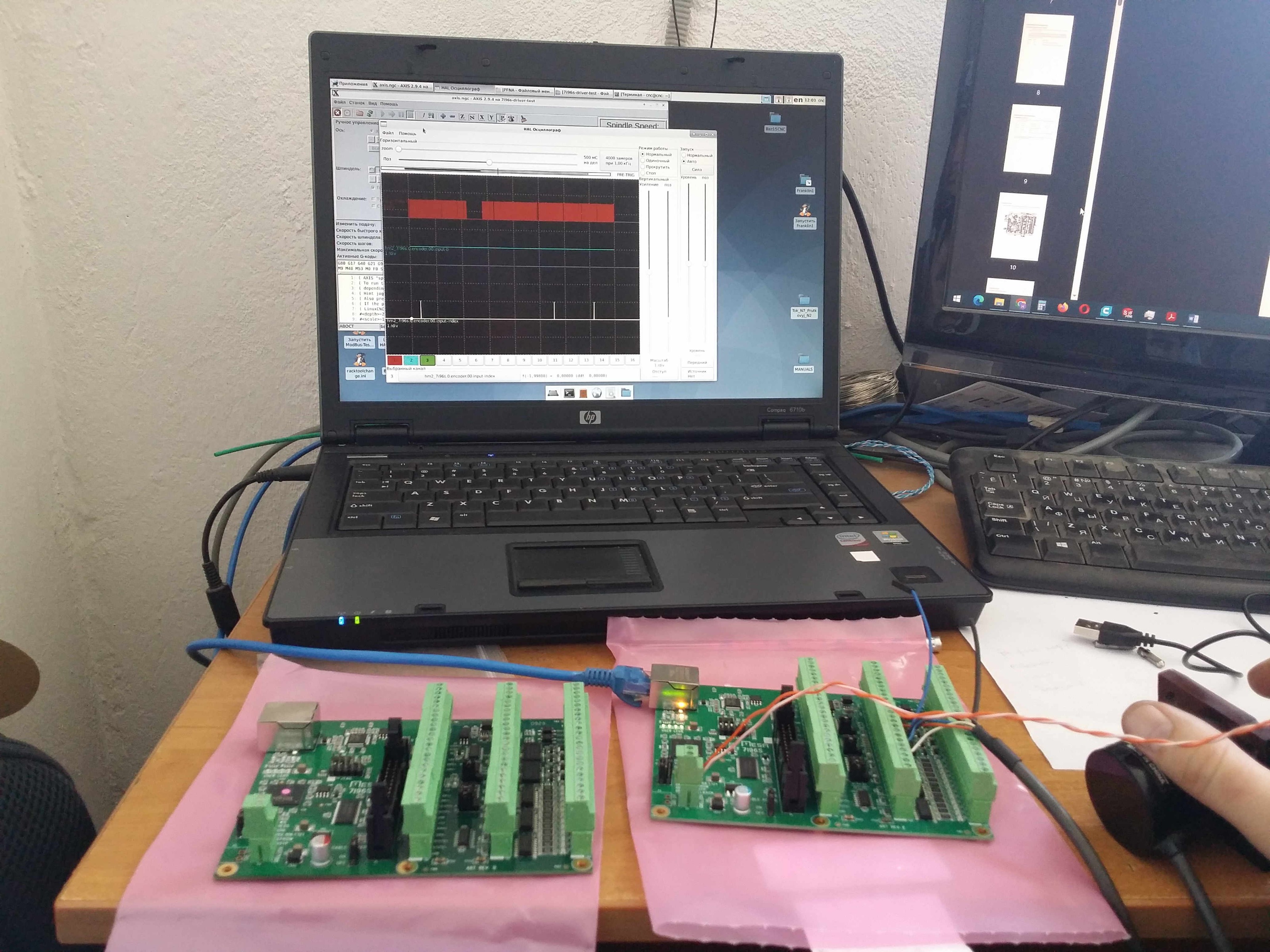

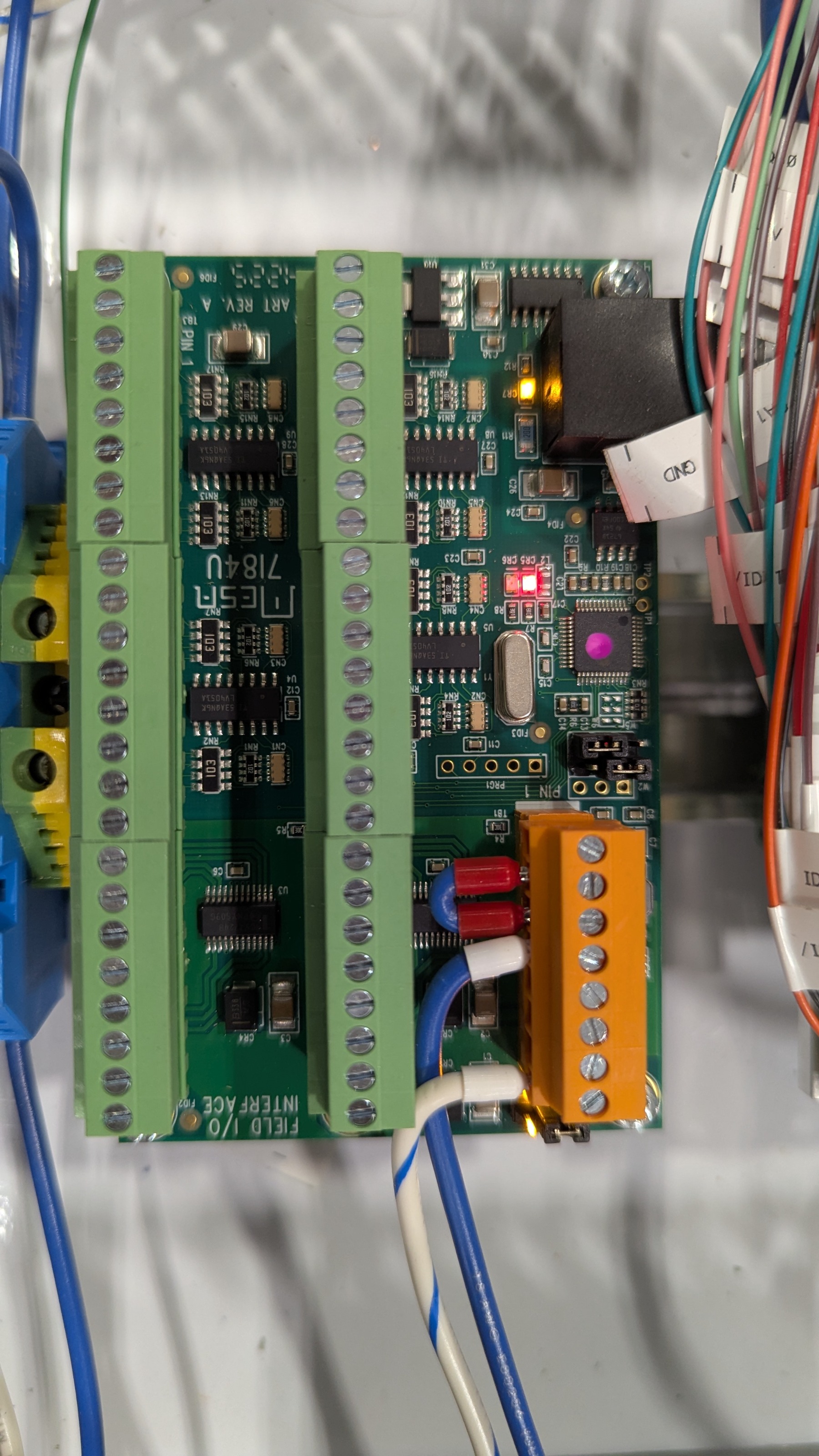

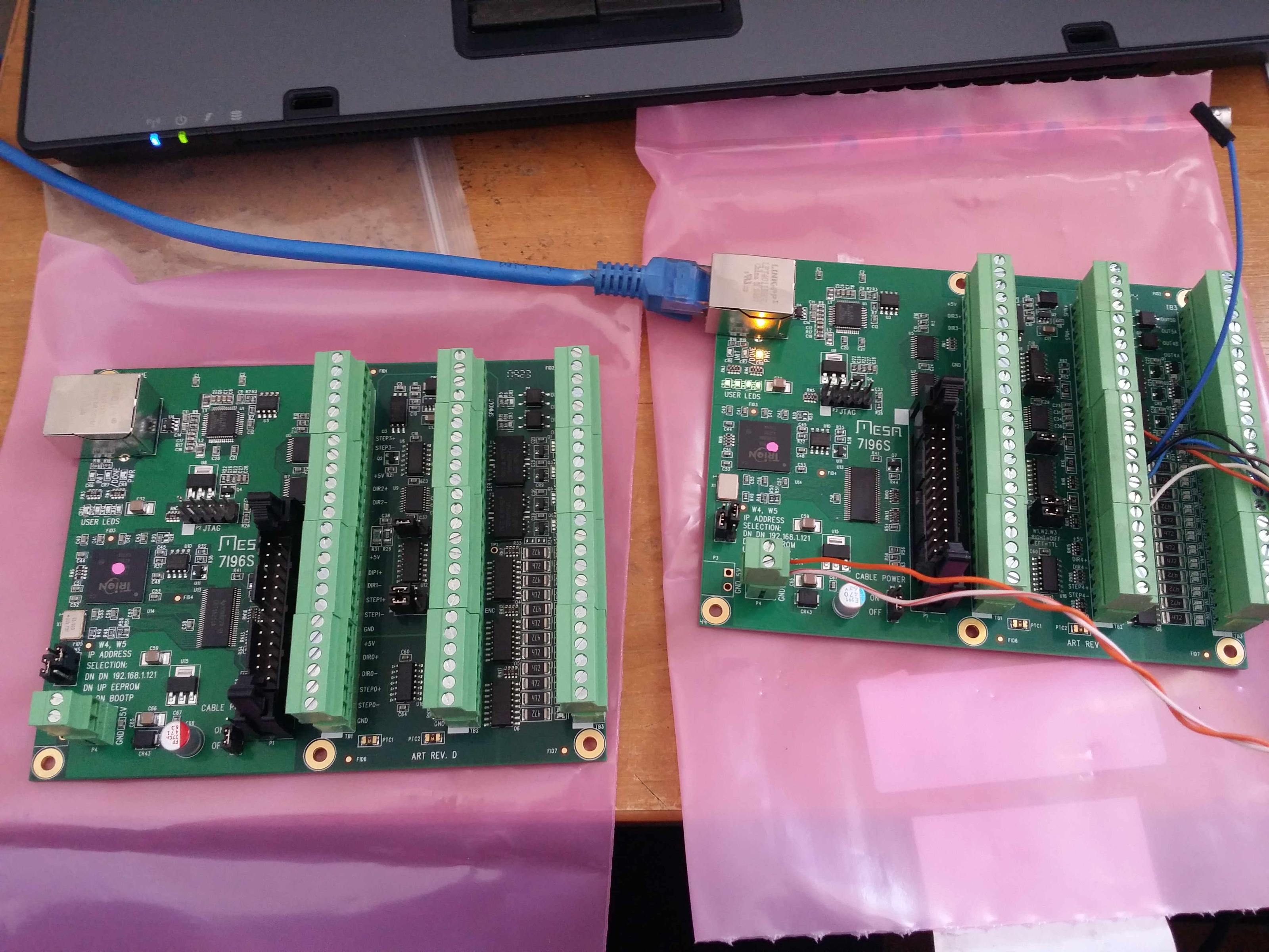

Today 21:13
7i95T PktUART: no usable TX output with either official bitfile
Category: Driver Boards
Hardware: 7i95T **rev A** (Efinix), LinuxCNC 2.10.0~pre0.6386.g3cd702c690
(buildbot deb), `hm2_modbus` + `mesambccc`. Slave: Delta C2000 VFD, 19200 8E1
RTU, address 1, parameters verified on its keypad.
Wiring per the 7i95T manual for 2-wire RS-485: TX+↔RX+ / TX−↔RX− bridged,
SG+/SG−/SGND to the drive, end-to-end continuity checked, bias resistors
fitted (2×2k2 to +5VP/GND), termination tried both ways (W23, rev A), both
polarities tried. A 7i84 runs error-free at 2.5 Mb on either serial port, so
transceivers, connectors and cabling are known good. A Saleae logic analyzer
at 24 MS/s sits directly on the RS-485 pair.
I believe I found three independent problems. As far as I can tell from the
forum, nobody has ever reported a *working* hm2_modbus setup on a 7i95T
(threads 51956 and 52858 both end without a success report), which would be
consistent with the following:
**1. TX drive enable polarity is not honored.**
Both official bitfiles (`7i95t_1v3pkt.bin`, PktUART v3 on serial 0, and
`7i95t_1pktv2d.bin`, v2 on serial 1 — md5-identical between mesact 2.1.8 and
the current mesanet.com 7i95t.zip) declare the TX enable pin as sec_pin 0x2,
which pins.c names "Drv Enable low". The hostmot2 driver never applies that
polarity: out of the box the RS-485 driver is **never enabled during
transmission** and the bus stays completely silent. Workaround found by
experiment: `setp hm2_7i95.0.uart.00.tx-drv-en.invert_output 1` — after which
the drive enable does toggle (visible on the analyzer). Should the GPIO
inversion be applied automatically by the driver from the sec_pin type?
**2. With DE fixed, no serial data ever appears on the line.**
Whatever is sent (hm2_modbus frames, or bytes pushed directly into the TX FIFO
via the raw interface at 0x6100 + sendcount at 0x6200), the analyzer shows a
**single solid low pulse per transmission, never a UART bit pattern** — even
for 0x55 payloads that should produce a dense alternating train. Pulse length
for an 8-byte frame is ~550 µs, which is ~88 bit-times at ~160 kbit/s, i.e.
about 8× the commanded 19200 (TX bitrate register readback is 483 for a
commanded 2304 baud, consistent with rate = baud × 2^24 / 80 MHz on the driver
side). So it looks like the serializer runs ~8× too fast AND the data path to
the TXData pad is stuck low during the burst. The slave never decodes
anything; the drive's own receiver decodes our DE edges as occasional 1–2 byte
ghost frames, which is what hm2_modbus then reports.
**3. The TX module eventually locks up entirely.**
After a series of hm2_modbus reloads and raw FIFO writes, the transmitter goes
completely dead — no pulses at all, not even via raw register writes — while
the watchdog has not bitten and all other functions (sserial, stepgen pins,
encoders) stay alive. Persists across hm2_modbus reloads; not yet re-tested
across a power cycle.
Also possibly related: at load time the "Drv Enable low" pin is listed on
implausible connectors (`TB3-16/TB3-17` for 1v3pkt, `TB4-22/23` shared with
TXData for 1pktv2d) where the .pin files say "Internal".
Has anyone ever seen the Efinix 7i95T PktUART actually transmit? Is a fixed
bitfile possible? Happy to test anything and to produce fresh analyzer
captures on request — this is for a lathe retrofit where the spindle VFD was
planned on this port.
