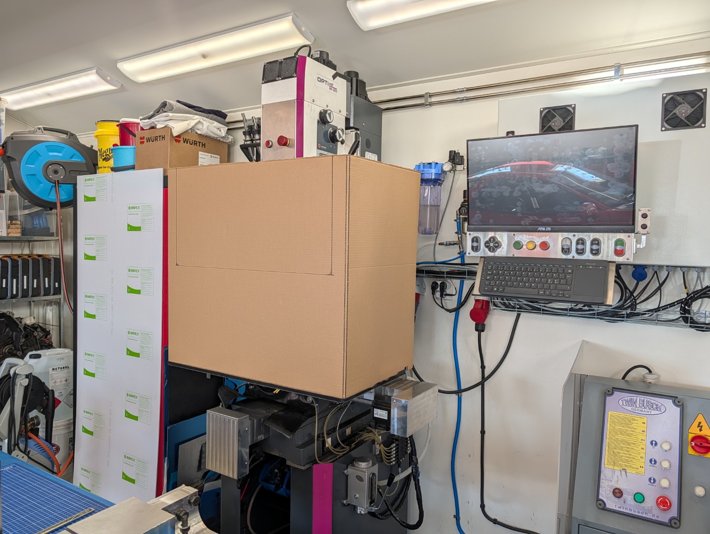

In order to fit the new spindle I'm gonna have to replace the whole head of the machine. So I designed a two piece design with an adapter plate that bolts on to the stock Z-axis.
The reason why I did it in two parts is to be able to reuse the head itself when I move on to a larger machine frame some time in the future.
As the 120 mm hole in the head the for liquid cooled spindle needed to be made with very high precision I opted to have the parts made for me. This also enabled me to have the critical surfaces ground flat at the same time.
Here are the machined parts as they where delivered to me. Visible on the left side is also the pneumatic air cylinder I managed to find eBay.
I try to avoid hydraulics as much as possible and so I was very happy to find a used stacked four stage 100 mm Festo pneumatic air cylinder for a very good price. It should provide enough force to release the drawbar in the new spindle at 8 bar of air pressure.
Here is how I have planned the milling head to looks with everything installed (with and without the top cover).
I 3D printed a test piece of the front button panel just to test the fitment and I think it came out okay.
I've created 19 different CAM programs to make all the remaining parts from aluminum which kept me busy for a while.
In order to reduce the load on the spindle bearings I'm going attach the mount for the pneumatic air cylinder with springs so that the majority of the clamping force goes in the to the drawbar instead of the bearings. Hence the slightly more complicated setup compared to my old setup.
