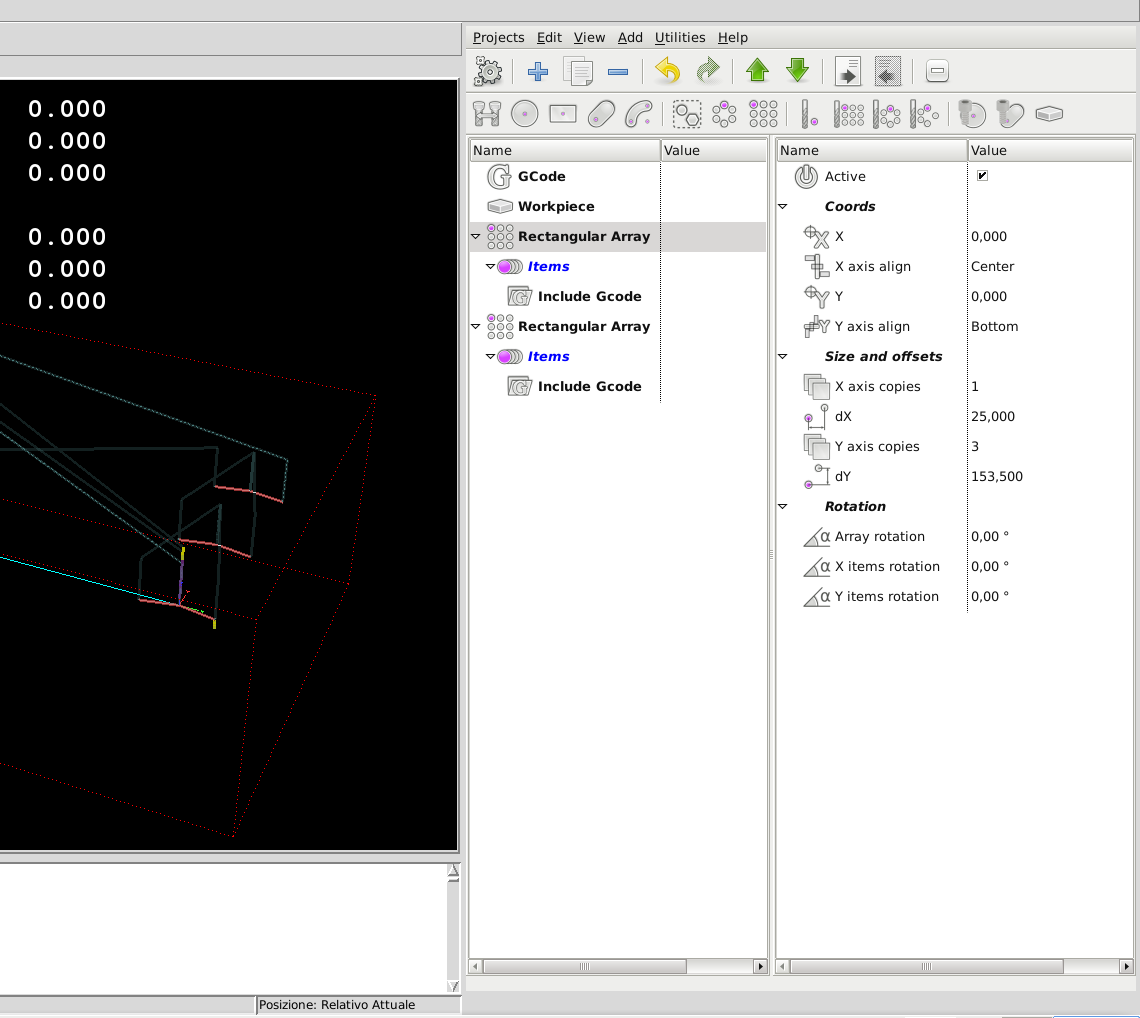

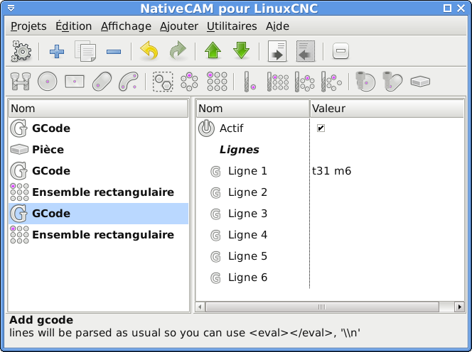

Yes, my toolchange is in the first line of each included Gcode.
Ex:
Project-
File Attachment:
File Name: Arrays.xml
File Size:24 KB
First included Gcode-
File Attachment:
File Name: ARRAYPROVE.ngc
File Size:0 KB
Second included Gcode-
File Attachment:
File Name: ARRAYPROVE2.ngc
File Size:0 KB

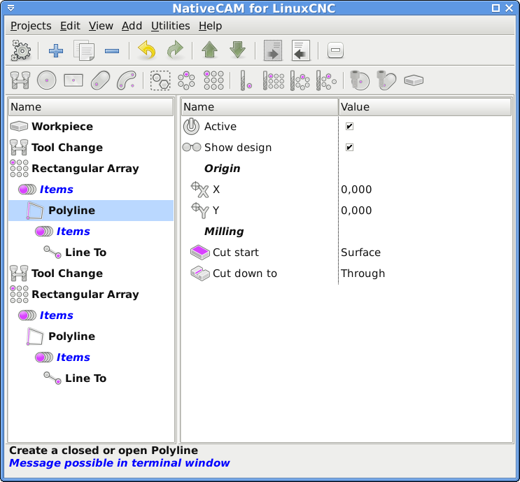

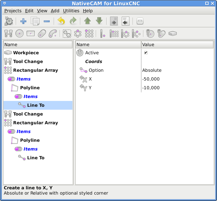

Hi Floris,
Though 't3 m6' is called on each loop (3 times on each Array) I do not think this is the problem.
Maybe it is the fact that you end ARRAYPROVE.ngc with 'g0 z2' but I was unable to clearly identify it.
So I created a project that does the same and I would like you to try it.
A few screenshots (many parameters have been hidden for clarity) and explanation how I did it.

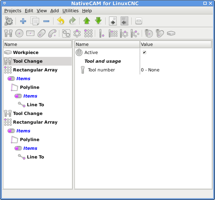

I inserted a 'Tool Change' and select tool number
There is no change with the 'Rectangular Array' but I added a 'Polyline' instead of inserting a file since we only want to cut a simple line. I setted the starting point / Origin and the Milling options are up to you.
I added a 'Line To' and setted the end Coords
I duplicated the 'Tool Change' and moved down the last place. Tool number should be 31.
However even if you have a special macro to change the tool, 'Tool Change' should work fine since it calls 'T#param_dnum M6' if and only if mounted tool is not #param_dnum
I duplicated the 'Rectangular Array' and moved to last position and changed the X Coord of the 'Line To' to 50
Note the 'Polylines' are not closed.
Please tell me if it still cause the same situation so I can have a better understanding of the problem.

11 Jul 2017 20:10 #95695 by FernV
Replied by FernV on topic NativeCAM is Features renamed
...I think the problem only appears on the last "included gcode" file of the array with the tool change on its first lines.
Floris,
To make sure that 'm6' is executed only once, modify the first line of your included files like this
o100 if [#5400 NE 3]
t3 m6
o100 endif
and
o100 if [#5400 NE 31]
t31 m6
o100 endif
Fern

12 Jul 2017 12:01 - 12 Jul 2017 12:23 #95719 by FernV
Hi Floris,
I spent much time testing and I really think tool changes should NOT be in arrays (they are in included files which are in Rectangular Arrays which make repetitive mounting and resetting tool length each time).
This way should not cause issues and tool length compensation will be applied to G54.
Fern
Last edit: 12 Jul 2017 12:23 by FernV.

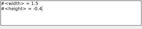

Hi Floris
For very short custom gcode, I updated 'Custom GCode' and you can add any number of lines in it. Just hold Ctrl or Shift while pressing Enter to add a new line.
Fern
