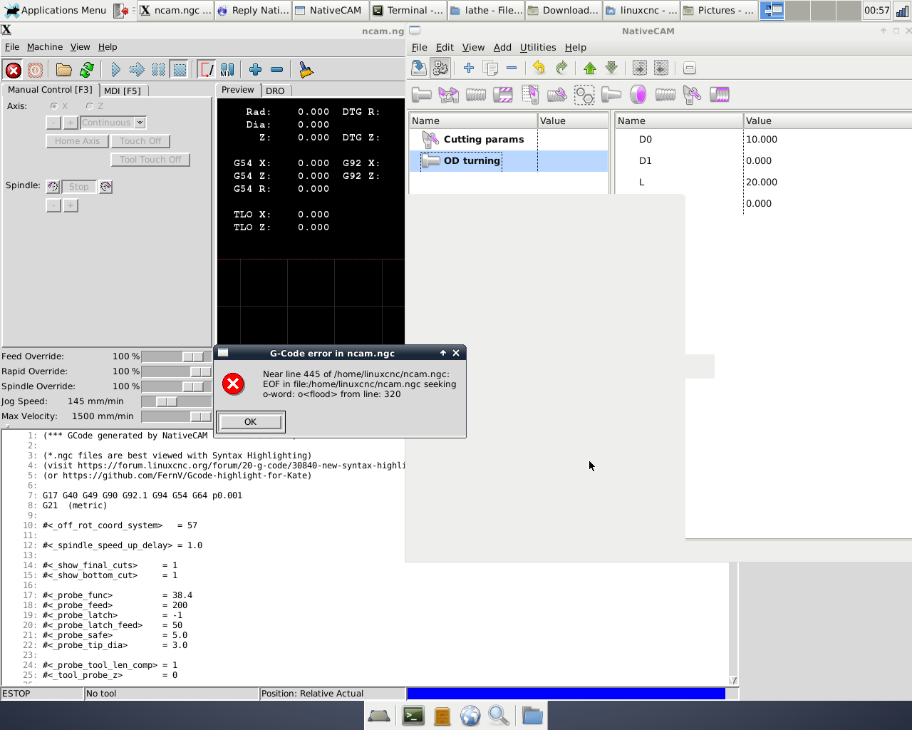

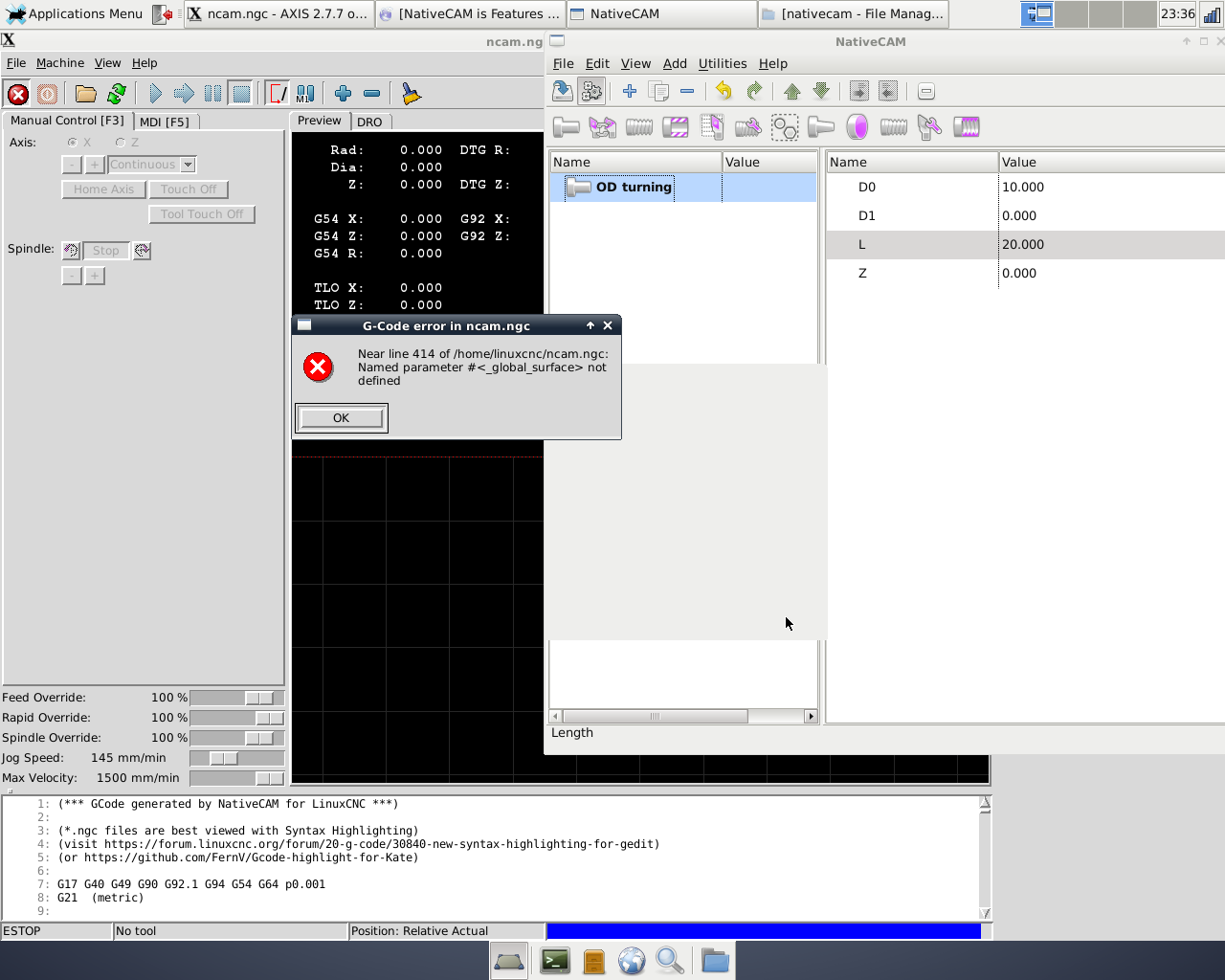

I am trying to test the lathe routines for OD turning and I get the error that can be seen in the attachment.
Where do I need to add that global_surface?
I've tried to add a cutting params before the OD turning and this seems to fix the global_surface error but next I get the second error, something about flood. You can see it in the second error message.
Not sure how to fix this so if anyone can give any suggestions, it would be welcomed. Once I figure this issues out, I will add a pull request with the lathe related changes.
I've also attached the ncam.ngc file so that you can have a look over it if needed.

You always have to set parameters firstI am trying to test the lathe routines for OD turning and I get the error that can be seen in the attachment.
There is a call to a subroutine named <flood> but it does not exist in the file. If not founded, simply comment the line and continue your tests without floodbut next I get the second error, something about flood. You can see it in the second error message.
Fern
