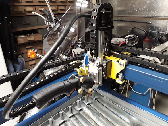

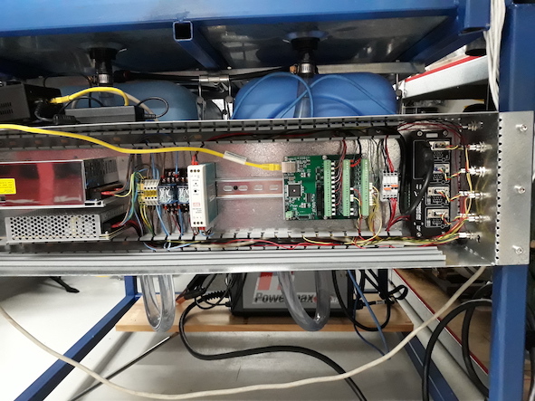

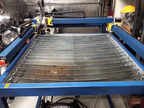

Some pics of the table. Excuse the cables drooping everywhere, like I said earlier there is a lot of tidying up to do.

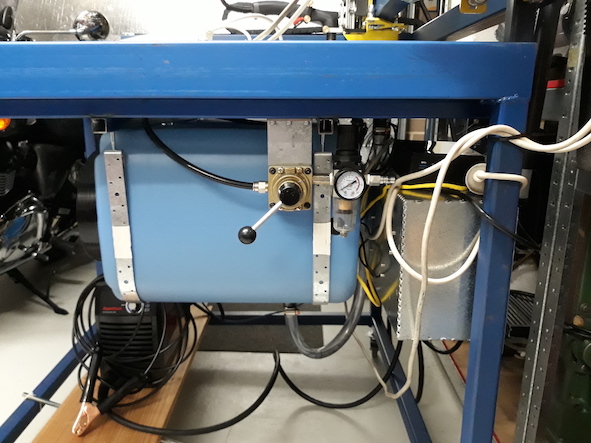

The two drums hold a total of 60 litres and the water is pumped up with air pressure and drains with gravity. As you can see I am pressed for room in the single vehicle garage. Cutting will be done outside so the table will be filled and drained for each session. It takes about 2 minutes to fill and about three to drain.
I have gone against the majority recommendation and directly wired the torch switch to the 7i96, it is only switching 18V and I have faith in PCW's design (plus a few spare inputs). So far so good.

Thats a tidy little table Phill,
I was going to go with a compressed air water height on mine but I changed my mind after making the first tank as I was worried that pressurizing a large steel tank could kill someone if any of the safety valves failed. I ended up with a 1000 l/m pump instead.
But on a smaller table it makes sense to use air pressure.
Is the table on castor wheels?

30 Sep 2019 08:12 #146690
by phillc54
Yes, it is on castors.
The pressure for the water is only 1.5 - 2 bar.

30 Sep 2019 08:19 #146691
by thefabricator03
Replied by thefabricator03 on topic Another plasma component...
My problem was I did not consider the safety factor of having a untested pressure vessel used in a workplace. Getting a tank 3000x1500x300mm tested is not cheap.
And a small amount of pressure over such a large area can cause problems. Especially if it were to pressurize up to our shop air pressure of 110 PSI.
But for a hobby machine is makes perfect sense. Especially when your the only one using it and you know what your doing.
- phillc54
- Posts: 5711
- Thank you received: 2100
30 Sep 2019 08:47 #146694
by phillc54
I will be the only one using it but I'm not sure that I know what I'm doing.
When I get the water to the correct level I unplug the air to be safe.
I can understand your concerns.But for a hobby machine is makes perfect sense. Especially when your the only one using it and you know what your doing.

Looks good Phill. I had a setback with my watertable as it had a leaking weld. I got as far as putting the tray in the back of the ute but had no time today to go and get the boys to reweld it (after all, I paid them to do it).
I've kinda half been looking for a tank of some kind but it needs to hold around 125 litres minimum.
