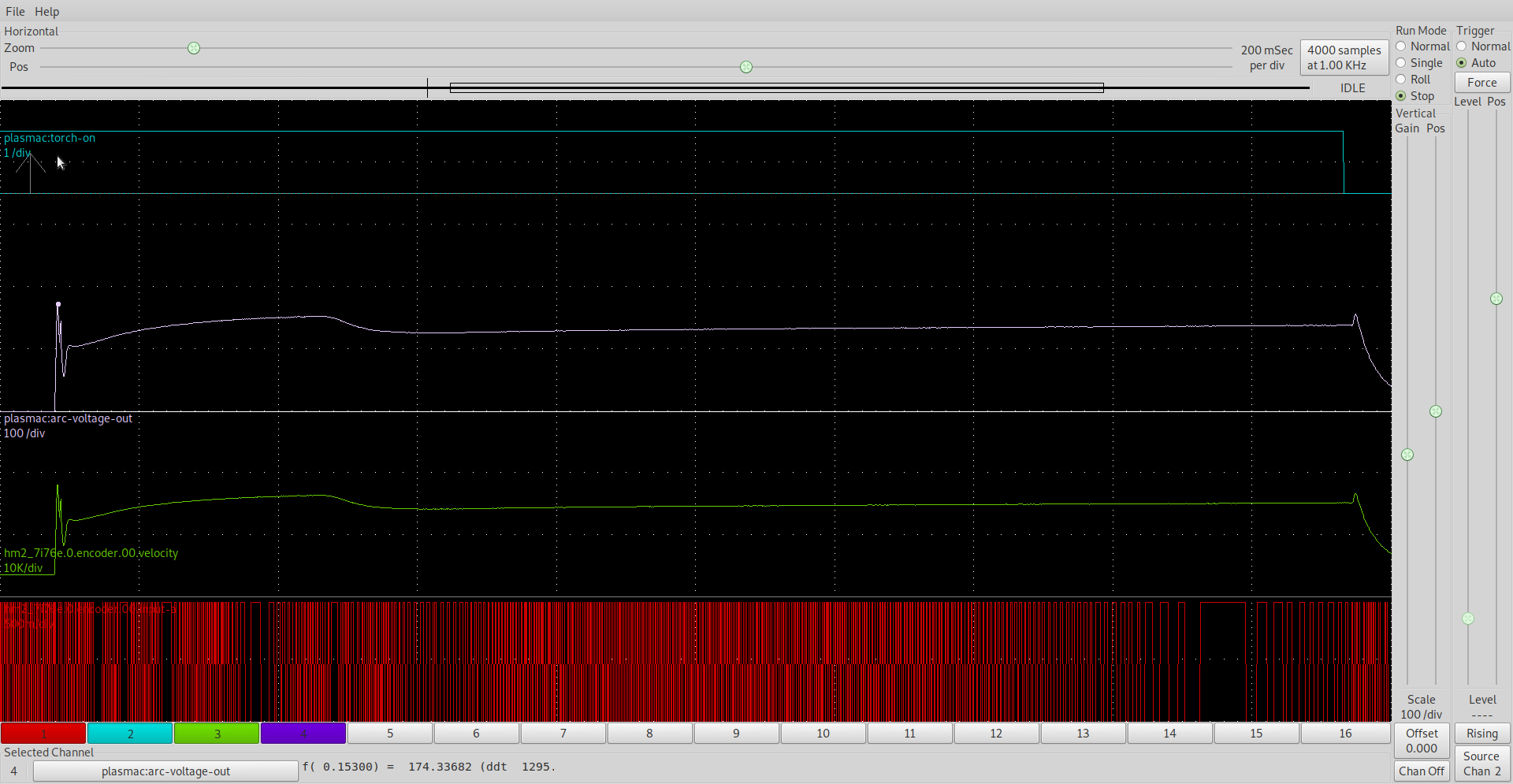

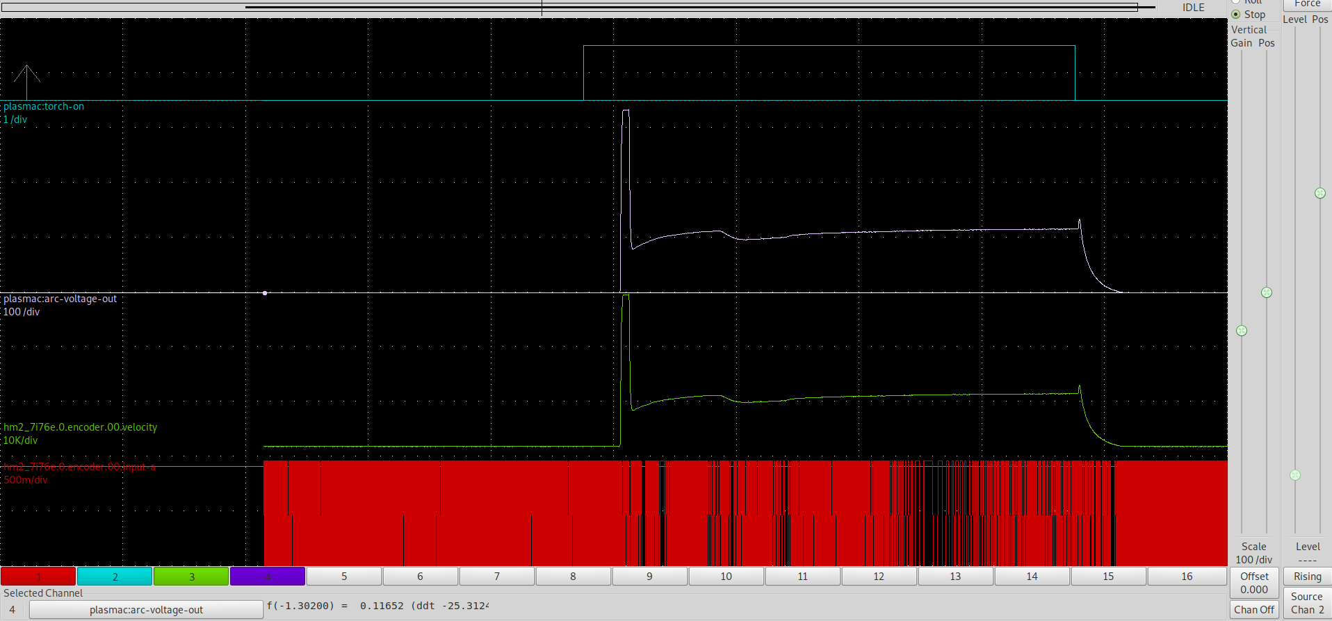

325V is more down to earth, but still i have suspicions that the burned lines on the board are not wired properly so it is reading more than it should.

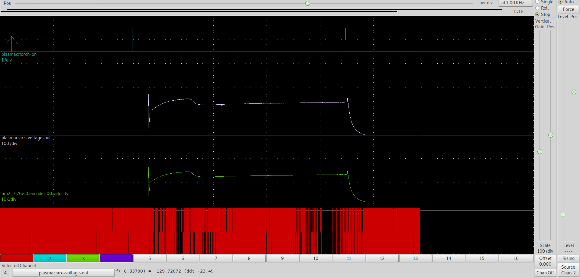

I see on you first plot that arc voltage went up to 325V, is that what you see on a meter?

on the meter I don't pick up the peak , since it is to slow ....just when it is about 160V

You probably don't need to plot encoder input or encoder velocity, but you could plot Plasmac:arc-ok-out
If you get a long enough arc, make sure the arc voltage reads what your meter shows.
