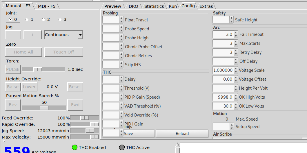

Phill,
another stupid question how can I get all the settings ..mine is empty now...sorry..for the trouble..
Last edit: 29 Mar 2020 10:04 by CNCFred.

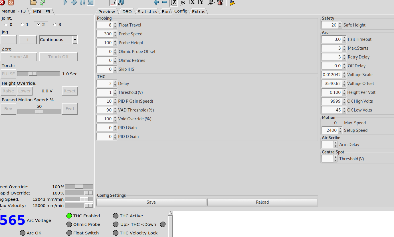

29 Mar 2020 10:07 #161935 by phillc54
Wow, that is strange. I have not seen that before. This post forum.linuxcnc.org/plasma-laser/38636-va...ride?start=10#161197 should be close.
One other thing from you last plot the arc drops a fair bit after the fisrt pulse so you probably need to set Arc OK Low a bit lower than that, maybe 45V.

29 Mar 2020 10:12 - 29 Mar 2020 10:13 #161937 by CNCFred
?should I close that? sorry...
you could close this one if you like, sorry I am not familiar with all that ..forum stuff...
Last edit: 29 Mar 2020 10:13 by CNCFred.

29 Mar 2020 10:29 - 29 Mar 2020 10:30 #161940 by CNCFred
phill ,
I set touch off ..z to 0
then I do a probe, works adjusted float travel 1mm above material
(still don't know where plasmac knows the distance torch to triggered float switch)
then I do a dry run, the torch lowers , like on a probe works , then starts to move like for a cut and dives into the material...
so I set float travel higher (thought that is offset of torch to material for probe when piercing height)
something still not right with my config...entered all values (max speed is 0) and
volts is showing permanen voltage...scale and offset entered...
phill, thank you for your time!!

29 Mar 2020 10:35 #161942 by phillc54
Use the Probe Test to set up your float travel.
When you press Probe Test it will probe down then retract to Pierce Height and wait for the time set in the in file. Measure this height while it is waiting and change the Probe Height by the difference between Pierce Height and what you measure. Repeat this until it stops a Pierce Height.
You don't need to touch off with PlasmaC.

29 Mar 2020 10:42 #161944 by CNCFred
at least I got the Pierce Height right :-) oh meeeeee
so 8 mm I set is right to get the 4mm Pierce Height on mine.

29 Mar 2020 10:45 #161945 by CNCFred
Dear Phill,
got to apologize again, reloaded plasmac_config.py again and now also my old values are there and voltage to 0 as it should be..
29 Mar 2020 10:49 #161946 by phillc54
That is good if 4mm is what the Pierce Delay is in the Run Panel.
Do you have mixed configs there or something, I just notice on your last screenshot there is an Off Delay in the Arc section, that was taken out on January 4.
Are you using a package install from Buildbot or a Run In Place install?
