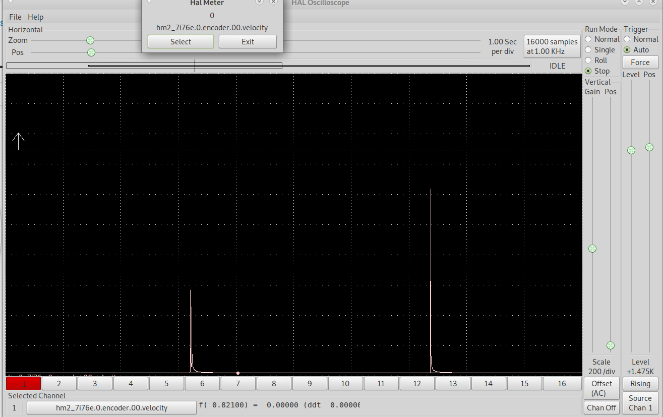

To test the current state of the equipment, connect the thc to the mesa, DO NOT connect the plasma side, power up everything, start Linuxcnc, open halsope or halshow and monitor the encoder.0.velocity pin, now touch the outside of the upper most resistors when looking from the plasma input side. Check if the scope changes value and stays so so stable. Should be enough to move the scope a bit if everything is OK.
Report back, with screenshots.

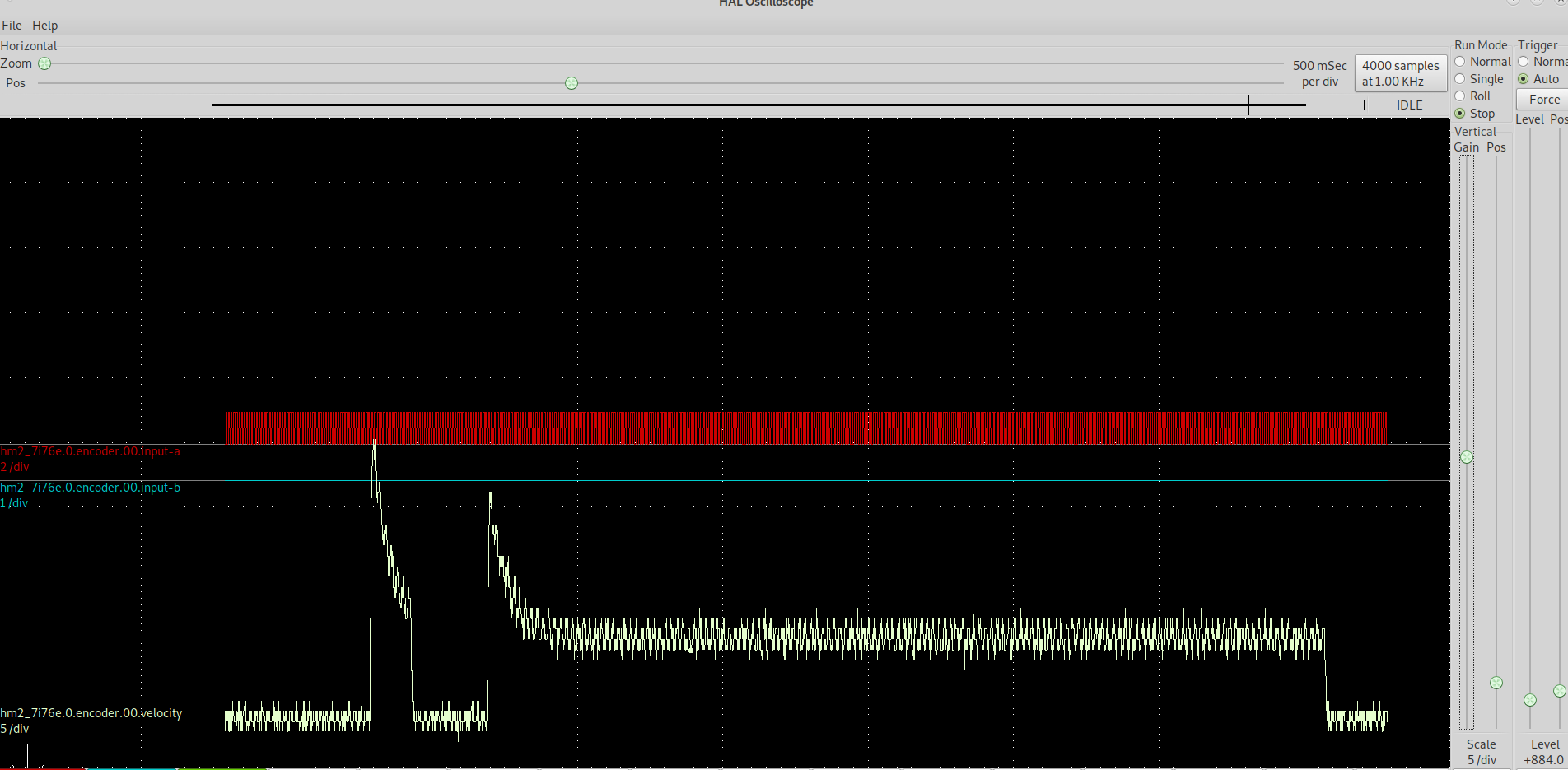

24 Mar 2020 11:01 - 24 Mar 2020 11:07 #161340 by CNCFred
yes, using the voltage before the 20kv, 20Mhz for the pilot arc are induced like on a tesla coil ,would have been best.:whistle:
I will find that out, it is a chalenge.
Tom:
I tried to put my fingers on the resistors but no reaction...encoder.0.velocity stayed
So then I didn't care anymore and I disconnected the thcad300 and reconnected so I saw once a peak...
either way all broken or not :
My 7i76e so far works , have still to check the encoder or try firmware upgrade(change) to get another encoder working with a new tcad(;) RODW secret)
Last edit: 24 Mar 2020 11:07 by CNCFred.

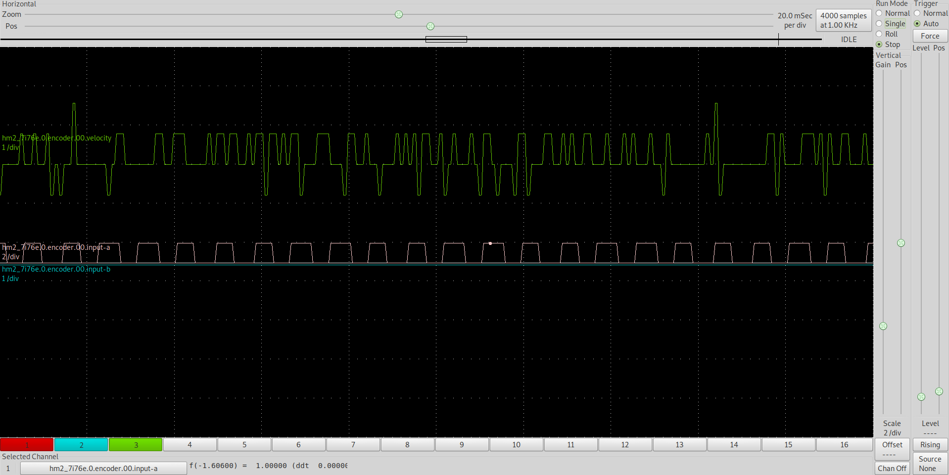

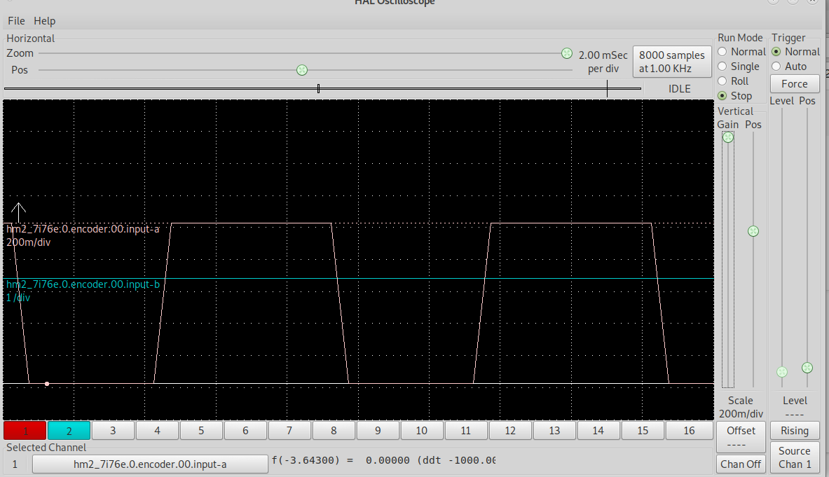

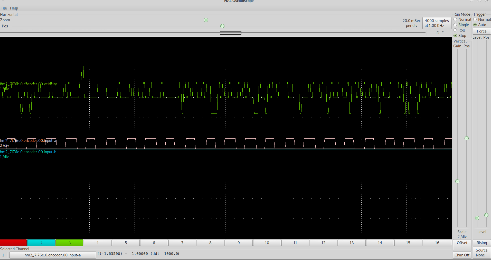

24 Mar 2020 12:26 #161345 by tommylight
I can not see what is going on at the bottom, but can you please do the same thing with halscope like so:
Set the THCAD to 1/128 with the jumper, connect it to 7i76 and do a halscope for encoder.0.input-a and encoder.0.input-b.

24 Mar 2020 14:10 #161350 by CNCFred
this is what I get, no matter touched or untouched!! unfortunately
thank you Tom, I fear all dead
thcad blinks steadily....has two leds on...

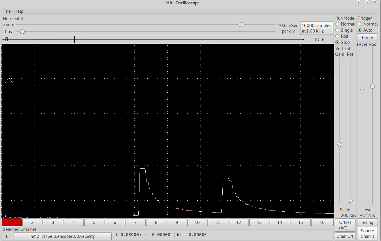

24 Mar 2020 14:30 #161351 by CNCFred
no I also see something on the velocity with f/128
not touching the resistors
with touching ...but does not tell me anything
input b does not show anything
thank you!!

24 Mar 2020 14:42 #161352 by CNCFred
touching with the resistor measurement I can produce that..
eg. I think some voltage is applied
