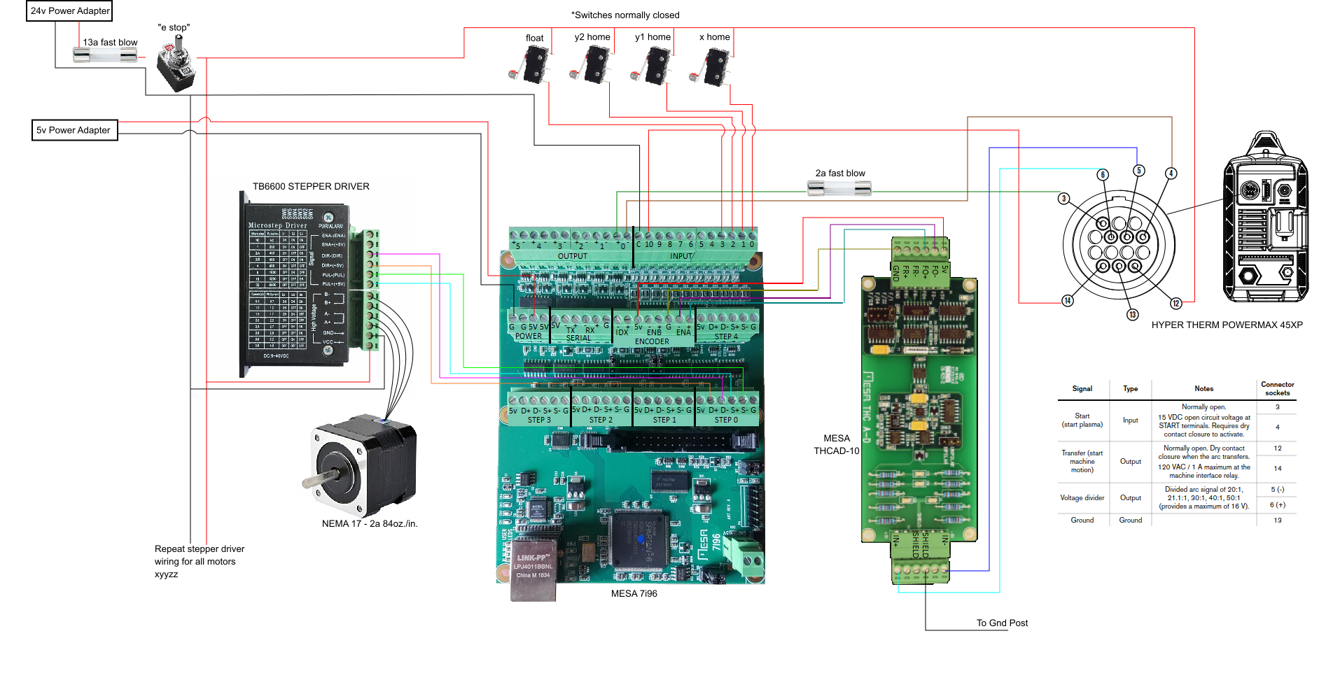

No, what you had is correct, you are just closing a contact, and the SSR works (I just helped someone set their table up this way very recently). However, it is possible to get it backwards because the hypertherm is flowing electricity to complete the circuit and you probably aren't biasing the SSR correctly. Try reversing them from what you had.
The guy I helped used this diagram:
Edit: The 7i96 does light up when you activate the output. Make sure you have the address for the SSR correct. should be:
Replied by snowgoer540 on topic Help with homing on dual axis PlasmaC
I have a brain fade.. re 7i96
On a Hypertherm 45xp the torch start wires are green and black the manual states dry contacts
I have connected them to hm2....ssr.......7i96....00 output this does not fire the torch.
Do I have to put 24V on pin 14+ and then connect green to pin 12- then black to gnd
hm2_7i96.0.ssr.00.out-00

Yes thanks I did have it correct but the plug was wired incorrect. the green and black turned out to be red and black. Go figure:(
Thanks for the confirmation.

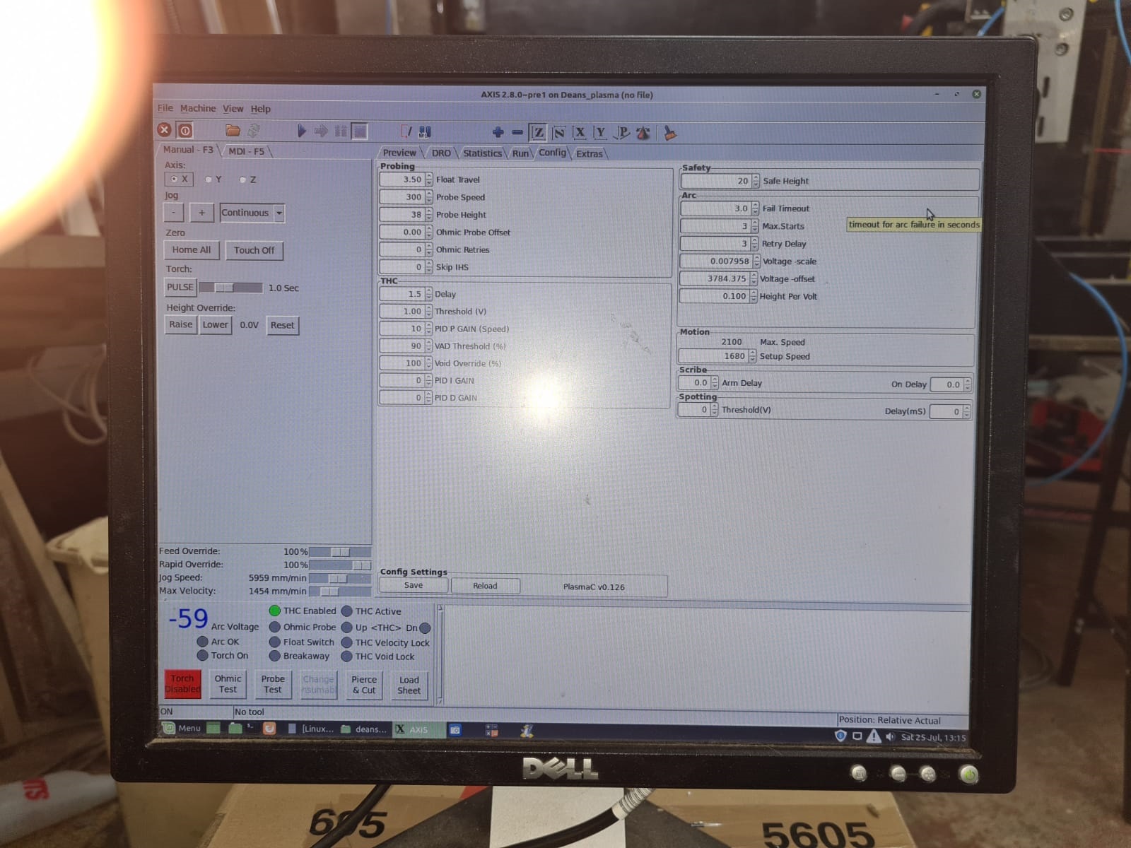

Question
I am setting up this 45xp with it set to 20:1 it is showing -50V in plasmaC when cutting it is showing 135V and the THC is not working
Any suggestions?
Any suggestions?
- phillc54
- Posts: 5711
- Thank you received: 2100
25 Jul 2020 12:03 #175729
by phillc54
Replied by phillc54 on topic Help with homing on dual axis PlasmaC
What are your settings in the config panel.
What is THC doing or not doing, is it enabled in the run panel and the cut parameters?

25 Jul 2020 12:38 #175732
by Clive S
Phill I am trying to do this remotely .
The THC is not adjusting the Z As you can see it is showing -59 when idle and about 140V when cutting
Replied by Clive S on topic Help with homing on dual axis PlasmaC
- snowgoer540
- Posts: 2580
- Thank you received: 907
25 Jul 2020 12:48 #175734
by snowgoer540
Looks to me like your offset and scale could be off. Which THCAD are you using? Can you post your 0v and max volt frequencies? Also, jumper setting on the THCAD? At least that way we could verify your settings.
- Clive S
- Posts: 2204
- Thank you received: 486
25 Jul 2020 12:53 #175736
by Clive S
Looks to me like your offset and scale could be off. Which THCAD are you using? Can you post your 0v and max volt frequencies? Also, jumper setting on the THCAD? At least that way we could verify your settings.[/quote
THC-10 0v = 116.4 10v = 965.3 jumper 32 Plasma set at 20:1
I get this to be Scale 00753917 offset to be 3637.5
