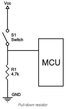

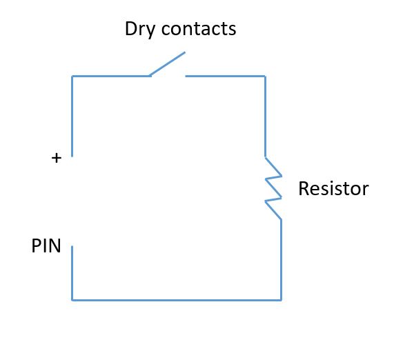

03 Sep 2020 14:09 #180549 by snowgoer540
Replied by snowgoer540 on topic Random arc signal lost
So the solution is to add a pull down resistor to the ArcOK input. This resistor has to be sized to ensure the minimum current is exceeded and can also handle the power in the circuit (Watts). In my case, I was able to locate the relay in the Everlast and track down the data sheet. The minimum current rating was 100 mA. My advisory panel crunched some numbers and announced that I should use a 1K, 1 watt resistor from the input to my 24V field power ground. They said to keep the resistor up in the air as it could get very hot!
I'm not really sure I follow. It would help to see where you placed the resistor in your circuit for this.
It's my understanding that a pull down resistor by definition will not add current to the relay contacts as you are describing, it will just pull the voltage on the pin to ground to ensure that the pin stays low (see picture below). The only way I could see this helping is it may prevent the pin from floating as much while changing states.
I would think the only way to add current to the relay would be to put the resistor in series with the circuit. Like this:
At any rate, I wonder if you could have also solved this problem by debouncing the input signal... a little coding :)
03 Sep 2020 14:18 #180550 by rodw
Replied by rodw on topic Random arc signal lost
The first one. Just put the tail of a resistor in the input screw terminal with the arc ok signal wire and connect the other end to GND. Some current will flow through the resistor and therefore increase the current flowing through the dry contacts.

03 Sep 2020 16:44 #180560 by tommylight
Replied by tommylight on topic Random arc signal lost
Those two pictures are the same exact thing, just attach the input to the upper side of the resistor.
