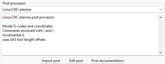

I still have the error “unknown word where unary operation could be” even when I output a .ngc file from SheetCam. I've test with the LinuxCNC plasma post processor for SheetCam. In Monokrom I am using the plasma_gcode_preprocessor (default with Monokorm). I have attached the pre processor log. There everything seems to work. However the LinuxCNC parser seems to be unable to read whatever the plasma_gcode_preprocessor puts out. The error comes from here: github.com/LinuxCNC/linuxcnc/blob/af15a4...interp_read.cc#L1424
Preprocessor log:

07 Nov 2025 20:41 #338048
Replied by tommylight on topic MonoKrom - QtPyVCP GUI for PlasmaC and Mill
It says LinuxCNC post processor but it does output line numbers with N, why?
Mach3 uses line numbers, not LinuxCNC, so try removing them.

there should be a specific post processor for Plasmac shipped with Sheetcam (before QTplasmac) Try it and read the file as there are notes at the top.
@Tommy, line numbers in linuxcnc are optional and Sheetcam has settings to generate with and without.

Replied by Sandro on topic MonoKrom - QtPyVCP GUI for PlasmaC and Mill
Yes I forgot to mention this. I have tested with the Plasamac postprocessor as well (the one I normally use with my QtPlasmac setup) with the same result. It works, if I deactivate the plasma_gcode_preprocessor in the Filter section of the INI but then I can obviously not use any of the advanced Monokrom features like hole detection.

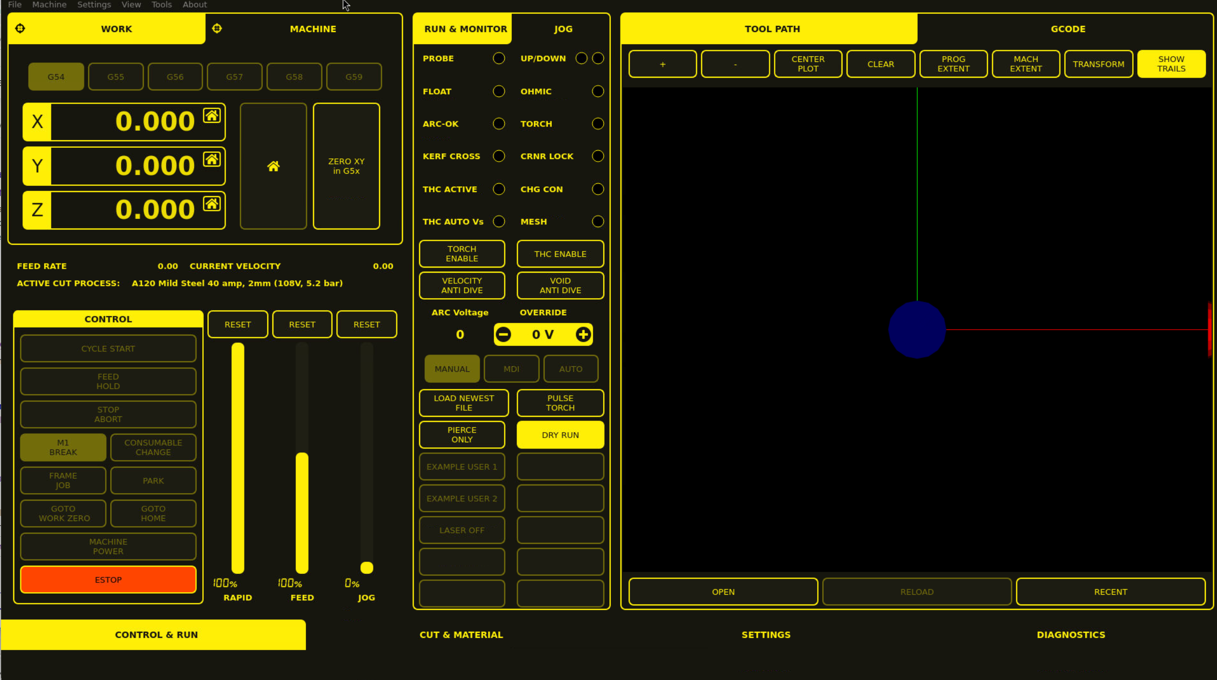

Replied by Hakan on topic MonoKrom - QtPyVCP GUI for PlasmaC and Mill
At least got it up and running.
1. Had to replace "import imp" in /usr/lib/python3/dist-packages/qtpyvcp/app/application.py
with "import importlib.util"
and on line 159
This comes from the python3-qtpyvcp apt package.
Is it qtpyvcp to blame or trixie that doesn't provide the imp module?
2. Missing [PLASMAC]SLAT_TOP in ini file. Added
SLAT_TOP=0.0 in PLASMAC section.
I guess it could be given a default value as is done for so many variables when they are missing.
3. Locale problems. <string>:1: SyntaxWarning: invalid decimal literal
Started linuxcnc with
and it gives me a Monokrom screen.
Edit.
The LC_ALL=C wasn't needed.
But this one needs attention:
and on line 159
#module = imp.load_source('python_vcp', pyfile)
spec = importlib.util.spec_from_file_location('python_vcp', pyfile)
module = importlib.util.module_from_spec(spec)
spec.loader.exec_module(module)This comes from the python3-qtpyvcp apt package.
debian@plasma$ LC_ALL=C linuxcnc xyz.iniand it gives me a Monokrom screen.
Edit.
Note: Using POSIX realtime
!!!!db_init: </home/james/dev/venv/bin/plasma_tooldbpipe> not executable
emc/task/taskclass.cc 169: can't initialize DB_PROGRAM.
emc/task/taskclass.cc 188: can't load tool table.
Last edit: 08 Nov 2025 10:17 by Hakan.
Yes, trixie uses python3.13. I guess it would be fine in bookworm with 3.11.
It turned out the tool_db issue was just a setting in xyz.ini. The tool program is in /usr/bin.
I have played around a bit and yes it looks very very nice.
The material handling looks awesome.
So I'll turn it into a real machine, for my plasma cutter.
