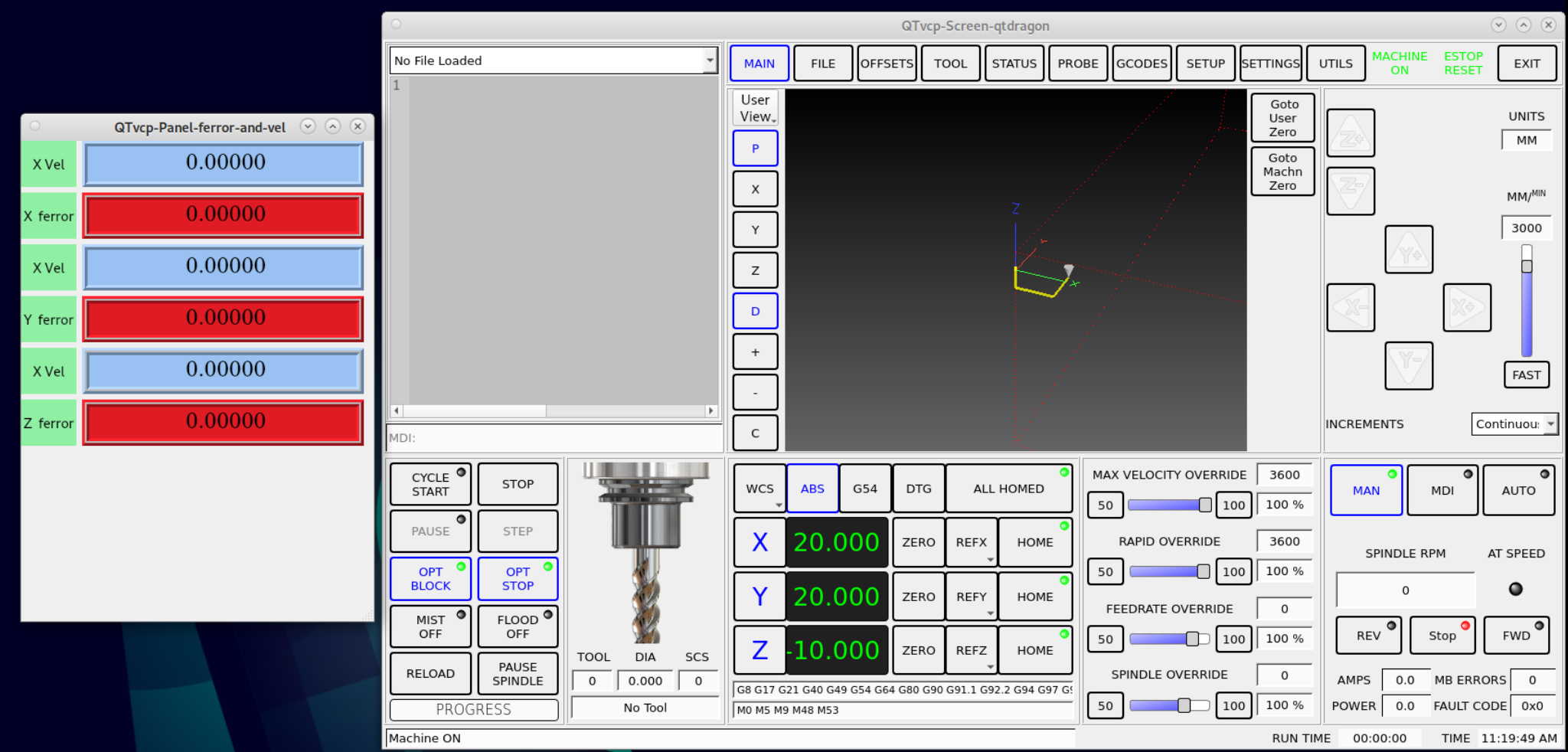

OK,
little help please. I have looked through all the docs I can find.....
where and how can I specify the size and location of each screen?
in the .ini ?
in the .pref ?
thanks in advance....
in the .ini ?
in the .pref ?

Hello! Can you share files panels? Thank you!

linuxcnc.org/docs/2.9/html/gui/qtvcp.html#_ini_settings
Also the panel you made can have it's size set in the designer editor.
Replied by cmorley on topic Error in tool_offsetview.py
I haven't tried these in a while but look here:OK,
in the .ini ?
in the .pref ?

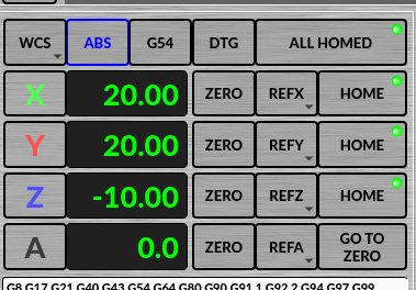

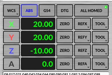

hello ChrisAfter the last addition of tool buttons, the DRO layout broke a bit. I made the appropriate corrections, and I'm sending you the corrected theme file as well.I also found one problem with the "DEFAULT_ANGULAR_VELOCITY" option from the .ini file, this option does not work. The slider of the A axis should be set to the appropriate position after starting qtdragon and it is always set the same, regardless of the set value.And above all, what progress with the validator, because it is quite a serious problem for some users?Marek

The validator changes to qtdragon were done quite some time ago.
Maybe I missed some needed changes for other widgets?
I'll update the theme and ui, thank you.
I'll look at that default angular setting.

Ok angular jog rate problem fixed.
Theme updated (thanks)
DRO layout fixed (thanks)
basic broke and facing should accept decimals now - please test and get back to me.
I'll work on the rest after you confirm all is good.
all just pushed to 2.9 and master ...
