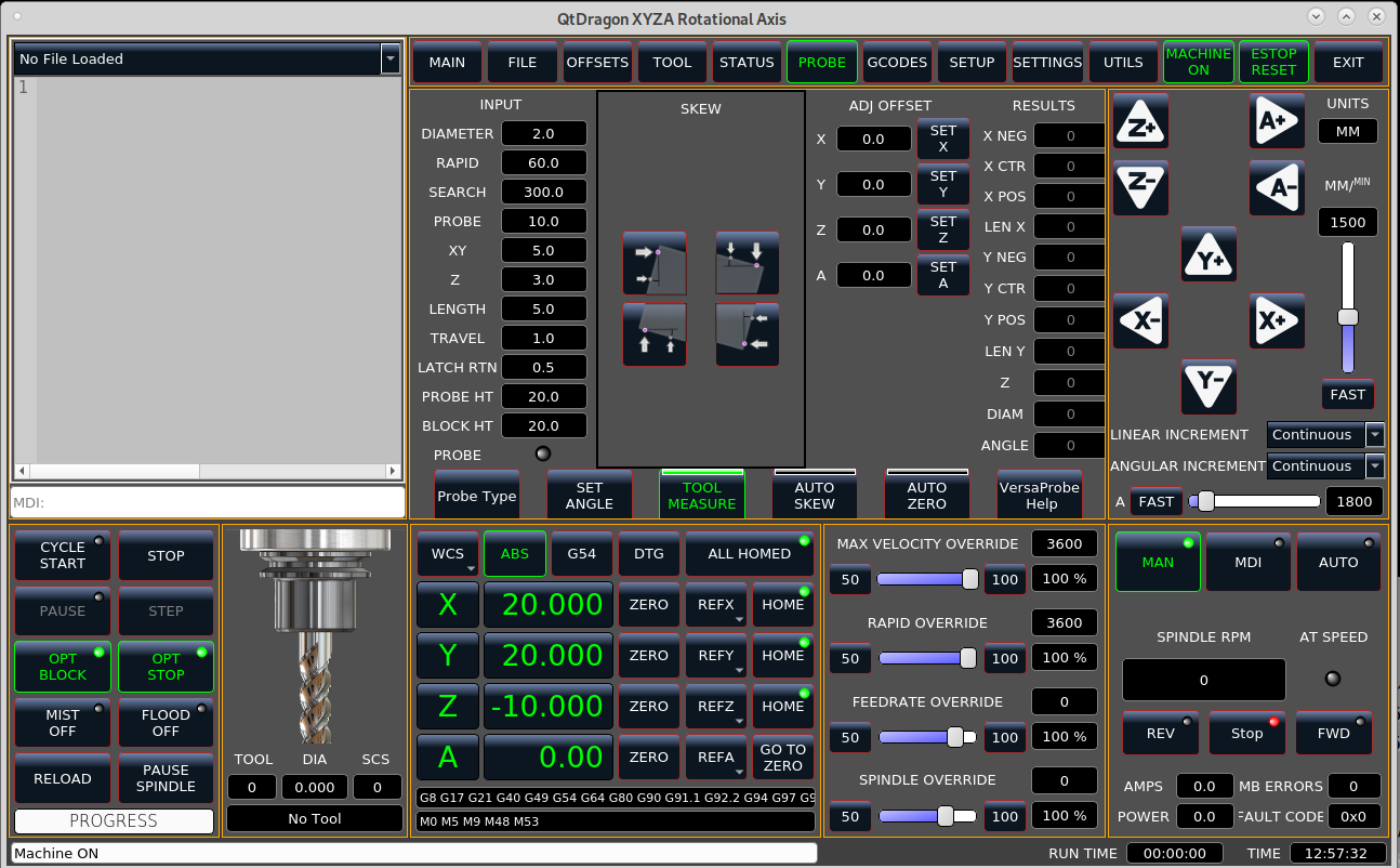

Replied by cmorley on topic Error in tool_offsetview.py
Roguish:
Stretchable widgets are good. I'm not a fan of your color choices but that can be changes with the stylesheet. In fact I would take the style sheet out of the widget and put it in the main stylesheet.
I just prefer more contrasting colors. As for the buttons I though having them apart would make it easier to hit the right one. having them together looks better.
I don't have a supper strong feeling either way.
Here is what Roguish 's changes look like (collapsed).
The help page shows what it was like.

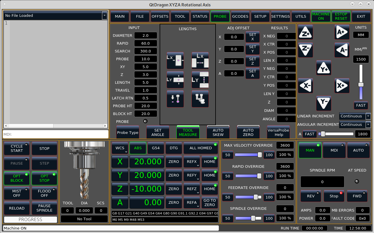

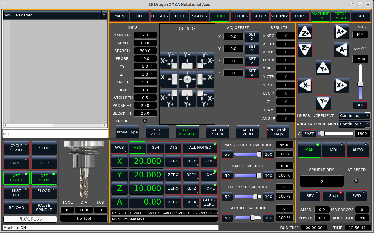

Variant versa_probe.ui.

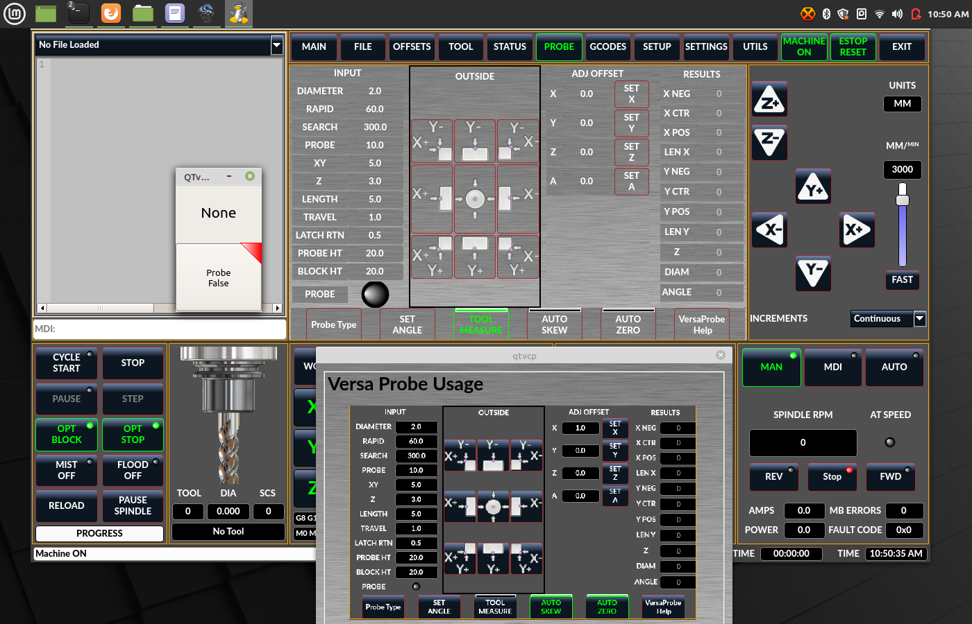

14 Jan 2023 15:05 #261945
by Roguish
Replied by Roguish on topic Error in tool_offsetview.py
Chris, I just took the versa_probe.ui out of the system share directory, and modified it to stretch. I did not intentionally mess with the colors. I definitely agree about the contrasting colors.
It would be nice if there were more examples of how to use the .css style sheets..
Versa_probe.ui has that little PROBE led. I have tried to add that to my side panel, and just can't get it to work. suggestions???
