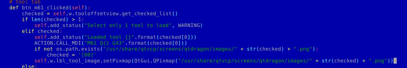

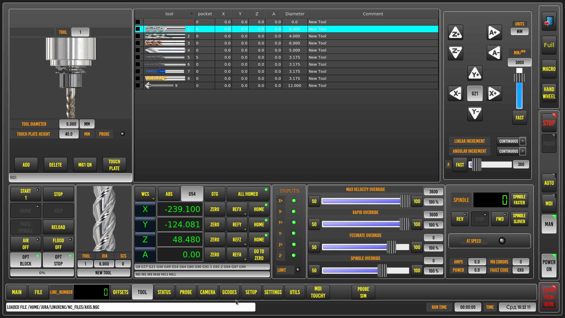

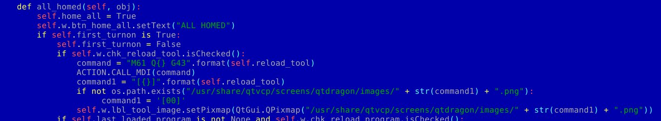

Hello! Please tell me how to add a tool image to the tool_offsetview .py widget. As well as switching the image through the tool selection dialog. Thank you!
- MarkoPolo
- Posts: 319
- Thank you received: 90
07 Jul 2022 17:54 - 07 Jul 2022 18:20 #246820
by MarkoPolo
Replied by MarkoPolo on topic Error in tool_offsetview.py

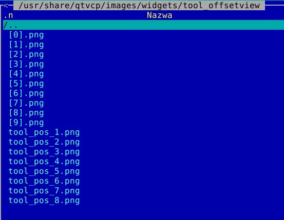

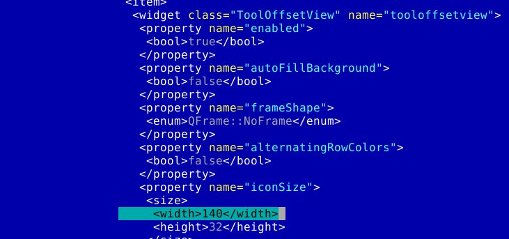

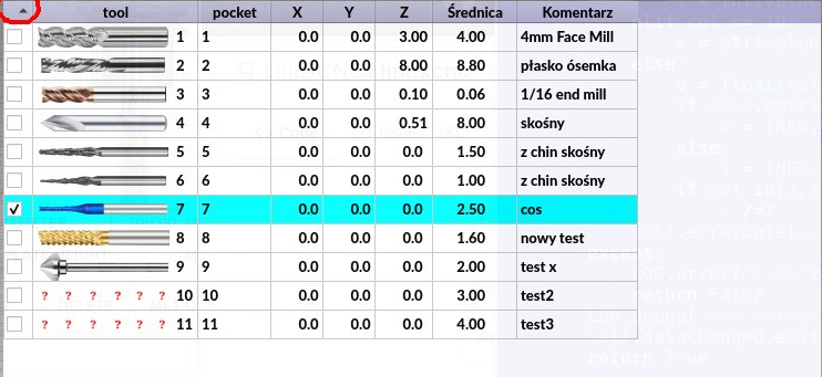

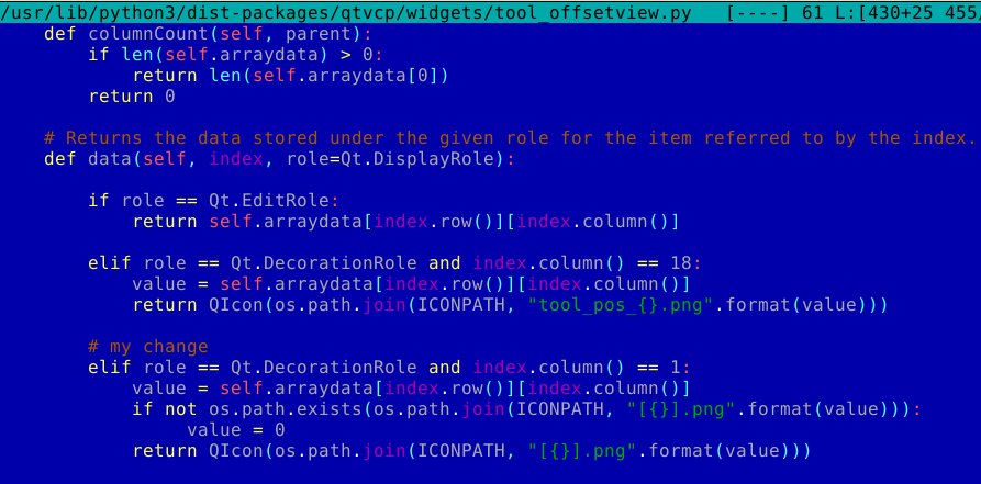

this is just experimental fun but it works pretty well. Chris once mentioned that he wanted to add tool image options. Chris will do it right.
I did it like this:

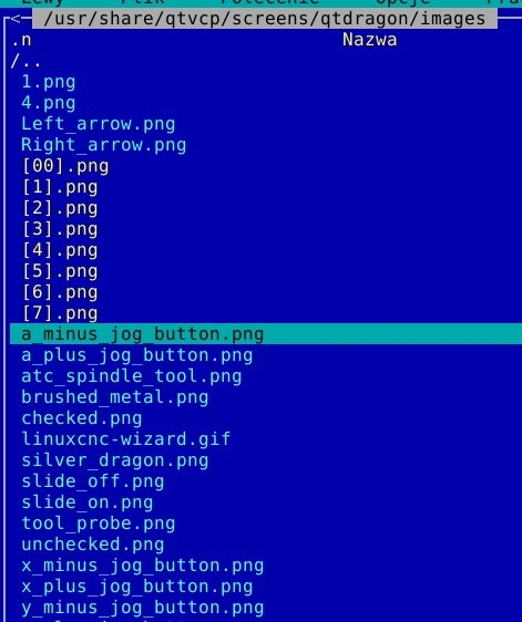

For the pictures to be displayed in the tools of the tool_offsetview.py in the file tool_offsetview.py, make such a change
, do the image files in the directory:
in the qtdragon.ui file, you need to enlarge the space for the tool image
In order for the images to update in the preview, you need to add such entries in the qtdragon_handler.py file
unfortunately the second set of vertical images in the catalog
I did it like this:

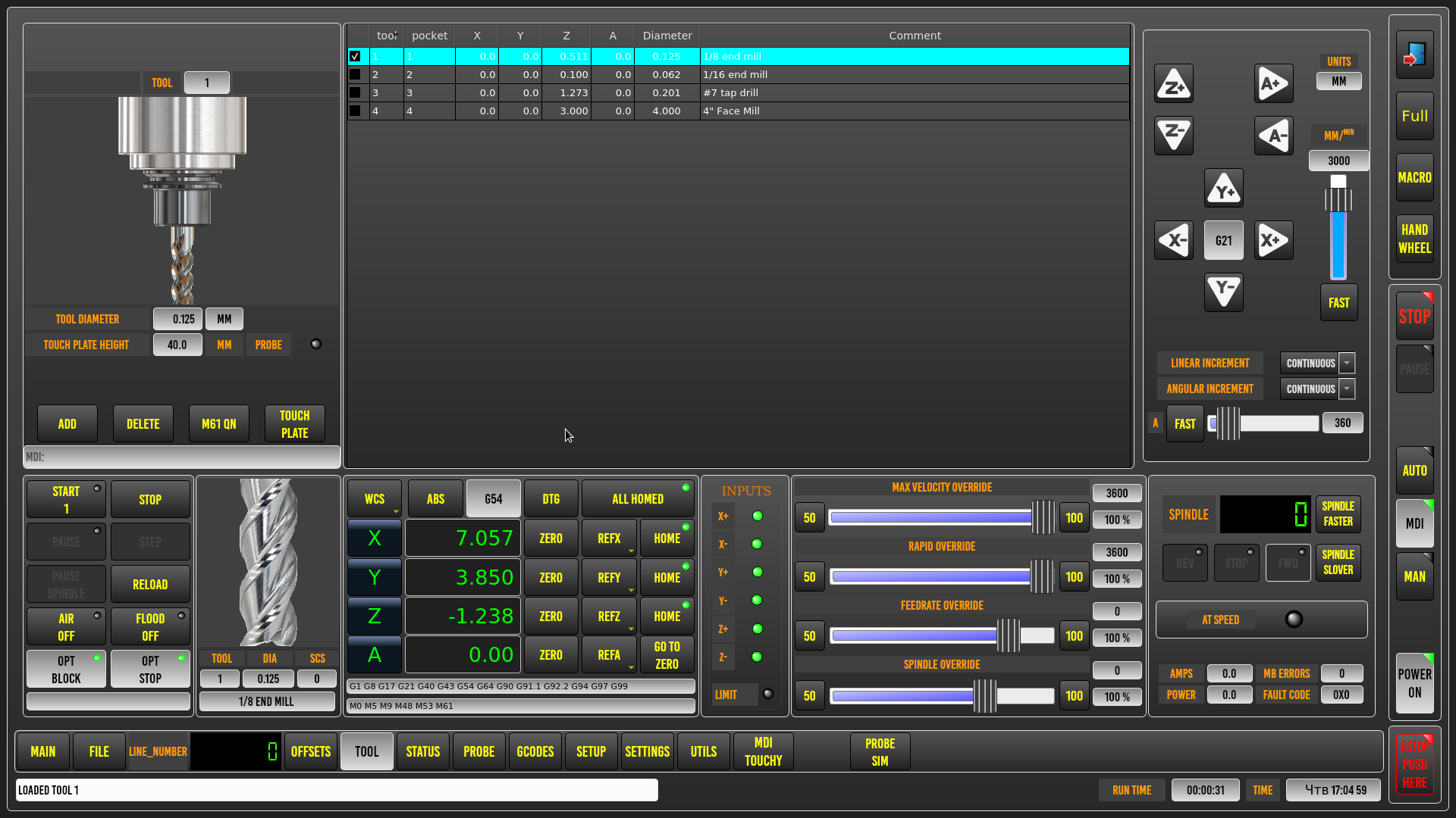

Thank you very much for your attention and help! Here is my version of qtdragon, you may be interested.

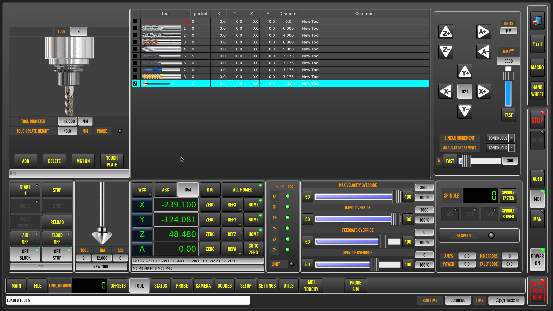

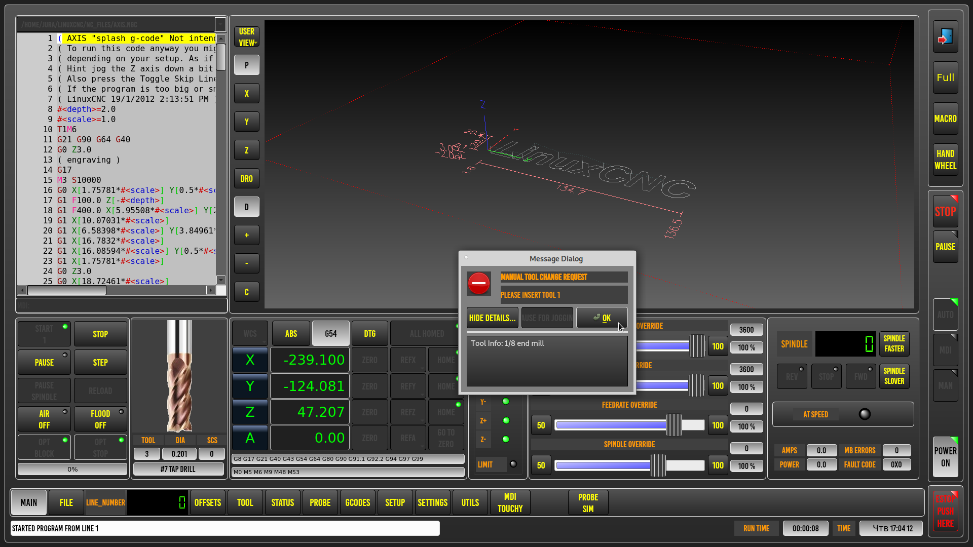

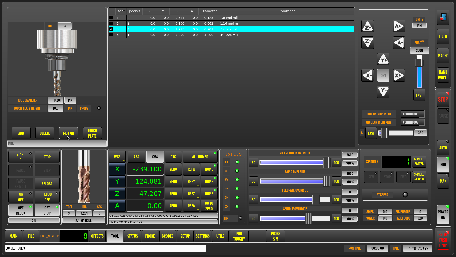

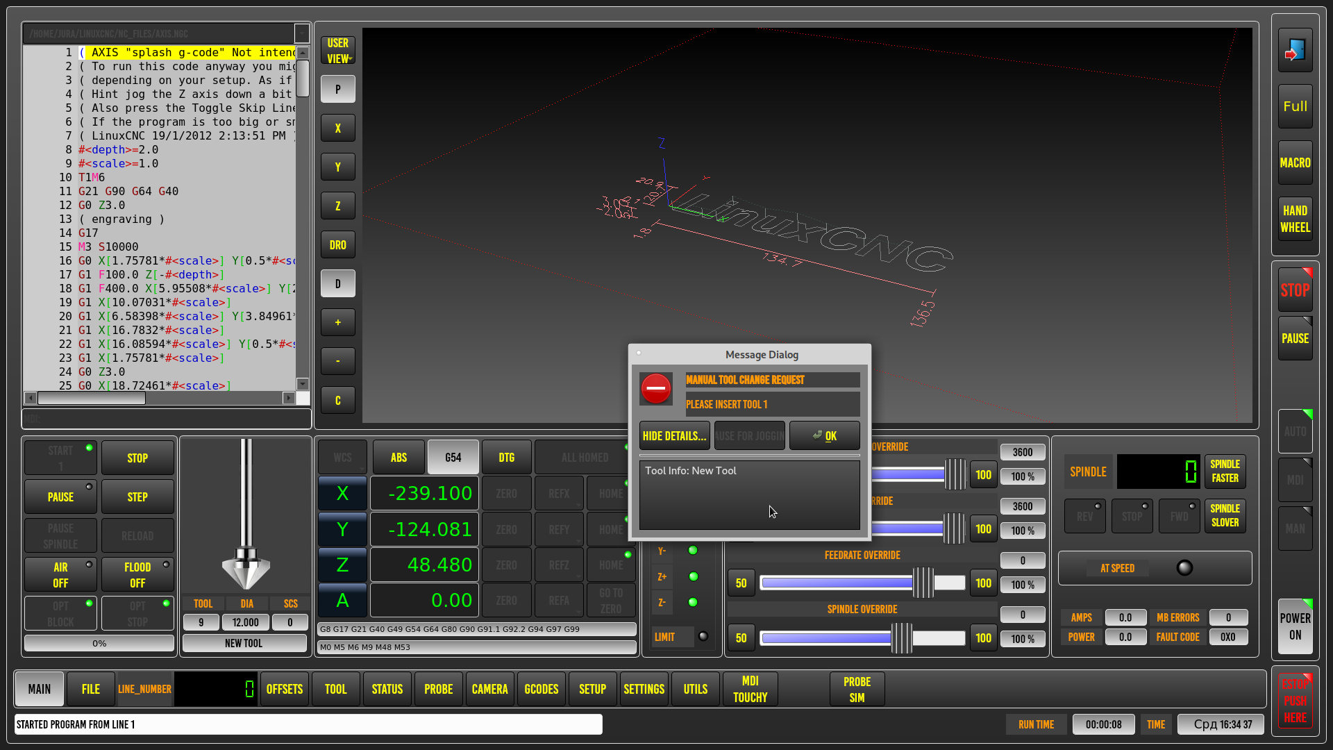

13 Jul 2022 13:47 #247235
by hottabich
Replied by hottabich on topic Error in tool_offsetview.py
Switching the tool with the command M61 or Reload Tool changes the image of the tool, but not through the dialog. Who knows how to fix it please tell me. Thank you!
- Posts: 7368
- Thank you received: 2181
14 Jul 2022 04:35 #247273
Replied by cmorley on topic Error in tool_offsetview.py
use the STATUS message 'tool-in-spindle-changed' to call a function, to change the image.
- hottabich
- Posts: 574
- Thank you received: 96
14 Jul 2022 17:40 #247307
by hottabich
Sorry, but I don't understand how to implement this. Thank you!
- Posts: 7368
15 Jul 2022 03:52 #247351
In the handler file something like this:
STATUS.connect('tool-in-spindle-changed', lambda w, t: self.update_tool_image(t))def update_tool_image(self, toolnumber):
command1 = "[{}]".format(toolnumber)
self.w.lbl_tool_image.setPixmap(QtGui.QPixmap(":/images/images/" + str(command1) + ".png"))
- hottabich
- Posts: 574
16 Jul 2022 13:06 #247459
by hottabich
Thank you so much! Works great. I spread the handler with changes for my previous files.

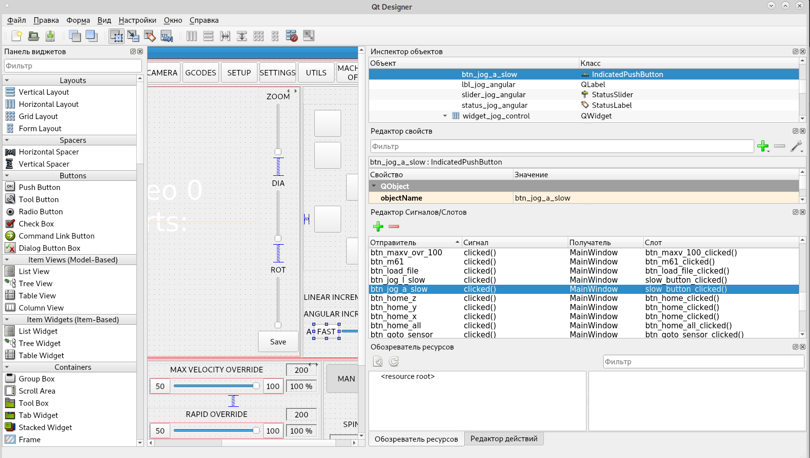

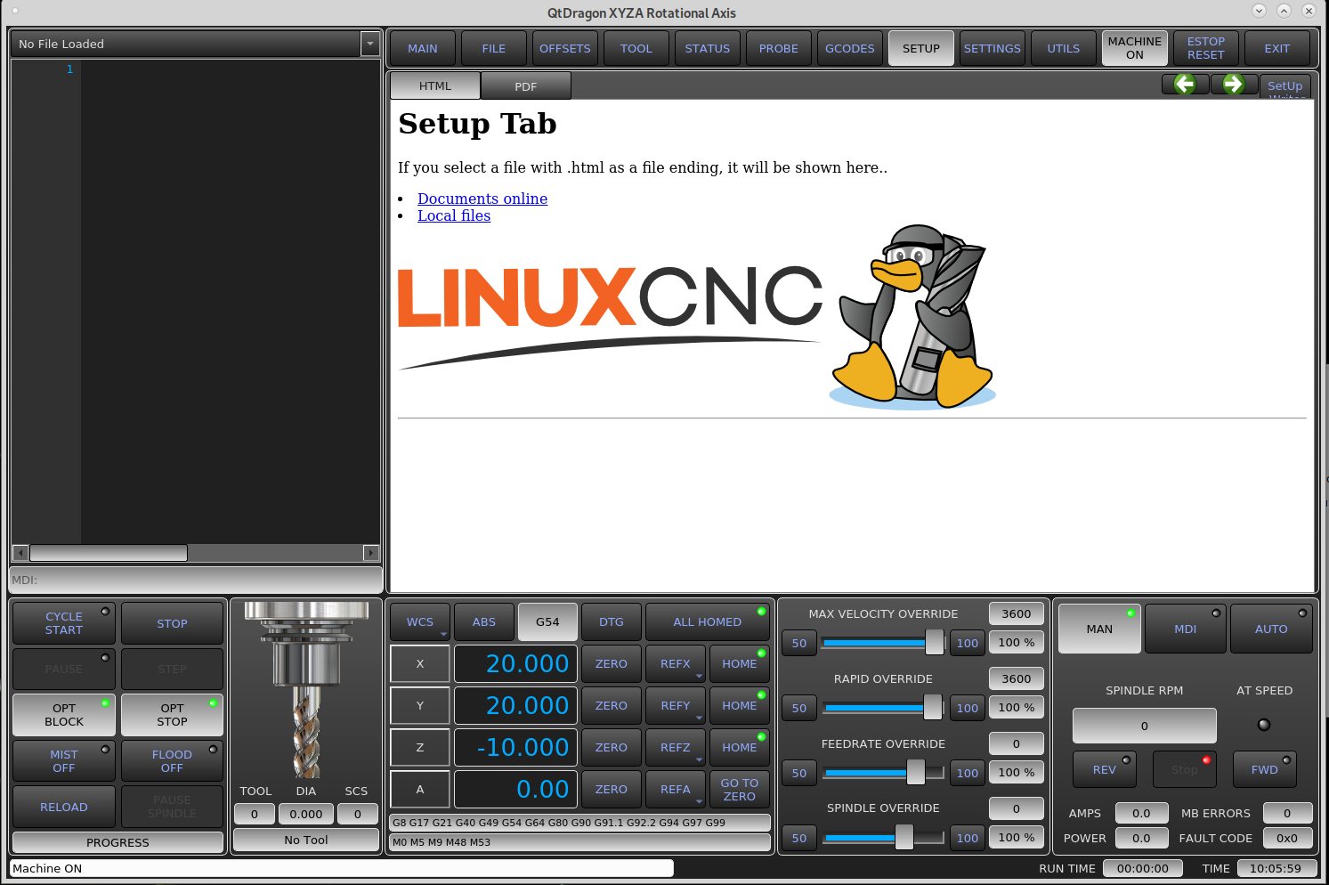

not much is happening, so I made some minor adjustments in the setup tab, because the buttons didn't look right.
Two other problems:1. With manual movements of the A axis, the "fast/slow" switch does not toggle the value.2. In the "setup" tab, the link to local files in lcnc installed in the virtual machine works normally, but on a normal computer this link does not work for me, I cannot find the reason. Does it do the same for you?
Marek
The problem with the "fast / slow" switch fixed, I am sending an updated .ui file
Marek
Marek
Marek
Last edit: 12 Aug 2022 19:20 by MarkoPolo.
- hottabich
- Posts: 574
12 Aug 2022 19:00 - 12 Aug 2022 19:09 #249613
by hottabich
To switch in the designer, you need to add a signal slot or an attached file. linuxcnc installed in computer.
