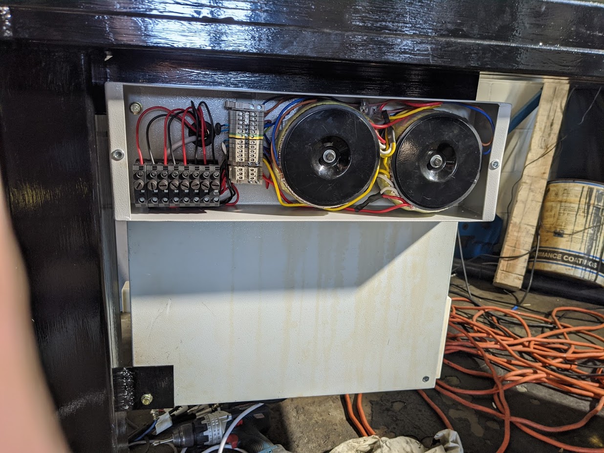

I'm not sure its as cost effective as you might first think. I am close to $3k into this upgrade...Anyway, the end is in sight. Did I tell you I hate Microsoft now. It took at least 2 hours today to get the lam programmer up and running. But finally with some help from Chris, we got the 17 kg power supply box into place and the control panel back on the machine.
I did get motion and its satisfying to hear the motors clunk into action. I just have to finish off revised wiring to the motor enable signal. I was working on that when Chis arrived so only one is enabled. Its interesting to see that Lam actually have a true motor enable input. But you can invert the signals when programming it.On my old setup, I had a 5 volt stepper driver disable signal hooked to estop. It was fired by a 24 volt relay to switch the 5 volts. But now I can use 24 volts for all inputs so I am going to get rid of the relay and power direct from the 7i76e.

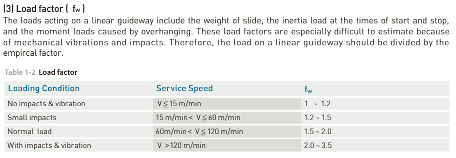

04 Jul 2020 02:50 - 04 Jul 2020 03:04 #173577 by Reinhard
Linear rails are rated for velocities of 3-5 m/min
Are you sure about the unit?
CPC rates their linear systems for 10m/s and acceleration beyond 500m/s²
and here an excerpt from Hiwin:
Last edit: 04 Jul 2020 03:04 by Reinhard.

04 Jul 2020 05:29 #173584 by rodw
Reinhard, my mistake, it should be m/sec when I review the source I was quoting. My bad! See:
www.rollon.com/IN/en/news-item/378-under...ed-and-acceleration/

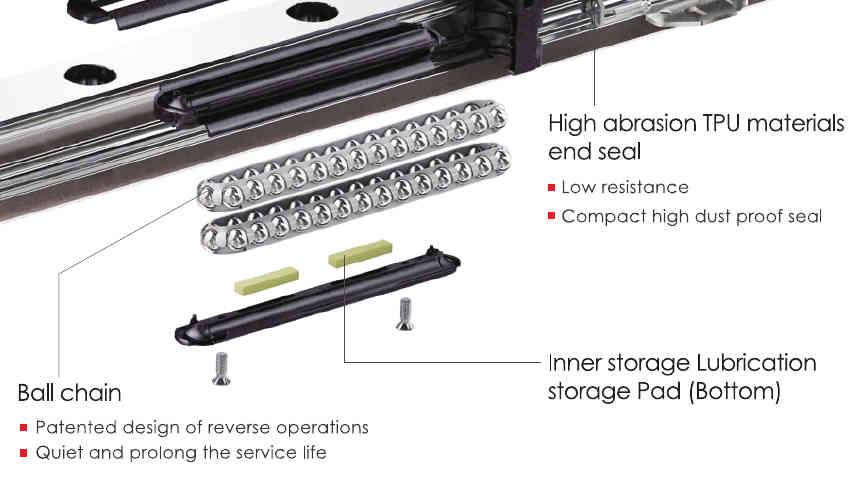

04 Jul 2020 07:13 - 04 Jul 2020 07:14 #173586 by Reinhard
... we are driving them way beyond that. Thats why those 600 balls make so much noise complaining about being overdriven on a plasma machine!
The noise comes from the balls scouring at each other. On cheap linear cariages the balls push each other when moving. That scratching makes the sound ...
Better systems provide a spacer between the balls (image taken from CPC, Hiwin and others offer similar):
with such ballchain the friction is lower and lifetime is longer.
At work a carriage was broken and needed to be replaced. But cheese-pairing support collegues bought a carriage without ballchain - now the machine screams like hell.
cheers Reinhard
