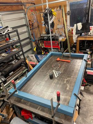

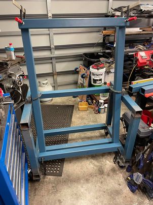

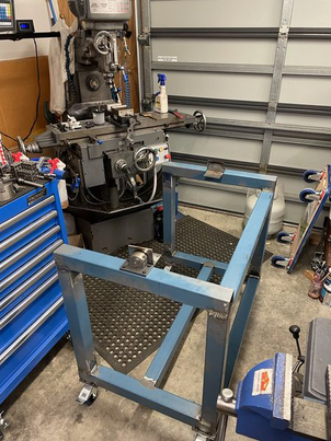

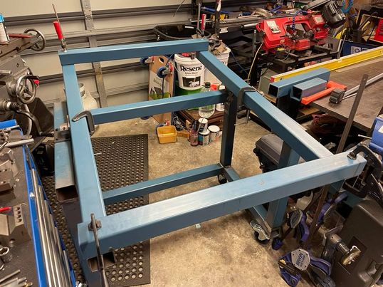

26 Jun 2021 04:44 #212944
by Joco
Replied by Joco on topic "Origami" CNC Plasma Build - folding 1200 x 600mm cut area
Some progress today after some time waiting to get over a nasty chest infection - not COVID fortunately.
Got the hinges done on the base frame.
Then moved on to some gratuitous cleaning. Well I was going to need the clean surfaces once I got the next lot of steel chopped up.
So chopping up leangths of 65mm SHS (3mm wall) to make the table top. Then just clamip it up into a rough approximation in the hinges to see how it would work/look.
Seems to look about right. Hinges working well. Then on to an initial fit up on the table to make sure I had things all the correct length and could clamp it all down and get it square.
Next up is preping all the joints, getting it sqaure and clamped up super ridgid so nothing is going to move while I tack things up and weld the outer seams. Then it will be moving on to welding it all out and trying to keep the amount of metal put down consistent so all the stresses are even and the frame stays flat.
Cheers - J.
Cheers - J.
