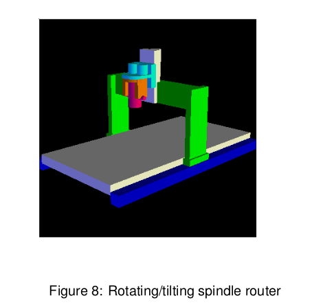

I have not really seen more than a quick glimpse of the spindle of your machine but if your machine has a rotary/tilting spindle like this:
linuxcnc.org/docs/2.8/html/motion/5-axis-figures/Figure-11.png
Then you should try '5axiskins'. Have a look at the simualtion at /configs/sim/axis/vismach/5axis/bridgemill
If you have a setup like one of these (ie a tilting/rotating mechanism on the machine table) then either 'xyzac-trt' or 'xyzbc-trt' will be useful to you:
linuxcnc.org/docs/2.8/html/motion/5-axis-figures/Figure-3.png
linuxcnc.org/docs/2.8/html/motion/5-axis-figures/Figure-7.png
There are also mixed types. If you are still unsure then please post a picture of your machine.

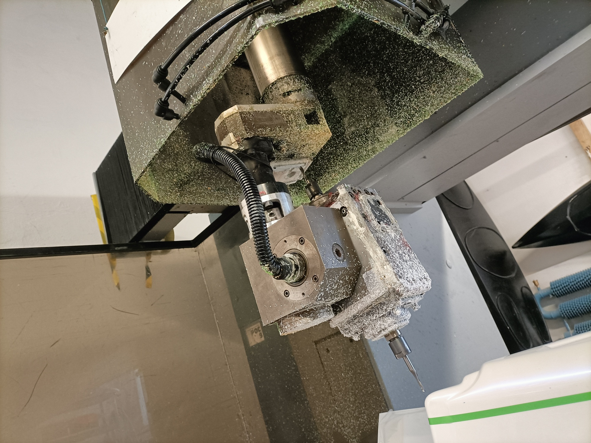

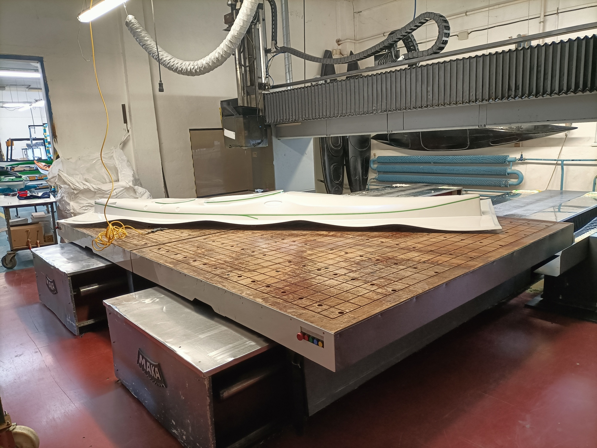

23 Sep 2021 09:37 #221413 by jurod
Replied by jurod on topic TCP 5-axis kinematics
I am sending photo.
So should i go back to 2.8.2?
23 Sep 2021 16:19 #221438 by Aciera
Replied by Aciera on topic TCP 5-axis kinematics
Nice machine. Looks like the XYZBC-SRT kinematics would be the most likely to help you. The most important thing is to get the offsets of the rotational axis correct. Do you have any dimensional drawings of the machine head?

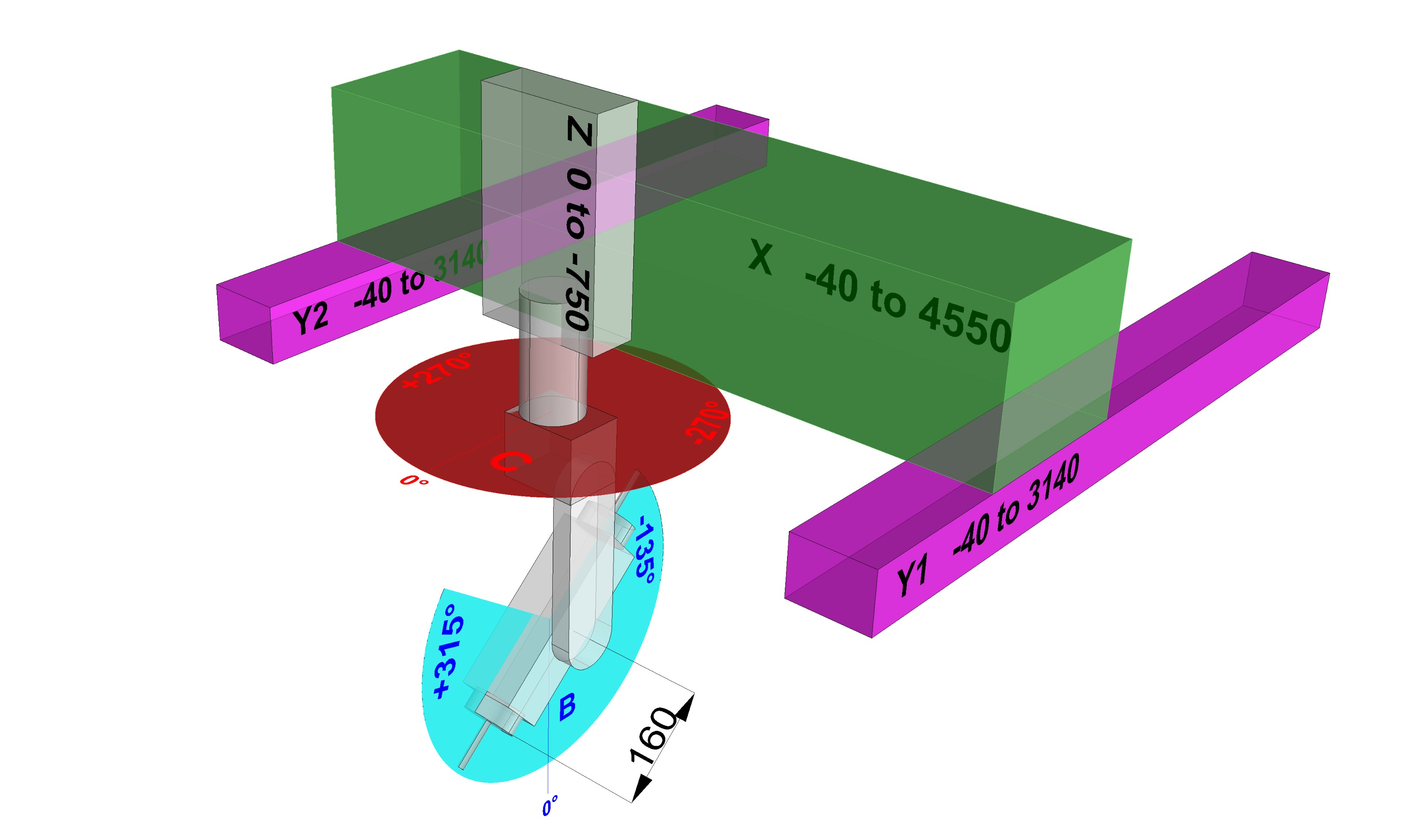

03 Oct 2021 14:44 #222108 by jurod
Is the XYZBC-srt module to download somewhere?
Dimensional drawing in the photo.
04 Oct 2021 11:29 - 04 Oct 2021 11:35 #222190 by Aciera
Have a look at 5axiskins.c in the linuxcnc/src/emc/kinematics folder. That kinematic is used in the simulation configuration found at /configs/sim/axis/vismach/5axis/bridgemill/5axis.ini
Inside '5axiskins.c' you will find some commentary and the definition of the DEFAULT_PIVOT_LENGTH that you will probably want to change to 160:

Note that this kinematic creates a hal-pin called 'pivot_length':
struct haldata {
    hal_float_t *pivot_length;
Make sure you provide the required value (ie your 160mm plus any tool-length offset) in your hal. As in the file '5axisgui.hal' in the 'bridgemill' simulation configuration. You will probably want to remove the stuff for the vismach script so you will end up with something like this:
# compute pivot-length needed for 5axiskins
loadrt sum2 names=pivotsum
addf pivotsum servo-thread
setp  pivotsum.in0  160
net :tool-len <= motion.tooloffset.z
net :tool-len => pivotsum.in1
net :pivot-len <= pivotsum.out
net :pivot-len => 5axiskins.pivot-length
