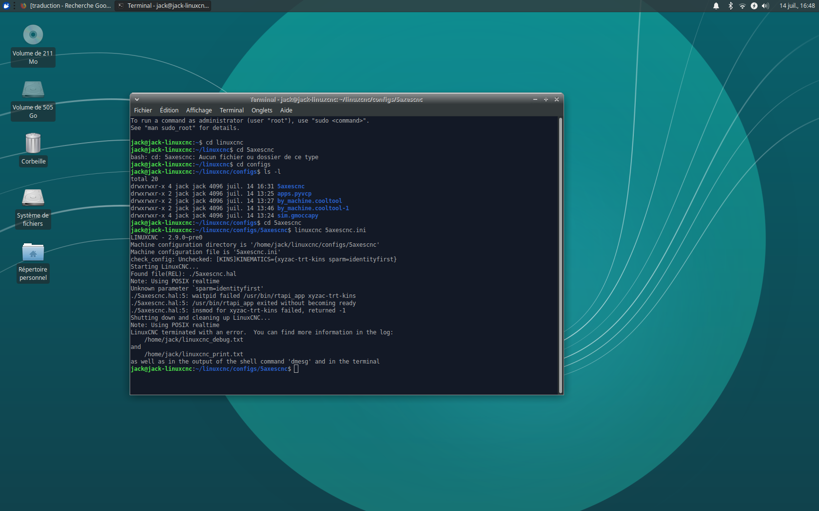

I have a pb ,
inuxcnc-uspace:
Dépend: libboost-python1.62.0 but it is not installable
Recommande : linuxcnc-doc-en mais ne doit pas être installé ou
linuxcnc-doc
inuxcnc-uspace:
linuxcnc-doc

Is this for Xubuntu or the official ISO?
which distribution did you use stretch or buster?
[edit]
last question is regarding what you wrote in the "Distribution" field when you added the repositories.
[edit]

1) I'm still on official debian version.
2) I used "stretch" as on the video "buster" doesn't seem to work ...

For the official debian ISO you would want to use "buster". Worked for me after I added the key with the command
sudo apt-key adv --keyserver hkp://keyserver.ubuntu.com --recv-key EF1B07FEE0EE663E
In what way did it not seem to work for you?

I did this, I tried, but he tells me that he cannot find the dependence "libboost-python1.62.0"
I did this, I tried, but he tells me he can not find the dependence.
Not easy anyway.
I will try to put my configuration Under Xubuntu linuxcnc 2.9pre. if I just have to copy my configs files, it will be easier. But I still think I will run into other problems ...
Not easy anyway.

Have you removed the 'stretch'-repsitories you added before?
Maybe you could post a screenshot of your synaptic package manger window showing the repositories?
Replied by Aciera on topic TCP 5-axis kinematics
No, this should be a lot easier. I agree.Not easy anyway.

Wow, that is a full image converted to text !
Did you check this:
forum.linuxcnc.org/9-installing-linuxcnc...nd-easy-installation
It works for ubuntu 18 also.
Did you check this:
