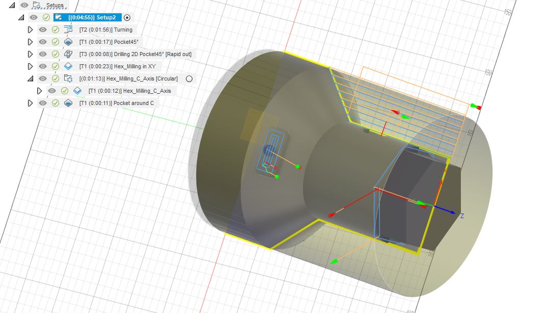

05 May 2025 07:47 - 05 May 2025 07:52 #327741
by jochen91
Replied by jochen91 on topic Planning to Retrofit a Mazak Integrex200Y Mill-Turn Machine
I did model up a test piece in Fusion:
The machine type selected in the PP was PUMA MX.
It look like only G400/G368/G17 and G18 is used.You said that G17,G18 and G368 can be replaced with G68.3 and G53.1 which i understand, but what about G400 ? (Functionality is documented in the .pdf). I think if those GCodes changes are implemented into the PP. The Doosan PP is sorta ready for LCNC (besides various M-codes).I can't test the TCP behavior of the PP since i don't have the manufacturing extension for Fusion.
Kind regards,
Jochen
Warning: Spoiler!

%It look like only G400/G368/G17 and G18 is used.You said that G17,G18 and G368 can be replaced with G68.3 and G53.1 which i understand, but what about G400 ? (Functionality is documented in the .pdf). I think if those GCodes changes are implemented into the PP. The Doosan PP is sorta ready for LCNC (besides various M-codes).I can't test the TCP behavior of the PP since i don't have the manufacturing extension for Fusion.
Kind regards,
Jochen
Last edit: 05 May 2025 07:52 by jochen91.

Replied by Aciera on topic Planning to Retrofit a Mazak Integrex200Y Mill-Turn Machine
Looks like G368/G369 can be handled by the TWP functionality.
G400 is different as it transforms the tool offset rather than the tool position.
I'm not very familiar with cnc turning so I have little idea how linuxcnc handles the tool orientation as set in 'R' and 'K' words. There is this document which also refers to tool orientation but I have really no idea if this is actually used in motion planning or only in the GUI.
linuxcnc.org/docs/html/lathe/lathe-user.html
I'd say it's certainly possible to recreate this using a python remap.
Note though that even Doosan suggest that it is more accurate to touch off the tool at the b-axis angle used in the operation.
Last edit: 05 May 2025 08:58 by Aciera.

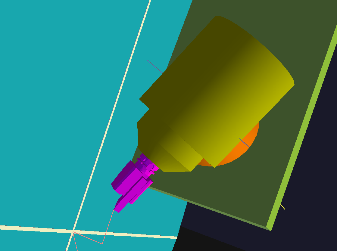

I'm still working on it.
Having the tool pointing in the x direction instead of the z direction in the home position has turned out to be a bit more of a headache as Linuxcnc applies the tool offsets internally.
TCP with xyz tool offset and tool spindle orientation is done. The kinematic for Tilted work plane also works but the transformation of the work offset still needs some work.
Let me figure this out first and I'll post a new sim config so you can have a look at it. Then we can have a look at customizing the gcodes for your specific needs.

07 May 2025 07:56 #327927
Could you export the example part from your post here as an stl file and post it here?
forum.linuxcnc.org/10-advanced-configura...hine?start=40#327741

07 May 2025 08:53 - 07 May 2025 08:54 #327929
by jochen91
I exported it in STL and OBJ. I had problems getting Fusion STL export into vismach. OBJ worked flawless. Thank you!
Last edit: 07 May 2025 08:54 by jochen91.
- meister
- Posts: 805
- Thank you received: 502
07 May 2025 09:24 #327931
by meister
Replied by meister on topic Planning to Retrofit a Mazak Integrex200Y Mill-Turn Machine
there are two versions of STL files, ASCII and Binary, you have a binary file and vismach can only read the ASCII format
