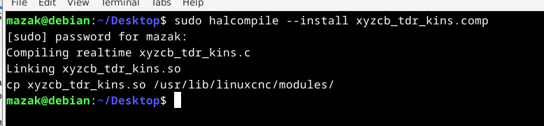

I could need a little help. I compiled my kinematics with halcompile --install. And i used the vismach xyzbc-trt-kins (switchkins) demo. I tried to replace the original Kinematics with my custom kinematics and after some commenting out i got this error message. Would be glad for some input to guide me in the right direction.
I continued a little bit and now its this:
Note: Using POSIX realtime
motmod: dlopen: /usr/lib/linuxcnc/modules/motmod.so: undefined symbol: kinematicsSwitch
././xyzbc-trt_cmds.hal:38: waitpid failed /usr/bin/rtapi_app motmod
././xyzbc-trt_cmds.hal:38: /usr/bin/rtapi_app exited without becoming ready
././xyzbc-trt_cmds.hal:38: insmod for motmod failed, returned -1
20961
Stopping realtime threads
Unloading hal components
20961

- Posts: 4819
- Thank you received: 2176
14 Apr 2025 06:45 #326246
Replied by Aciera on topic Planning to Retrofit a Mazak Integrex200Y Mill-Turn Machine
Not sure, halcompile output looks ok. Starting your config from a terminal may give more debug information.
$ linuxcncPlease Log in or Create an account to join the conversation.

14 Apr 2025 07:47 #326253
by jochen91
Replied by jochen91 on topic Planning to Retrofit a Mazak Integrex200Y Mill-Turn Machine
This is the Error Message i got from my config:
LINUXCNC - 2.9.4
Machine configuration directory is '/home/mazak/linuxcnc/configs/sim.axis.vismach.5axis.table-rotary-tilting'
Machine configuration file is 'xyzbc-trt.ini'
check_config: Unchecked: [KINS]KINEMATICS=xyzcb_tdr_kins
Starting LinuxCNC...
Found file(REL): ././xyzbc-trt_cmds.hal
/home/mazak/linuxcnc_debug.txt
and
/home/mazak/linuxcnc_print.txt
as well as in the output of the shell command 'dmesg' and in the terminal
Additionally i created another bare bone config with step conf and just replaced the KINEMATICS Name in the .ini file with my kinematic file. (It starts up with a 5 axis demo kinematics file, just not with mine) I assume there is something wrong in my kinematics ?
LINUXCNC - 2.9.4
Machine configuration directory is '/home/mazak/linuxcnc/configs/my-mill'
Machine configuration file is 'my-mill.ini'
check_config: Unchecked: [KINS]KINEMATICS=xyzbc_MAZAK_kins
Found file(REL): ./my-mill.hal
*** xyzbc_MAZAK_kins.comp setup ok
Found file(REL): ./custom.hal
rtapi_app: caught signal 11 - dumping core
USRMOT: ERROR: command timeout
emcMotionInit: emcTrajInit failed
note: MAXV max: 25.000 units/sec 1500.000 units/min
note: LJOG max: 25.000 units/sec 1500.000 units/min
note: LJOG default: 2.500 units/sec 150.000 units/min
note: AJOG max: 360.000 units/sec 21600.000 units/min
note: AJOG default: 36.000 units/sec 2160.000 units/min
waiting for s.joints<0>, s.kinematics_type<0>
Waiting for component 'inihal' to become ready....waiting for s.joints<0>, s.kinematics_type<0>
.......USRMOT: ERROR: command timeout
......waiting for s.joints<0>, s.kinematics_type<0>
..............USRMOT: ERROR: command timeout
...........A configuration error is preventing LinuxCNC from starting.
More information may be available when running from a terminal.
.Shutting down and cleaning up LinuxCNC...
<commandline>:0: milltask exited without becoming ready
Waited 3 seconds for master. giving up.
sim_axis_hardware: not loaded
<commandline>:0: exit value: 255
<commandline>:0: rmmod failed, returned -1
stepgen: not loaded
sim_parport: not loaded
motmod: not loaded
xyzbc_MAZAK_kins: not loaded
homemod: not loaded
tpmod: not loaded
<commandline>:0: unloadrt failed
and
LINUXCNC - 2.9.4
and
LINUXCNC - 2.9.4
stepgen: not loaded
motmod: not loaded
homemod: not loaded
tpmod: not loaded
and
- Posts: 22004
- Thank you received: 7489
14 Apr 2025 08:27 #326258
Linux is case sensitive, so kinematicsswitch is not the same as kinematicsSwitch, notice the upper case S.
Replied by tommylight on topic Planning to Retrofit a Mazak Integrex200Y Mill-Turn Machine
motmod: dlopen: /usr/lib/linuxcnc/modules/motmod.so: undefined symbol: kinematicsSwitchPlease Log in or Create an account to join the conversation.
- jochen91
- Posts: 72
- Thank you received: 23
14 Apr 2025 08:44 - 14 Apr 2025 08:47 #326260
by jochen91
Hi Tommy,
i think i never used the lower case "s". I used the millturn.comp for this function. Here is the part from my comp file:
EXPORT_SYMBOL(kinematicsType);
EXPORT_SYMBOL(kinematicsSwitchable);
EXPORT_SYMBOL(kinematicsSwitch);
EXPORT_SYMBOL(kinematicsInverse);
EXPORT_SYMBOL(kinematicsForward);
static hal_u32_t switchkins_type;
int kinematicsSwitchable() {return 1;}
int kinematicsSwitch(int new_switchkins_type)
switchkins_type = new_switchkins_type;
rtapi_print("kinematicsSwitch(): type=%d\n",switchkins_type);
// create case structure for switchable kinematics
switch (switchkins_type)
case 0: rtapi_print_msg(RTAPI_MSG_INFO,
"kinematicsSwitch:TYPE0\n");
*haldata->kinstype_is_0 = 1;
*haldata->kinstype_is_1 = 0;
break;
case 1: rtapi_print_msg(RTAPI_MSG_INFO,
"kinematicsSwitch:TYPE1\n");
*haldata->kinstype_is_0 = 0;
*haldata->kinstype_is_1 = 1;
break;
default: rtapi_print_msg(RTAPI_MSG_ERR,
"kinematicsSwitch:BAD VALUE <%d>\n",
switchkins_type);
return -1; // FAIL
return 0; // ok
break;
break;
switchkins_type);
return -1; // FAIL
return 0; // ok
Last edit: 14 Apr 2025 08:47 by jochen91.
- Posts: 4819
14 Apr 2025 10:54 - 14 Apr 2025 11:13 #326264
The message about 'undefined symbol: kinematicsSwitch' is actually a spurious error that will pop up whenever the kinematic fails to load.
I believe the actual problem is:
which unfortunately is a bit cryptic.
I would start out with an unmodified 'xyzcb_tdr_kins.comp' and do the modifications in small steps while frequently 'halcompiling' the file to find out when it breaks.
rtapi_app: caught signal 11 - dumping corewhich unfortunately is a bit cryptic.
Last edit: 14 Apr 2025 11:13 by Aciera.
