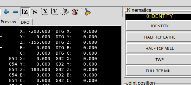

12 May 2025 13:45 - 12 May 2025 17:12 #328270 by Aciera
1. I tried to define the real machine limits in the .ini File. i.e. Z axis travel of 1065mm and home at zero. But after starting and homing z is automatically at -180mm.
Changing machine limits in the ini will (and should not) change anything in the DRO at startup. I'm not sure where you see '-180' for Z. This is what I get:

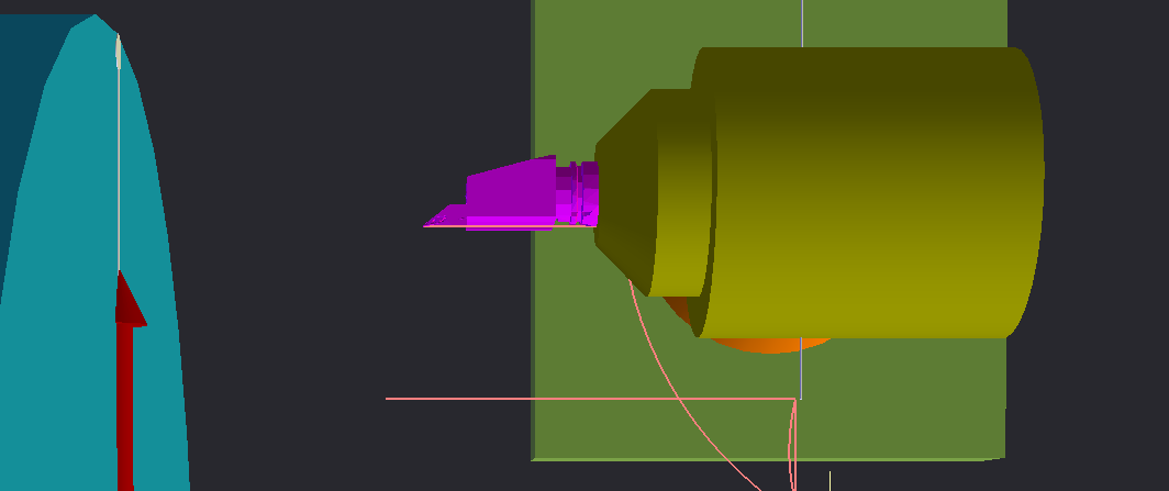

2. While running the example part (which makes me happy every time i do it... thank you so much) i realized that the tool change position is defined by G53 in the M6 remap. But in the vismach sim it definitely looks different between T101 und T2.
You might get confused about the difference in the tool path backplot (ie the pink line). This is purely a product of the visualization and comes from the different direction of the x and z tool-offsets for milling and turning.  Absolute machine position is reflected by the values in the 'Joint Position' section in the right hand panel:

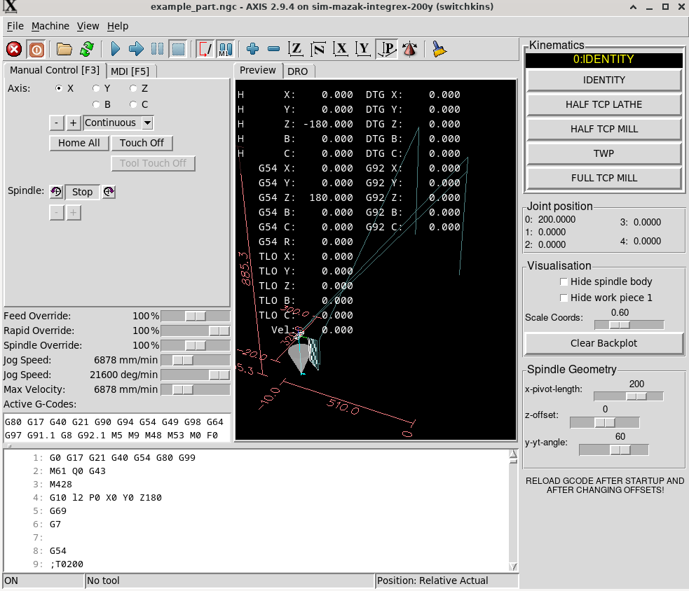

For the Z-180 after homing:
My startup procedure is: Starting the configuration and homing. After that the Z Axis is at -180. See screenshot attached.
For the different tool change position:
Toolchange from no tool to lathe tool:
X-Axis-Position: 250mm
X-Joint-Position: 623.2051mm
Toolchange No. 2 from lathe tool to endmill:
X-Axis-Position: 330mm
X-Joint-Position: 873.2051mm
The Y-Joint-Position is the same.

13 May 2025 09:02 - 13 May 2025 09:03 #328361 by Aciera
Re: the Z-180 after homing:
Seems your config homes at joint position 200 rather than 0, which is new.
Could you attach the ini file? (I notice that you have changed the z-offset to 0)

13 May 2025 09:44 #328362 by Aciera
RE: Toolchange position:
The issue is due to different G7/G8 status for tool changes in the example program. This is solved by forcing 'G8' in the tool change macro.
So change './remap_subs/m6remap.ngc' to this:
o<m6remap>sub
M66 L0 E0
M428
G8
G53 G0 X500 Y300 Z900
G53 G0 B-90
G53 Z500
M66 L0 E0
M6
G53 Z900
G53 X200
o<m6remap>endsub
m2
Note that this macro is really only a rough sketch as it is, there are likely to be other issues.
Also note that this issue points out that the cgode program needs to set 'G7/G8' _after_ the tool change or, for a fancier solution, for the toolchange macro to restore the 'G7/G8'.

13 May 2025 12:04 #328372 by jochen91
Thank you! I will implement that this evening and post my .ini fill in regards to the Z-180mm thing. I'm somewhat sure i used 0 - 1065mm for axis and -1 - 1066 for joints

13 May 2025 13:56 #328379 by jochen91
Here is the promised ini file. It is as i thought:
Z-Axis: 0 - 1065mm
Z-Joint: -1 - 1066mm
Thank you for the G7/G8 fix :)
