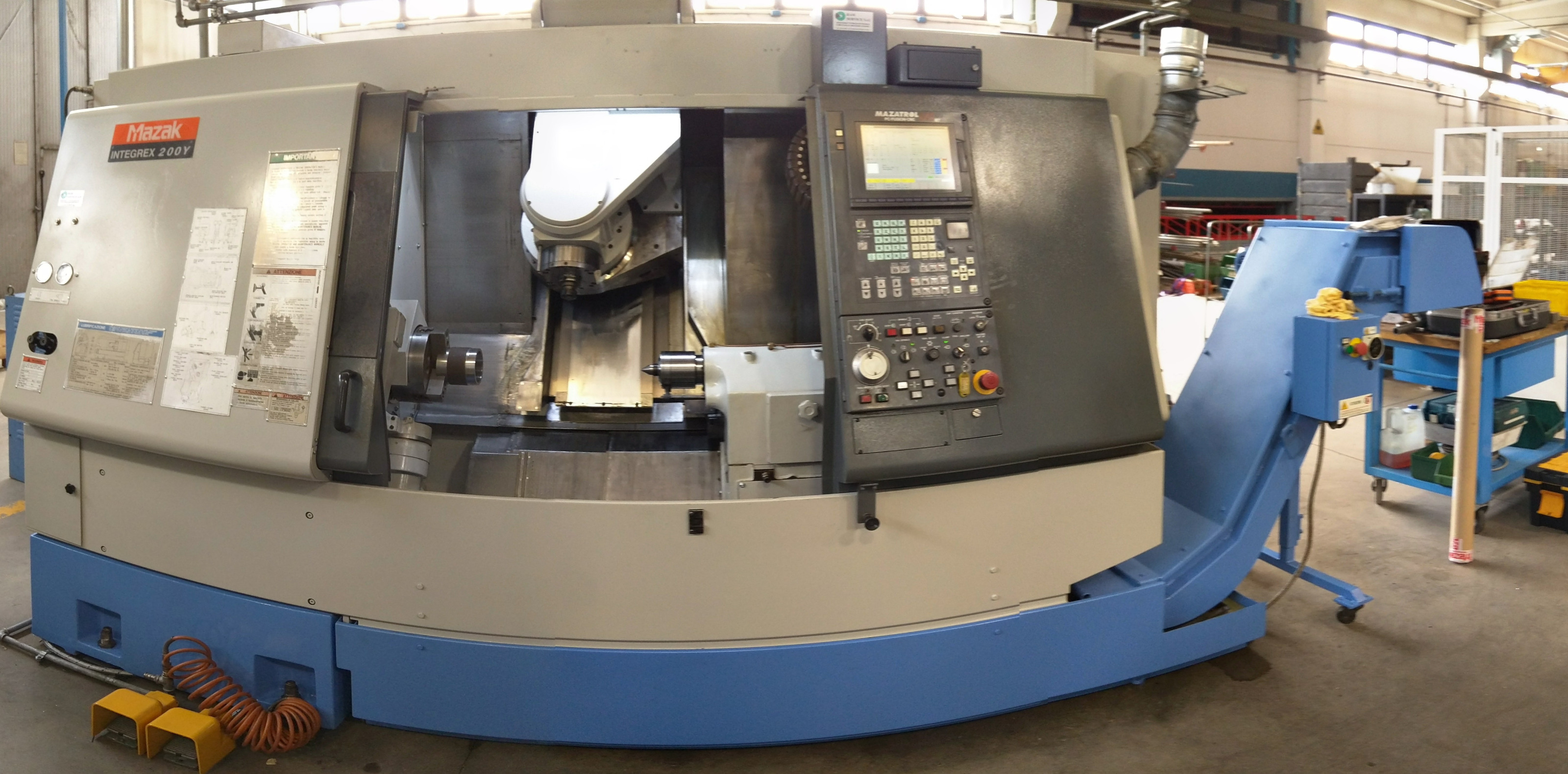

Planning to Retrofit a Mazak Integrex200Y Mill-Turn Machine
17 Apr 2025 18:36 - 17 Apr 2025 18:50 #326536 by Aciera
Looking at a mazak integrex 200y:
I just realized that your machine is actually more setup as a lathe so the above will not be much help.
The best way forward would likely be to build a new custom kinematic for your type of machine. I have a series of documentations (including the jupyter notebooks for sagemath) if you want to have a go at it:
github.com/Sigma1912/LinuxCNC_Demo_Confi...tating/Documentation
[edit]
If you attach your vismach model I'll see if I can find some time to help you.
Last edit: 17 Apr 2025 18:50 by Aciera.
The following user(s) said Thank You: besriworld, jochen91

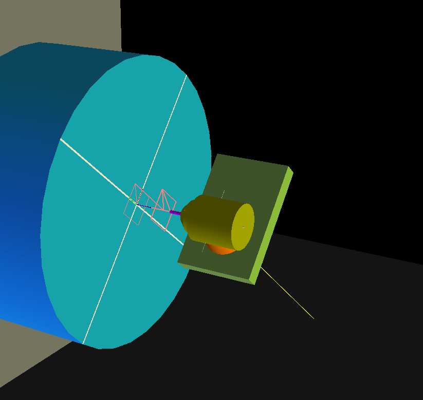

20 Apr 2025 09:54 #326750 by Aciera
Here is a sim config:
File Attachment:
File Name: mazak-inte...y.tar.gz
File Size:17 KB
1. unpack to your 'configs' folder
2. make sure that '/vismach/mazak-integrex-200y-gui.py' is marked as executable (right-click->Properties)
3. 'halcompile --install' the enclosed 'mazak_integrex_200y_kins.comp'
4. start the config and run the preloaded example gcode
Notes:
- Slide tilt angle and pivot-length can be set using the slider in the right hand panel.
- the vismach model is a reused model from one of my other sim configs so it is a bit minimalistic but should suffice the purpose for now.
The following user(s) said Thank You: tivoi, besriworld, jochen91
23 Apr 2025 20:19 #326978 by jochen91
Hi Aciera,
sorry for reply a bit late. I was on vaccation. Thank you so so much for this incredible help! I downloaded it and played i bit arround and it looks realy good.
I changed the travel limits for the B-Axis, because the head can swivel from "looking" left and right into the z direction. This caused some trouble. I need to spend more time with it to know what needs to be "polished".
Also i saw, that in the Identity Mode the Axis soft limits work fine, but in TCP-Mode the maschine runs into the joint hard limits.
I hope in find time during the weekend to dig myself further into your example. Thanks again for the amazing help!
Kind regards,
Jochen
24 Apr 2025 07:00 #326986 by Aciera
For non trivial kinematics proper limit checking prior to execution time is currently not possible because the planner is totally ignorant of custom kinematics. Your best option would be to check for limit violations in cam or running your gcode in a simulation configuration.
Limit checking does work during execution (ie when the joint position actually exceeds the limit) but that will cause an immediate (emergency) stop.
Sometimes it may even be necessary to loosen axes limits to be able to reach the full work space.

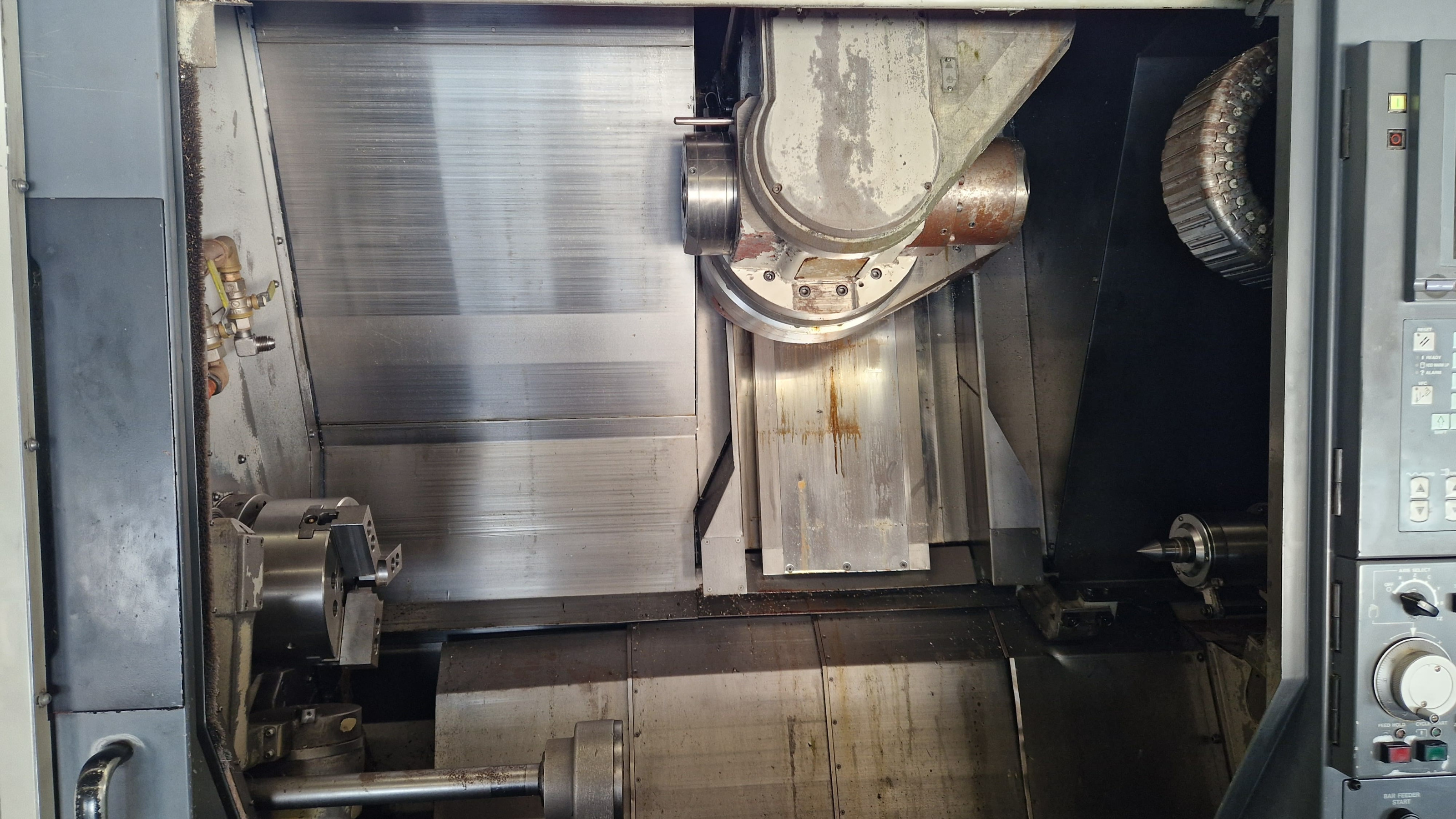

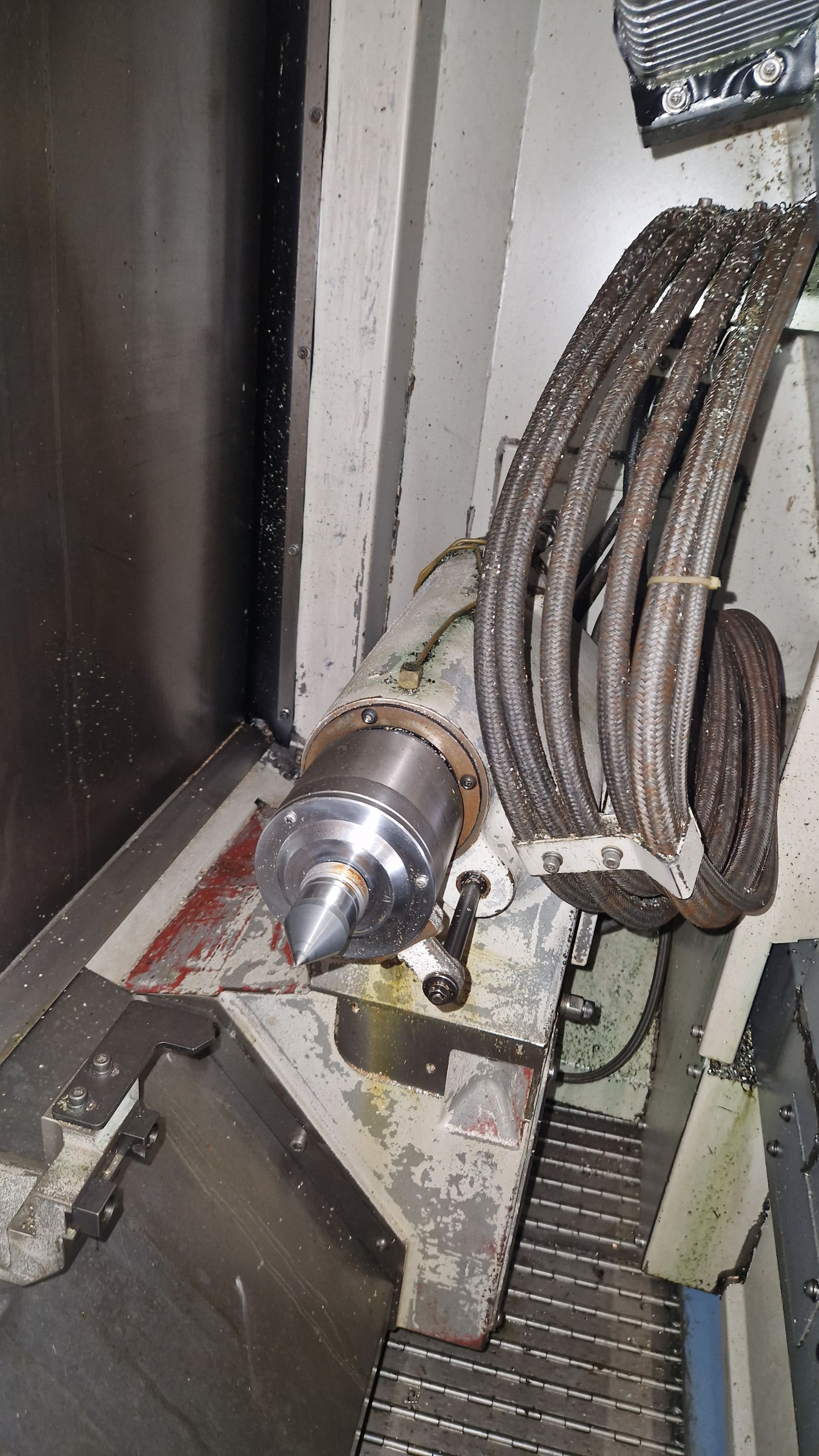

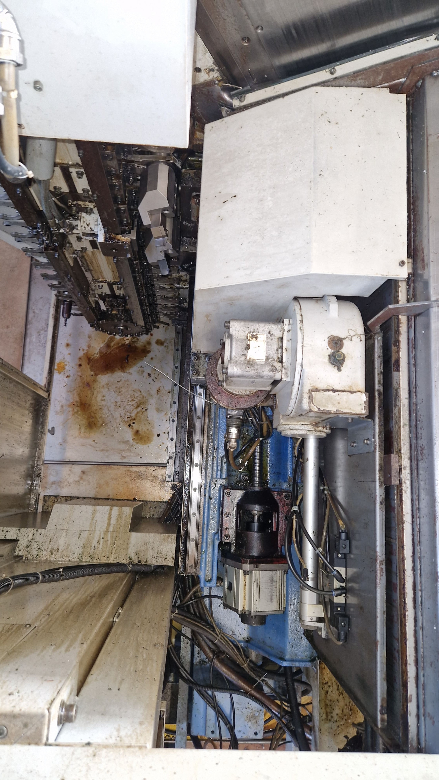

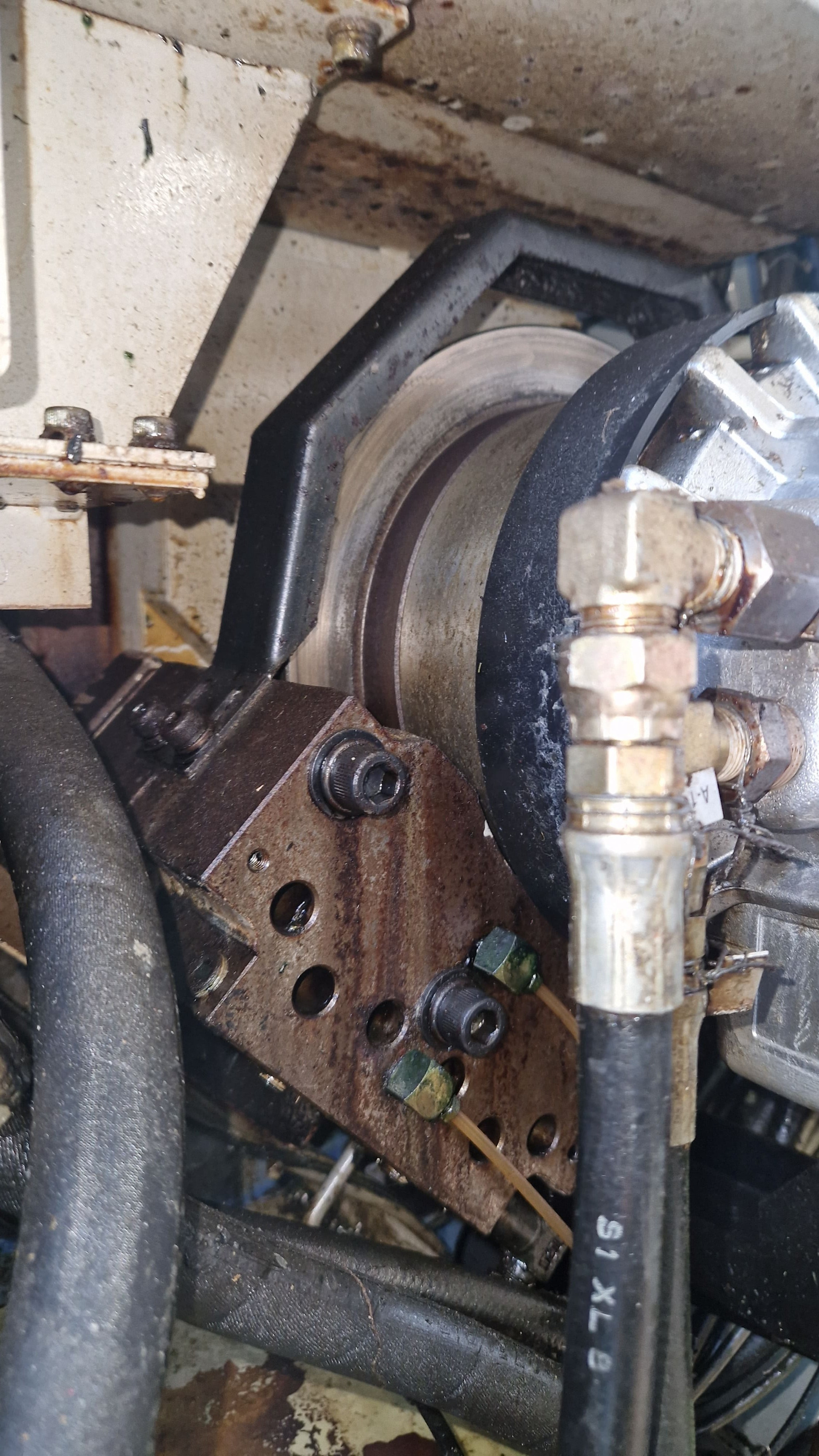

03 May 2025 06:41 - 03 May 2025 10:19 #327584 by jochen91
Hello Folks,
just a quick update: At the Moment I'm in the process of aquerring the machine. The machine was listed in working condition. But sadly it has an error in the B-axis servo amp. The seller is realy cooperative and tries to fix it asap.
In the meantime i was thinking about to major "hurdles":
1.) Milling spindle orientation
The machine can hydraulically lock the spindle via hirth coupling in 12 positions. This is of course quite importent for tuning tools and broaching tools. Of course i want to implement this feature in LCNC as well. The first solution that came to my mind is using a custom M-Code that executes a custom HAL Component.  The M-Code posting needs than to be implemented into the post processor after every tool change.
But i would prefer the solution by Mazak. They used iirc a custom tool change command and added the desired spindle angle.
It looked something like this: T01XX while XX equals the desired spindle orientation.
2. Turning spindle + C-axis + clamping I saw this is done via the PP so never mind.
There are plenty of examples on how to implement a lathe spindle + C-Axis in LCNC. What worries me is the spindle locking.
There is the INDEXER available, but this works only exclusivly with G0 moves. As soon as the G-code contains G0 CX and i.e. G1 CX FXX it does not work anymore. How can i solve this problem? My idea was to somehow use motmod.
C-axis can be locked if the next line of G-code does not move the axis and unlocked if the next line of code does. The question is how.
The bridge the waiting time for new posts on this topic here are some pictures:
