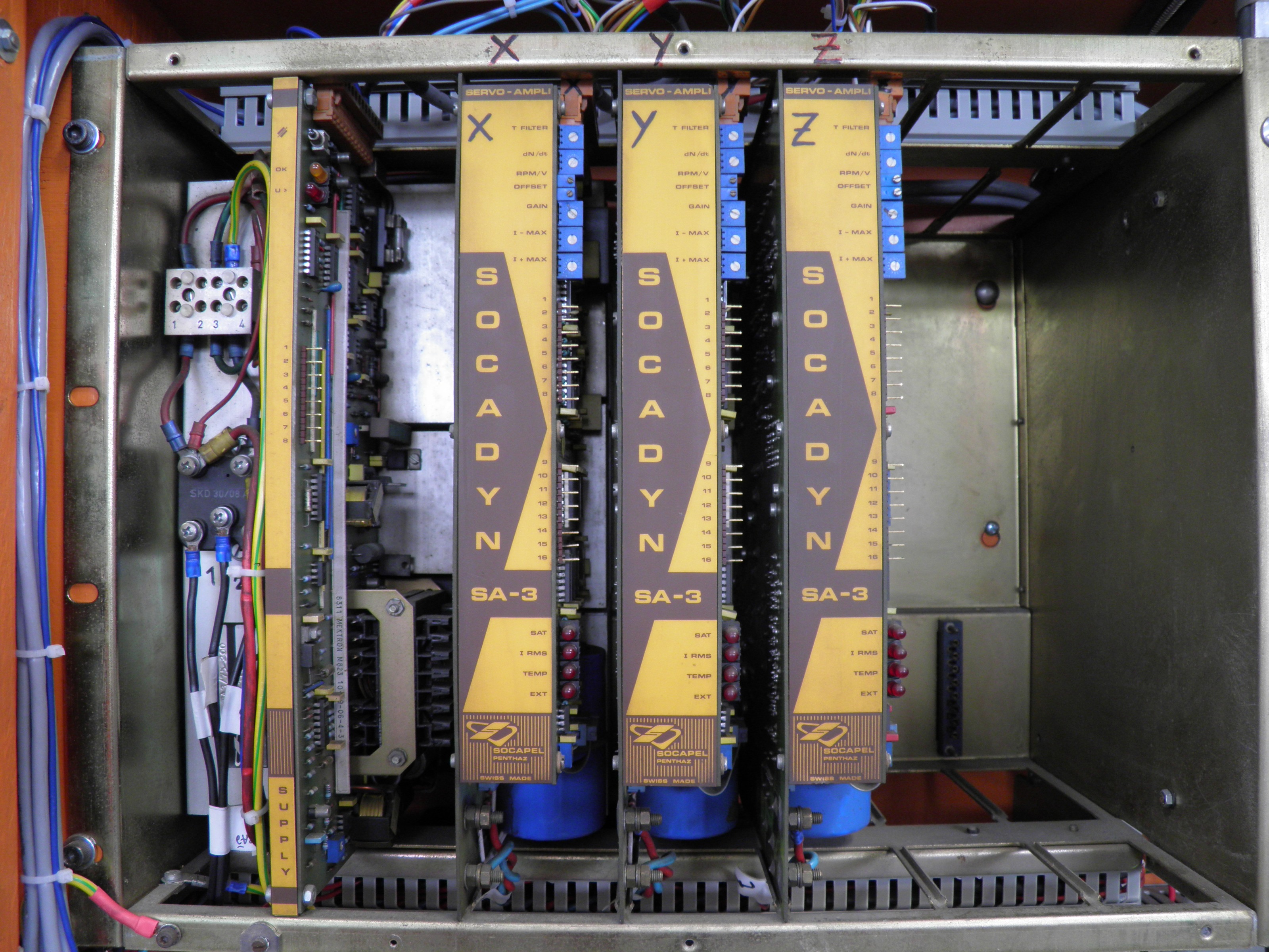

To retrofit a SCaublin 32 CNC milling machine, it's a good idea to have the manuals, right?
In manuals I am a bit limited, I only have the diagram or schematic of the electrical part, and the Spindle drive manual.
About the axis drives I have nothing.
Without this manual is it possible to retrofi?
Axle drives are Socapel Socadyn SA3
I will be grateful for your help.

Alexandre, it would be best to start a new topic and upload more pictures of the machine and cabinet, diagrams you have, and yank on of the drives out and check if there is silk screening on the board regarding pinouts.
