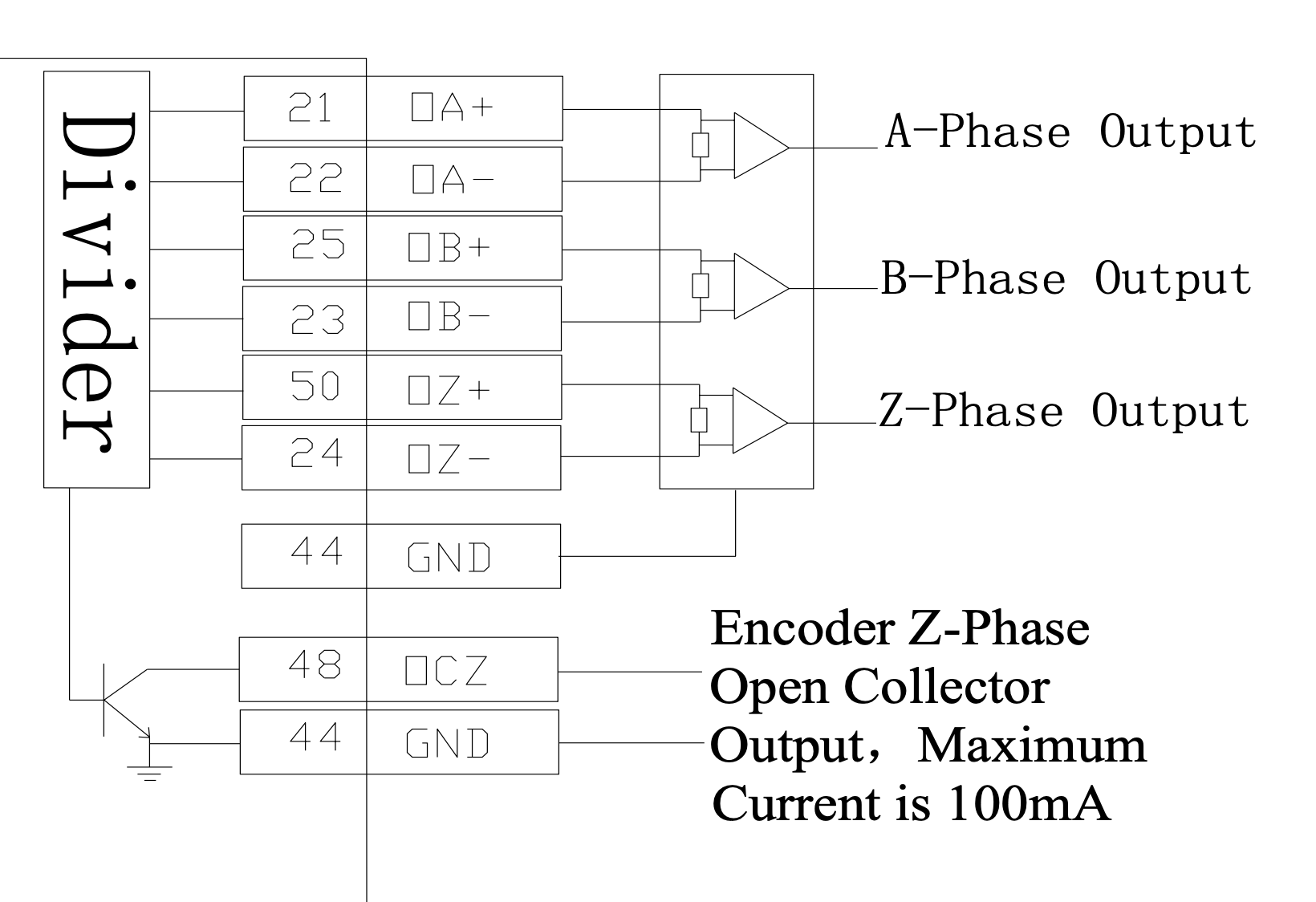

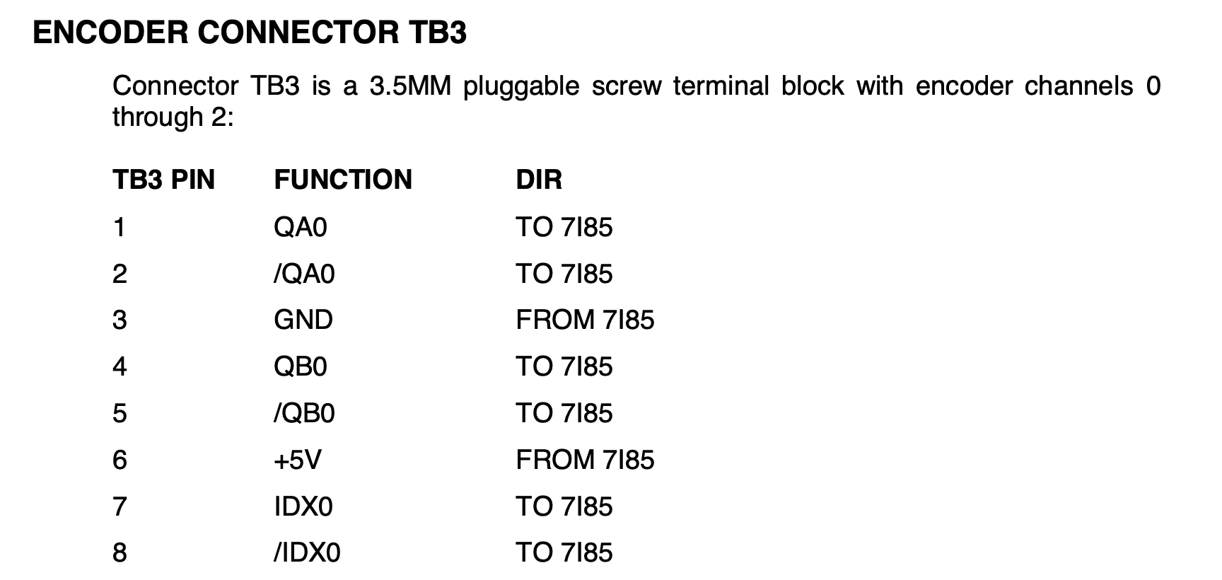

I have a question with respect to wiring pass through encoder signals to the 7i85.
The JMC driver outputs the differential signals from the motor encoder :
... and I would like to pass that signal through to LinuxCNC on the 7i85:
I am a little uncertain of the GND signal on the JMC driver. As drawn that looks like it is just the cable shield earth. I take it the 7i85 needs the TB3-3 GND reference signal for the encoder right? I cant upload the full manual here, as it exceeds the forum limit.

31 Jul 2022 18:37 #248742
Replied by tommylight on topic Schaublin 125-CNC retrofit.
No GND, just use + and - for each signal.
7i85 does have differential inputs, right?
Differential signal do not need GND, at least i never needed it.

31 Jul 2022 20:22 #248753
by spumco
Replied by spumco on topic Schaublin 125-CNC retrofit.
Yep. Six conductors, plus a shield.
I believe the OCZ/GND connection is a bit of a red herring in your case. Pretty sure that's for a single-ended output; probably used for a home-to-index feature for a controller that can't take differential inputs.
On the other hand, I'm mildly curious what an electric angel is... Incremental encoder Z pulse electric
angel
angel

01 Aug 2022 05:55 #248771
by RotarySMP
Replied by RotarySMP on topic Schaublin 125-CNC retrofit.
Thanks guys. I wasnt sure if the differential signals were each referenced to gnd or formed a circuit.
